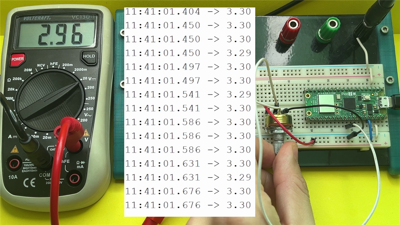

Miloš starts the hands-on electronics with the most straightforward sensor in the guide: the potentiometer. It is a good teaching choice because it makes an analogue signal tangible. Power the potentiometer from 3.3V, read the middle pin, and the measured voltage changes as the shaft turns. He demonstrates the voltage on a multimeter and then reads the same change with a microcontroller, showing how the physical movement becomes data in code.
“You have two functions that you always need to have… the setup function and the loop function.”
That bench exercise also lets him introduce a few fundamentals that are easy to skip over too quickly. The setup runs once at power-up, while the loop runs continuously afterwards. He also shows how a 12-bit analogue-to-digital conversion maps the voltage range into values from 0 to 4095, then converts the reading back into an actual voltage so the serial output and multimeter can be compared directly.
“They actually use a potentiometer just like this to measure the angle of the output shaft.”
One of the more useful details here is that he links the demo back to real hardware inside a servo. The point is not merely to read a potentiometer on a breadboard; it is to recognise that the same principle appears inside common actuators. That gives the beginner a clear example of how a bench-top lesson connects directly to the mechanics of a robot joint.

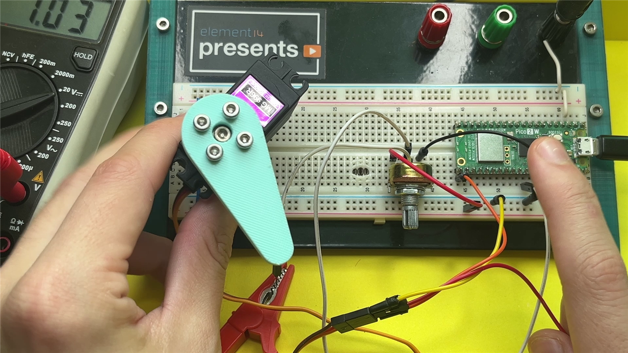

He then moves from sensing to actuation. For the robot arm example, the key device is the hobby servo. This is one of the most approachable actuators in entry-level robotics because much of the complexity is hidden inside the casing.
“A servo motor is a small actuator that is incredibly easy to use, we need to power it up and we need to send it an angle command, the electronics inside do the rest.”
That convenience is worth unpacking, and he does. A hobby servo contains a DC motor, a gear train, a position sensor and control electronics in one package. The user does not need to design a separate drive stage for it. By contrast, the motors on a wheeled robot usually need an external motor driver because the current available from a microcontroller pin is nowhere near enough to drive a DC motor directly. That is one of the most important practical lessons in the guide: a microcontroller can command a motor, but it typically cannot power one by itself.
He also adds more detail than the earlier write-up by briefly showing how the servo is commanded. The control signal is a PWM-style pulse, and in his demonstration he sweeps the pulse width between roughly 800 and 2500 microseconds. That level of detail is useful for readers moving from concept to experiment because it shows that even a simple actuator still relies on timings, signal conventions and software support.

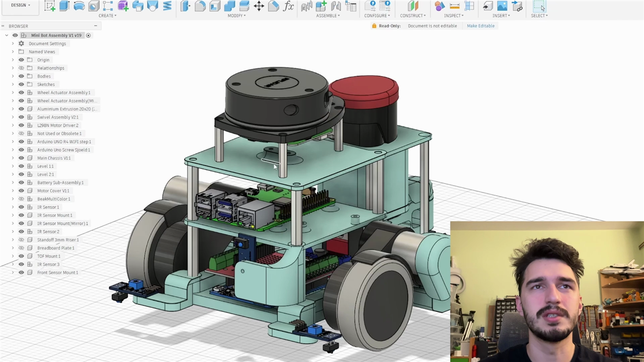

The wheeled robot example expands the picture further. Rather than simply saying that the robot has motors and wheels, Miloš describes it as a differential, or tank-drive, platform. Two driven wheels provide motion, and steering happens by varying the speed between the left and right sides. That introduces a control concept that appears constantly in beginner mobile robotics, from small educational platforms right through to more capable rovers.
He also notes that the drive motors can include encoders, which act as sensors for rotational position and speed. The guide does not dwell on encoder theory yet, but the mention is valuable because it shows that even a simple wheeled robot is not just a pair of motors on a frame. Once encoders are in the system, the robot has the feedback it needs for distance measurement, speed regulation and more precise movement later on.

He demonstrates the concept by wiring the potentiometer to command the servo directly. Turning the knob changes the measured voltage, the microcontroller processes that value, and the servo moves to a corresponding angle. It is a stripped-back feedback example, but it shows the whole chain in a form a beginner can reproduce on a breadboard. He also points out that the same principle scales well beyond this simple demo. A drone stabilising itself from IMU data, a balanced robot correcting its posture, or a robot arm holding a joint position all work from the same basic loop of measurement, calculation and action.
He then adds a useful extension: several potentiometers arranged like a crude teaching arm could be used to create a master device for controlling a servo-driven robot arm. That takes the same loop and stretches it into a recognisable robotics application.

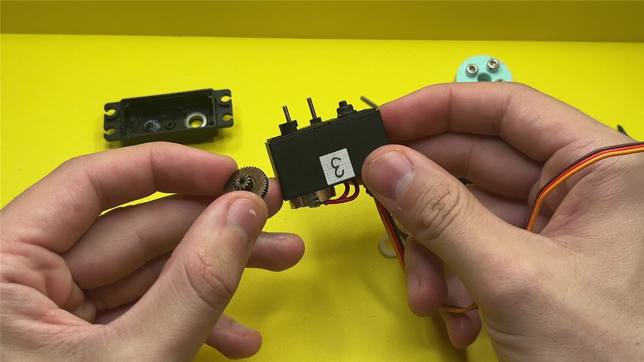

The standout topic here is the gearbox. He points out that small electric motors are usually happiest spinning quickly, but that is not always what a robot needs. A robot joint often benefits from slower motion and more torque rather than raw speed. A gearbox trades one for the other, reducing output speed while raising available torque.
“Most of the actuators that you’re gonna use in robotics are gonna have some kind of gearbox.”
To make that tangible, he opens up a hobby servo. Once the case is off, the beginner can see what would otherwise remain hidden: the small internal motor, the control board, the position sensor and the stack of gears that convert a high-speed motor into a more useful joint actuator.
He also contrasts that arrangement with examples that do not need gearing in the same way. Drone motors, for instance, are usually expected to spin propellers as fast as possible, so direct drive is often the better fit there. That comparison helps the reader understand that gearboxes are not a default requirement in every machine; they are a mechanical choice based on the needs of the application.

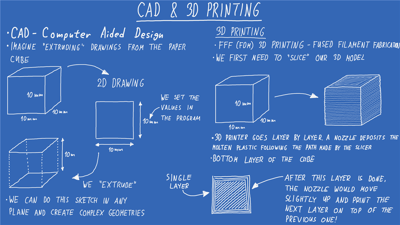

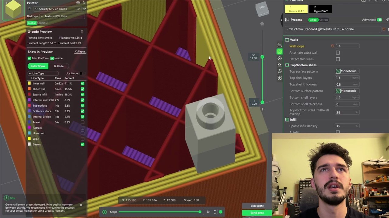

The last major section covers how an idea becomes a physical part. Miloš walks through CAD, starting with the most intuitive possible example: a cube. Draw a square as a 2D sketch, dimension it, then extrude it into a 3D form. It is a simple demonstration, but it gives beginners an immediate way to picture CAD as something more approachable than a specialist black box.
He mentions accessible tools such as Tinkercad, Fusion 360, Onshape and FreeCAD, and keeps the advice practical: the best route in is to experiment. He then follows the process into 3D printing, focusing on fused filament fabrication and the role of a slicer. The slicer takes the CAD model and turns it into layers and toolpaths for the printer, which is exactly the sort of missing step that often confuses newcomers. By explaining layer lines, infill and wall settings, he gives the reader just enough to understand why a printed part looks and behaves the way it does.
There is a welcome balance in this section as well. He is clearly comfortable designing and printing parts, but he does not make the process sound mandatory. The robots can be built in a rougher, low-cost form with cardboard and hot glue, while CAD and printing offer a cleaner route for those ready to take the next step.
