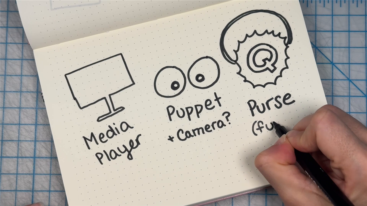

Instead of making a general-purpose laptop, Natasha selected a short list of jobs: play locally stored audio and video, provide a monitor for camera-based puppet practice, remain portable and still function as a hand-operated puppet. That narrow brief kept the build coherent even when the component layout changed repeatedly.

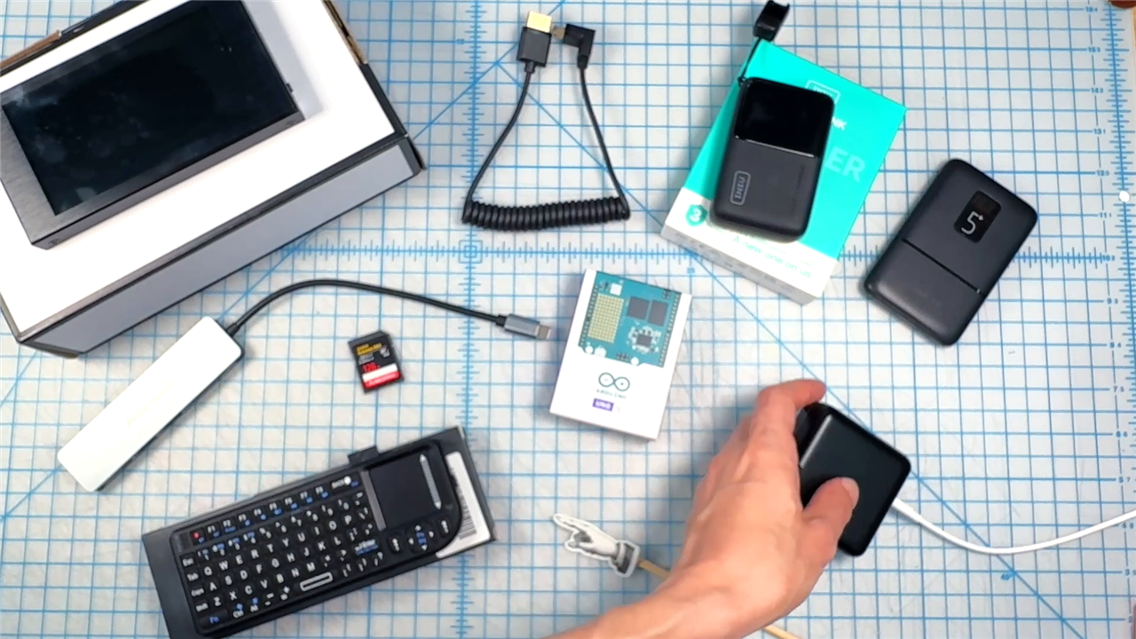

The computing core is the Arduino UNO Q. It combines a Qualcomm Dragonwing QRB2210 application processor, capable of running Debian Linux, with an STM32U585 real-time microcontroller. The arrangement gives the board both a desktop-style Linux environment and Arduino-compatible real-time I/O. Natasha used the Linux side for this build, but the microcontroller leaves scope for later sensors, actuators or interface controls.
The UNO Q is available in 2 GB RAM/16 GB eMMC and 4 GB RAM/32 GB eMMC versions. For standalone computer use with a graphical desktop, Arduino recommends the 4 GB version. The project pairs it with a five-inch HDMI display, selected specifically to fit the puppet’s mouth and provide a 3.5 mm headphone output. HDMI carries audio and video together, avoiding a separate audio interface. A compact wireless keyboard with an integrated trackpad supplies the controls, while removable media holds the hand-picked film and music library.
Because the board has one USB-C connection for power and peripherals, a powered USB-C hub becomes the centre of the system. The selected hub supplies HDMI, USB-A connections and an SD or microSD card reader, while accepting USB Power Delivery. This is not just a convenience item: its port placement and ability to pass adequate power determine whether the complete computer can operate reliably.
“I started with a 5 volt 2.1 amp battery pack for a phone, which did power the project temporarily, but ended up browning out and resetting the board.”
The replacement pack could provide the recommended 5 V at 3 A. Builders should check the output mode of a prospective battery, not simply its capacity in mAh. A high-capacity pack may still have an unsuitable output limit, and some packs shut down at low loads or negotiate USB-PD modes differently. Bench-test the UNO Q, hub, display, keyboard receiver and webcam together before committing to the enclosure. For setup on mains power, we can use Arduino’s 45 W USB-C supply, and 60 W USB-C cable.

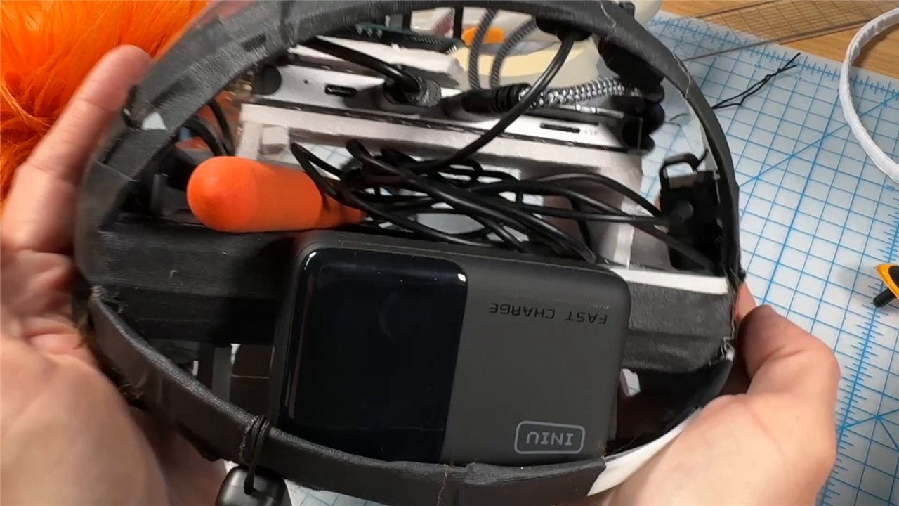

A two-part plastic chocolate mould became the head shell. It was light enough to carry and strong enough to hold its shape, while leaving room for both the electronics and a hand. Heavy-duty foam display board formed the two inner mouth plates. Cut-outs allow the display and keyboard to sit flush, and a second foam-board layer adds stiffness around the openings.
The mechanical layout had to leave a clear hand path behind the display and below the electronics platform. Natasha trimmed the lower hemisphere to make a flat base, then removed part of the circular mouth plates to form the rear hinge. Gaffer tape provides a flexible hinge, while a band of corset boning restores stiffness after material was removed from the upper shell. This lets the mouth rest securely in its open, laptop-like position.
“Trying to find the perfect balance to leave enough room for my hand to fit in the back and the display and keyboard to fit inside the mouth like a clamshell computer.”
The UNO Q was first fixed to a separate piece of foam board rather than glued directly. This protects the PCB, provides a little thermal clearance and makes the subassembly easier to mount. Zip ties secure connections while retaining future access. These small choices turn a craft enclosure into a serviceable electronics chassis.
Cable routing was the real build challenge
The assembly uses no exotic circuit, but its interconnects required repeated prototyping. Standard moulded plugs consume too much space and often point in the wrong direction. A thin HDMI ribbon cable solved the tightest route, but HDMI connector size and cable orientation both needed checking before purchase.
“There are three sizes of HDMI, and when you’re routing it 90 degrees, it also has an up or down, so I had to be extra careful to order the right one.”
The headphone socket was brought to the inside of the mouth with a 90-degree 3.5 mm extension. Although the keyboard is wireless in use, it still needs charging, so an angled USB adapter lines its charging port up with a discreet access hole through the fur. This is a useful enclosure-design lesson: draw every plug with its cable bend radius, not merely the socket outline. Include access for charging, card removal and maintenance before covering the structure.

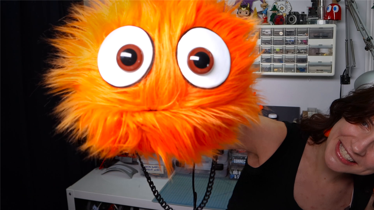

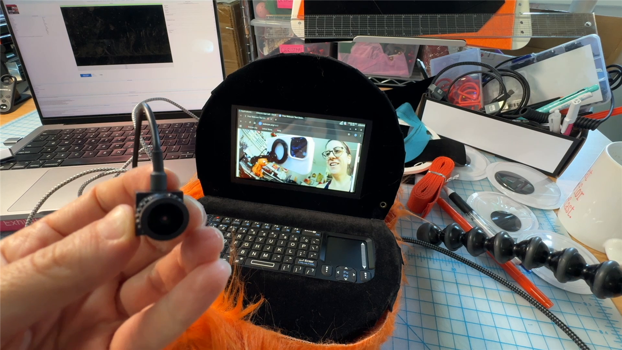

A tiny USB webcam turned the computer into a portable puppetry monitor. Mounted on a telescopic rod through a hidden opening in the head, the camera can frame the puppet while its operator remains below view. A USB splitter adds the extra connection. An online camera test was useful during development, but offline operation was essential, so Natasha installed Cheese, a simple Linux webcam viewer and recorder.
The result is a self-contained practice setup: extend the camera, open the mouth, monitor the camera feed on the built-in display, then fold everything back into the head. An element14 Community post on getting started with Arduino UNO Q also discusses USB webcam use and the practical need for a USB-C hub.

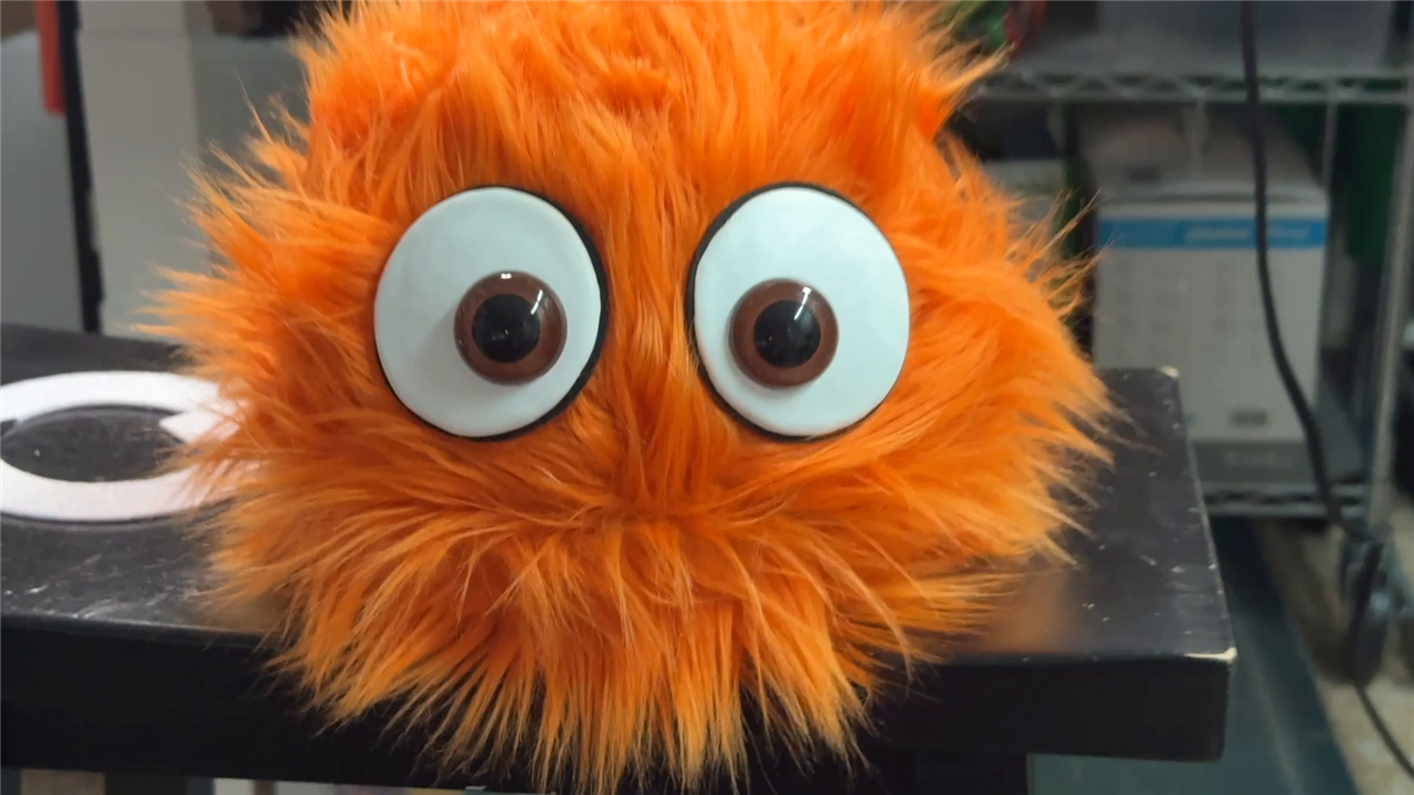

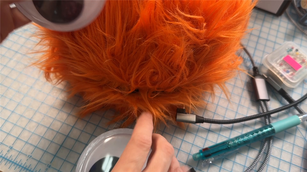

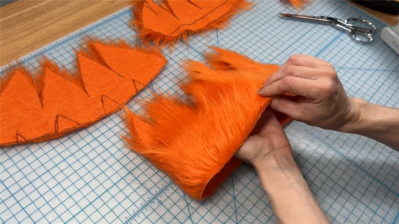

To create the outer skin, Natasha wrapped the assembled shell in plastic film and tape, marked seam lines, then transferred the resulting pattern pieces to orange faux fur. A double zip provides both a hand opening and a bag closure. Felt strips along the zip reduce the chance of long fibres catching in the teeth, and D-rings provide secure points for the shoulder strap.
The eyes were formed from oversized googly-eye domes, sanded and finished with paint mixed with matt Mod Podge. Moving pupils driven by servos were considered because the UNO Q also provides a microcontroller, but the motion did not suit the visual style. The static version was the more deliberate design.
