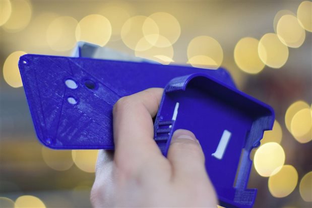

One mans trash is a makers treasure! Clem found a super8 camera in the trash, and soon realised that the original analogue films and the processing is crazy expensive nowadays. So he creates a drop in replacement for the film cartridge that turns the super8 camera into a digital one! But that is easier said than done!

Couldn't you just remove the lens of the picam and put it directly in place of the film?
No.Tried that in multiple version, but no the focal distance and the sensor width are extremely different, you can only get a blotch of light by doing that+ you can't even get to the exact same plane because of parts that would hold the original film and should not be damaged.
How did you get it to focus then?
Extended the picam lens to near maximum and found a position that allowed me to get alignment with the shutter by trial and error, focused to UE and pushed back and forth until the image was mostly sharp. this ended up being a position multiple centimetres back which resulted in the need to extend the case.
Why the big case?
See above + I damaged multiple flat flex cables when fitting everything in the tiny version ,with only a day left until deadline i had to make sure that won't happen again + easier to install the buttons.
Will you do another version?
I plan to but It may be  a longer term project with dedicated self developed hardware.

    mayermakes over 7 years ago in reply to davedarko +2
    yes, but you need it to compensate the focal distance and sensor widht inside the camera. without the original lens you can´t see anything. it is extended to nearly it´s maximum.
