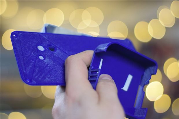

One mans trash is a makers treasure! Clem found a super8 camera in the trash, and soon realised that the original analogue films and the processing is crazy expensive nowadays. So he creates a drop in replacement for the film cartridge that turns the super8 camera into a digital one! But that is easier said than done!

Couldn't you just remove the lens of the picam and put it directly in place of the film?
No.Tried that in multiple version, but no the focal distance and the sensor width are extremely different, you can only get a blotch of light by doing that+ you can't even get to the exact same plane because of parts that would hold the original film and should not be damaged.
How did you get it to focus then?
Extended the picam lens to near maximum and found a position that allowed me to get alignment with the shutter by trial and error, focused to UE and pushed back and forth until the image was mostly sharp. this ended up being a position multiple centimetres back which resulted in the need to extend the case.
Why the big case?
See above + I damaged multiple flat flex cables when fitting everything in the tiny version ,with only a day left until deadline i had to make sure that won't happen again + easier to install the buttons.

    Very good episode Clem.
    I have considered doing something similar.
    I think you are right about not using the RPi camera without its lens. The normal footprint for the lens is 8-mm and your RPi camera is much smaller than that.
    What your doing now is called eyepiece projection. You will need to position the RPi camera very precisely so that the focal point of the RPi lens is at the focal point of the 8-mm camera lens.
    To do this well, you will need to set up the 8-mm camera with a well illuminated image about ten or so feet away. It is not a full far field, but it might be good enough if you have focus control on the 8-mm lens.
    Then you adjust the position of the RPi camera until the image is in focus. Then run through the zoom range of the 8-mm lens to see how well the image stays in focus.
    When you are happy with it, lock it down.
    It will never be a great camera, but it will be a one of a kind retro looking digital camera.

    You are desribing my procedure in the best way anyone could phrase it. it was a huge feat of trial and error to get close to the right combination of "inner lens" and Super8 lense.
    The projection idea also came to my mind but I could not pull it off, even shining a studio light directly into the lense did not generate an easy to focus image in the close range,  so I got back to triying out a few combinations until I got something that was recognizable as an image (seen in the video as the direct stream from the pi)

    Hi Clem,
    If you can remove the 8-mm camera lens, you can set it up on an optical bench to get a better measurement as to where the focal point is.
    After that, you can bench test the RPi camera to find its focal point in relation to the other lens.
    The problem is the poor quality of the RPi lens. It really limits your performance. That and the low sensitivity of the sensor.
    Still, it is a good way to repurpose an old camera.
    FYI, if you try to go for an IR camera with this set up, be aware that the focal point will shift, so you will have to refocus the RPi camera using IR light only.

    good idea, but the lens is not detachable from the camera
