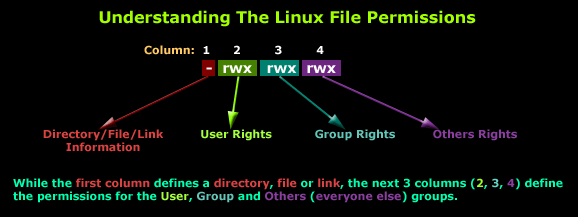

Felix discusses how file permissions work with Linux. He covers what they mean, what they’re for, and how to set them. You’ll learn to use command line to create a file and decipher user, group, and others rights. You can then add or remove permissions by CHMOD or by permission bits in octal notation.
File permissions are the most basic form of security control on a Linux based operating system. They are implemented in a manner which can be configured to grant or deny access to files. The permissions can be modified by either the one who owns the file, or the super user.  The instruction to modify the permissions can take numeric arguments or symbolic arguments.
Felix uses a command line example to show you how to see the permissions of a file: Typing “ls” shows you the root directory structure.

For testfile.txt the information to left of the number 1 are the file permissions. The first bit in the file permissions is the file type, the next 3 are the permissions of the owner,  the following three bits are the permissions of the group, and the last three are the permissions of anybody who is either not in the group or not the owner.  The last bit is a single character that specifies alternate access methods.image
For instance, if you see "drwxr" it means that the file type is director, the r means that the owner can read the directory, the w means the owner can write to the directory,  and x means the owner can execute the directory (since it's a directory it doesn't really get executed). The next 3 bits are the group rights. For testfile.txt, "r--" means that the group can read this but cannot write or execute.

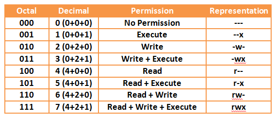

There are two ways to modify the file permissions.  They can either be done through numeric method or via a character method. With the character method, you would change the file permissions by sending the instruction chmod (change modify).  Felix suggests expanding the help anytime you have an instruction. After, using the  command "--help" Felix decides to give execution permissions to the user for the file by typing in the following command:

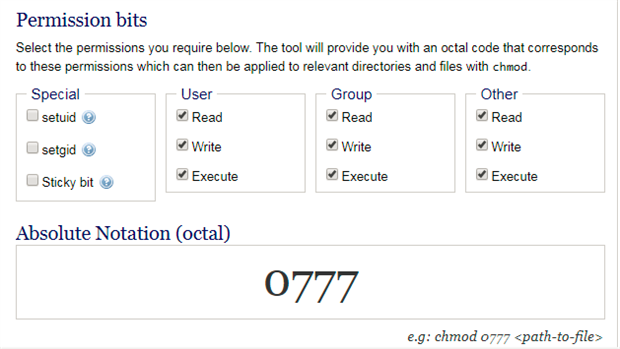

This is covers adding and removing permissions using the character method.  To change permissions via the numeric method you can head over to  Unix Permissions and Lookup . Select your permissions bits. We're focusing on user, group, and others.If you want to have read write execute for user group and others you would select those permissions on the page.image
sergeant@raspberrypi: ~/test $ chmod 777 testfile.txt
sergeant@raspberrypi: ~/test $ ls -l testfile.txt
-rwxrwxrwx 1 sergeant sergeant 0 Aug 30 9:46 testfile.txt

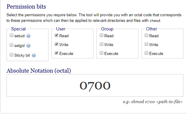

Trying again with a different numeric value changes the file permissions:
sergeant@raspberrypi: ~/test $ chmod 700 testfile.txt
-rwx------ 1 sergeant sergeant 0 Aug 30 9:46 testfile.txt
