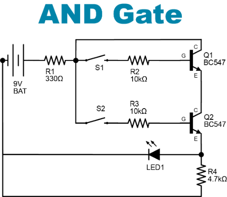

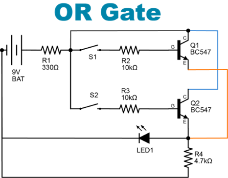

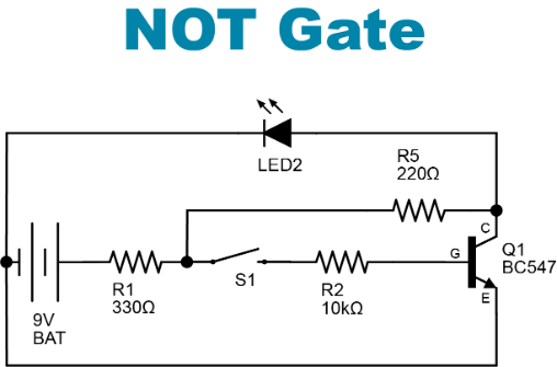

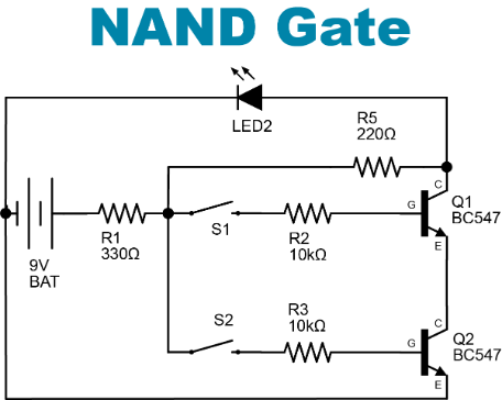

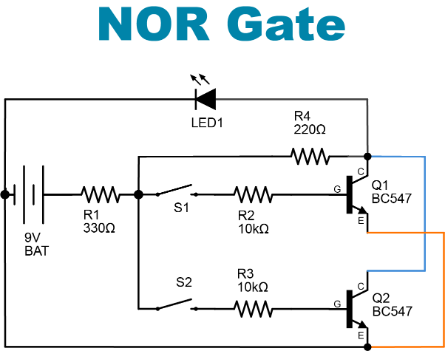

In the previous lesson, Karen explained the logic behind AND, NAND, OR, NOR, NOT, XOR, and XNOR logic gates. In that episode, we also learned that logic gates are typically contained in IC chips, with multiple gates within each chip. For this episode’s project, Karen has decided to throw out the ICs, and instead, use transistors to create each logic gate, further demonstrating how the logic of each gate type works. Follow along to continue the journey of understanding logic gates through the use of transistors. Solder along and you’ll end up with a tidy little project contained within a couple of Altoid tins! In the end, Karen dares you to try your hand at creating the more complicated XOR and XNOR gates out of transistors. Are you up to the challenge?

    Just ran across this page.  What function does R4 (4.7K) have in the AND and OR gates?  Seems to just parallel
    the LED.

    Really great material. I really liked the modular design. So much so that I decided to use the idea to make an SR Latch. - Using 2 of the NOR gates.  Just be sure to insert second NOR gate reversed. i.e. The wiring is reverse for one of the NOR gates.  Otherwise, you will short one out very quickly..... and have to build another one.
    Finally, I decided to use the original base design and create a SR Latch component that plugs into the original base component from this tutorial. It was only slightly more complex than the gates in that you had to find space to solder an LED onto the board (which is pretty small already).  But the two builds together make a great demonstration of building an SR Latch from gates as well as directly from transistors.
