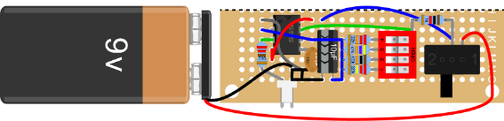

555 Timer Project | Flashing LED Headband
The Learning Circuit | element14 presents |  Project Videos
555 timers are one of the most popular and versatile ICs on the market. In the previous lesson, we learned how 555 timers get used in circuits. There are three main types of circuits in which they are used, monostable, bistable, and astable. Astable circuits are likely the most common use for 555 timers. In this episode, Karen shows how to create an astable circuit using a 555 timer. Follow along as she uses resistors and capacitors to create an RC circuit to affect the timing of the circuit. Karen’s final circuit uses a 4-position DIP switch to allow for the use of 4 different resistors and therefore 4 speeds to control the flashing of LEDs. While Karen uses this circuit to create flashing lights on a headband and a hat, the uses are endless. Try your hand at making the circuit and use it to make art, on decorations, or create warning lights. Come up with other ideas for how to use this circuit and post them in the comments below!

    davedarko over 6 years ago +1
    Looks like you're selling this wrong; you have four bits for speed setting. Therefore you have 16 Speed settings when you have resistors switched to be parallel, forming another value. I like how it's…

    beacon_dave over 6 years ago +1
    "... Come up with other ideas for how to use this circuit and post them in the comments below! " An option might be to swap the DIP switch for a variable resistor. Depends if the application benefits from…
    I like how it's fading up, sometimes it's great not to whip out a computer and tiny MCU to make an LED blink.
