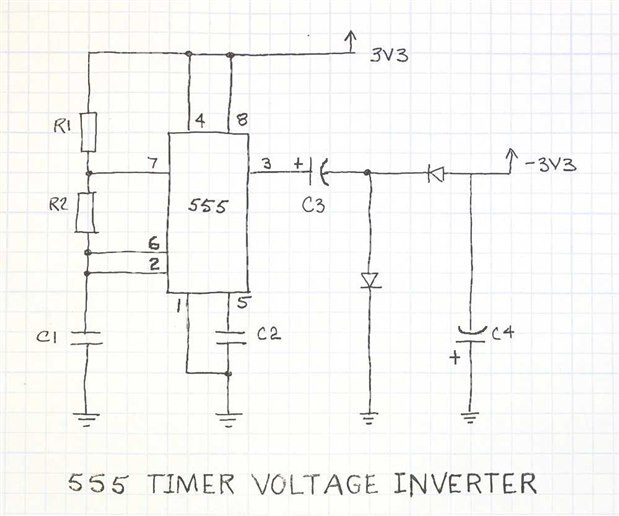

I was brushing up on how charge pumps / voltage inverters work and decided to do a little mini project this evening with a 555 timer (newer version which can operate down to 2V and frequencies to 2MHz) to create my own voltage inverter.  Here is the circuit:
Note:  Although I am not using polarized capacitors they are being indicated on the circuit diagram for clarification should they be used.  I connected it up on a breadboard using parts I had on hand and powered with 3V3 from my bench power supply.
    1. R1 = 1k
    2. R2 = 6.8k
    3. C1 = 100p
    4. C2 = 0.1u
    5. C3,C4 = 2.2u
    6. D1,D2 = IN4001

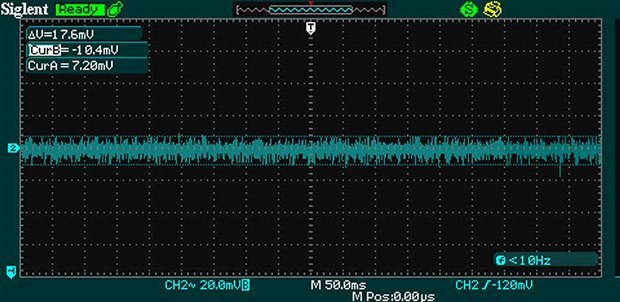

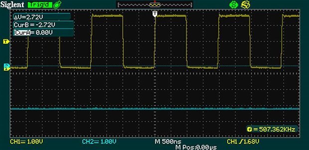

I need to order some Schottky diodes :-).  Lo, and behold, it worked (at least with no load).  Here is the output with the oscilloscope probing pin 3 of the 555 Timer and the -3V3 output.
The 555 timer is providing a  3V3 507KHz square wave with roughly 54% duty as seen on the yellow trace.  The calculated frequency for the 555 Timer output was much higher but I expect my breadboard is adding capacitance and throwing off the calculation.  The blue trace is the negative output measured to be -2.72V.  The DC output with 20 mV divisions is shown in the next oscilloscope screen shot.

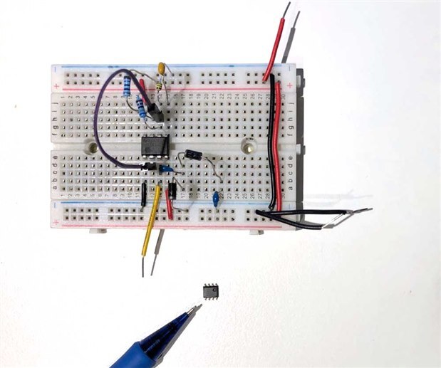

The noise is all within a 20mV band.  And here is what the breadboard looks like:
The pencil is pointing at the LM2662 that I bought for the project.

    The datasheet for the original 555 characterises it for 5 to 15V supply and up to 100kHz. It obviously works for you like this - just saying for anyone else who tries it and maybe doesn't get such good…

    Thanks for simulating this.  Good point on the capabilities of the 555, I should have stated that I am using the TCL555CP which is good down to 2V input and frequencies up to 2MHz.  As you and Rod suspect, this circuit does not work well unless very lightly loaded - at least in the form I currently have it.   I used the IN4001 because I had them on hand.  Here are the results of tests with increasing load.
