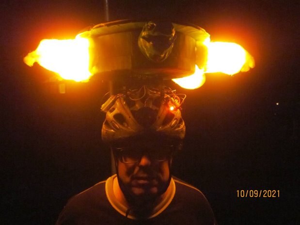

We all know Gamera, kaiju guardian of the universe and protector of children.

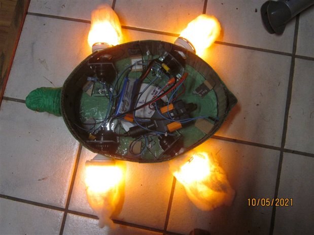

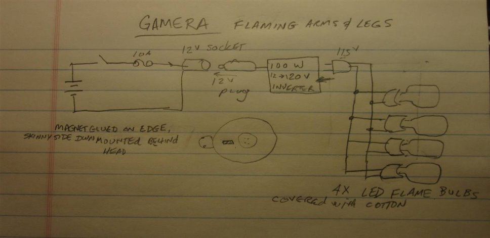

This Halloween inspired hat emulates Gamera flying, spinning on a turntable, radioactive flame jets firing from the shell's arm and leg holes.

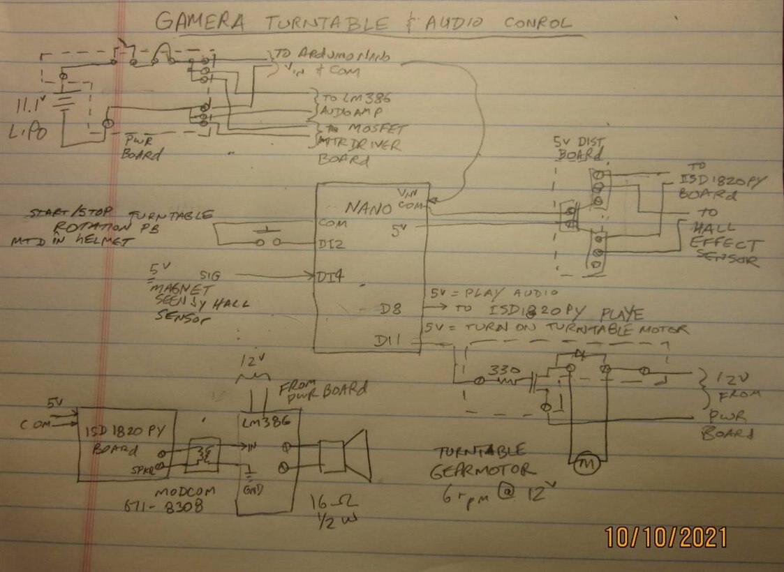

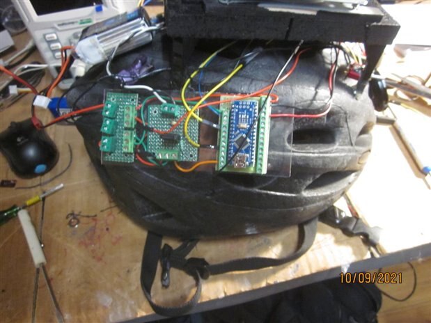

A magnet inside Gamera is read by a Hall effect sensor.
As the magnet passes the sensor, the Arduino is counting rotations.
On a random # of rotations, Gamera will pause spinning with his head facing forward (home position) and roar.
After the roar, it will return to the spinning condition.

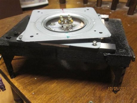

  • Gamera's head is 3D printed.
  • The body sides are cardboard with a foam covering, mounted on a plastic sheet. The sheet has holes in the center for bolting down Gamera's body to the gearmotor coupling.
  • The hat has separate power switches for the turntable, and another for Gamera's flames.
  • The turntable also has a hidden but easily accessible N.O. pushbutton to start/stop turntable rotation.
  • Gamera's roar is saved to a ISD1820PY board. The 1820 has a speaker output, so I used a hi bandwith balun as an audio isolation transformer to the LM386 audio amp since the amplifier module is expecting a DAC input grounded on one side.
  • Since the turntable doesnt reverse direction, rather than connect an H bridge to the Arduino, a single MOSFET is used,
which still can provide PWM speed control if desired.
  • Code and schematics attached

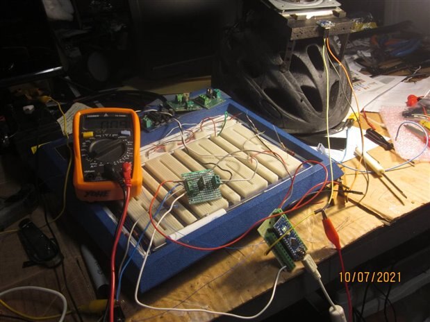

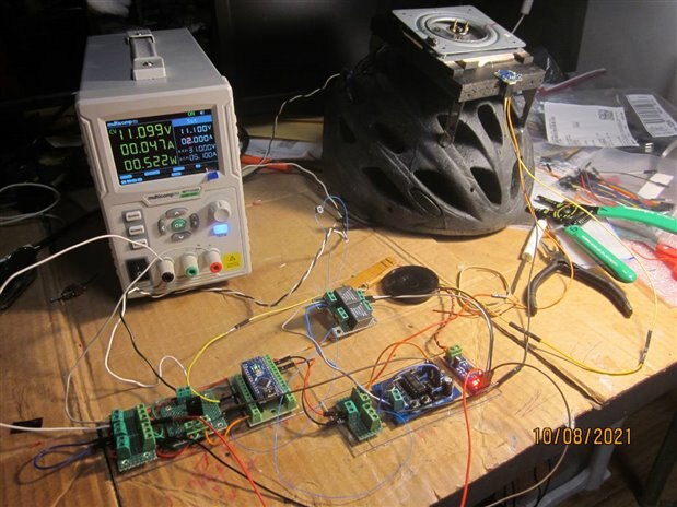

Here are some of the progress pix while building the Gamera hat and testing HW & SW.
I really really appreciated using the nice test equipment won in previous E14 project competitions.
