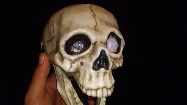

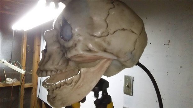

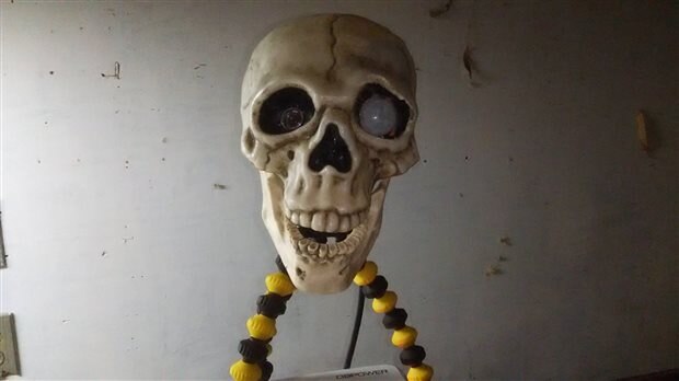

The  Raspberry  Pi  and the Skull.
     One eye is a Raspberry Pi 8MP NoIR Camera and the other is a PIR Motion Detection Sensor

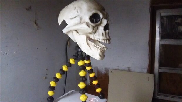

A flexible  camera  tripod  will  serve  as  the  body.
The  PIR  Sensor looks a bit  like  a  dead eye bulging  out  of  the  socket, and that eye is watching  you.

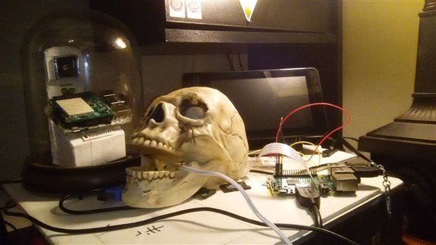

     Not sure which is more creepy, this project or my workshop.

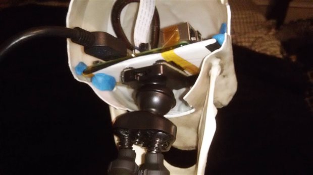

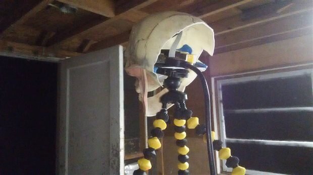

It was necessary  to  surgically  remove  the  back of the  cranium  in order  to  gain  access.

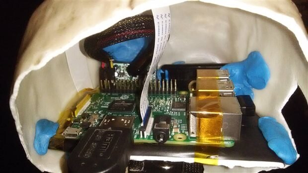

     PIR Sensor Output Pin is connected to GPIO 4. Plenty of GPIO Pins still available. Loctite Fun Tac is blue stuff.
Kapton Tape has been used to secure the Pi 3 to a piece of foam project board, and that foam board has been electrically insulated with black electrical tape on the side.
All contacts on the bottom side of the Pi 3 has been covered by Kapton Tape as well.
Base  of  Cranium  is attached  to  3M Command  and Camera  Tripod  until  a more  suitable  body is built.
