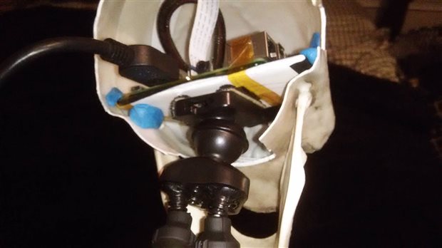

It was necessary to surgically remove the back of the cranium in order to gain access.
PIR Sensor Output Pin is connected to GPIO 4. Plenty of GPIO Pins still available. Loctite Fun Tac is blue stuff.
Kapton Tape has been used to secure the Pi 3 to a piece of foam project board, and that foam board has been electrically insulated with black electrical tape on the side.
All contacts on the bottom side of the Pi 3 has been covered by Kapton Tape as well.
Base of Cranium is attached to 3M Command and Camera Tripod until a more suitable body is built.
