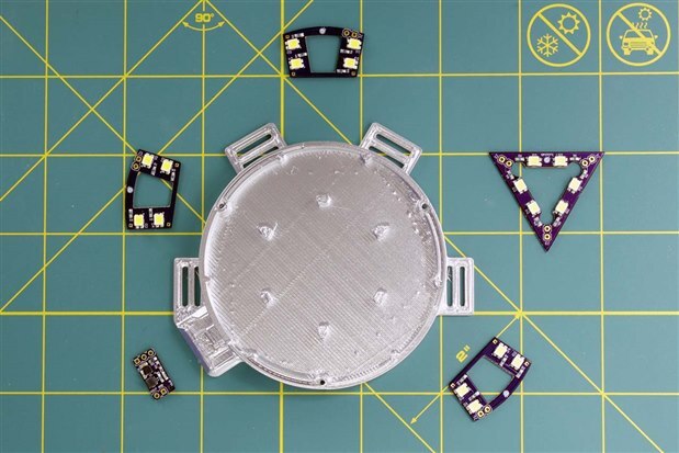

Electronic Components
For this project I wanted to have as much as I could in custom made PCBs. Here are the parts I designed and used

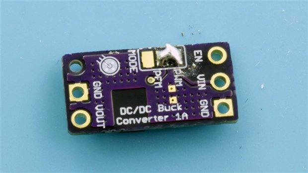

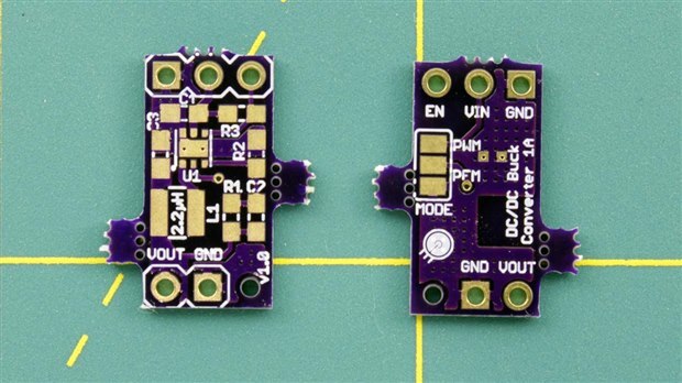

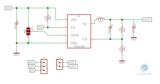

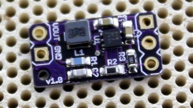

DC-DC converter custom made for wearables

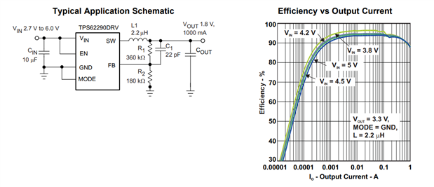

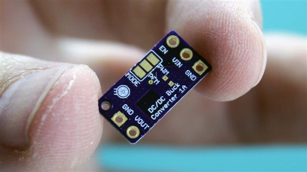

After exploring a dozen of options to power the project, I settled with the Texas Instruments TPS62290. An adjustable, 1A Output Step-down DC-DC converter, very efficient (up to 96%), 2x2mm package (0.079x0.079in) and is adjustable.
BOM
Bill of materials required to produce a 3.35V output:
  • U1: TI TPS62290.2.25MHz 1A Step-Down Converter in 2x2mm SON PackageTI TPS62290.2.25MHz 1A Step-Down Converter in 2x2mm SON Package
  • L1: 2.2µH Inductor
  • C1, C3: 10µF ceramic capacitors 0603[1608]
  • C2: 22pF ceramic capacitor 0603[1608]
  • R1: 825k ohm resistor 0603[1608]
  • R2: 180k ohm resistor 0603[1608]
  • R3: 100k ohm resistor 0603[1608]. Pull up resistor to keep the voltage regulator ON by default.
Features
  • Adjustable by changing the values of R1 and R2
  • Breadboard friendly
  • PCB: 0.30 x 0.60 inch (7.6 x 15.2 mm), 2 layer board, 2 oz copper, 0.8mm thickness
  • Mode selection: jumper pad that allows selecting between Power save mode (PFM) or PWM.
{gallery:width=960,height=540,autoplay=false} DC-DC converter
TPS62290: 0.30 x 0.60 inch (7.6 x 15.2 mm), 2 layer board
TPS62290: 2 layer board, 2 oz copper, 0.8mm thickness
TPS62290 provides two power modes: Not particularly proud of this blob of solder, but it does the job
TPS62290 soldered: Soldered and ready to use
Schematic: Schematic of the TPS62290 wearable version

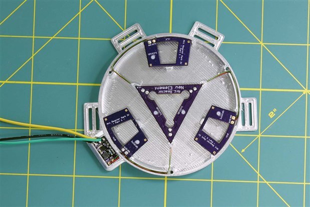

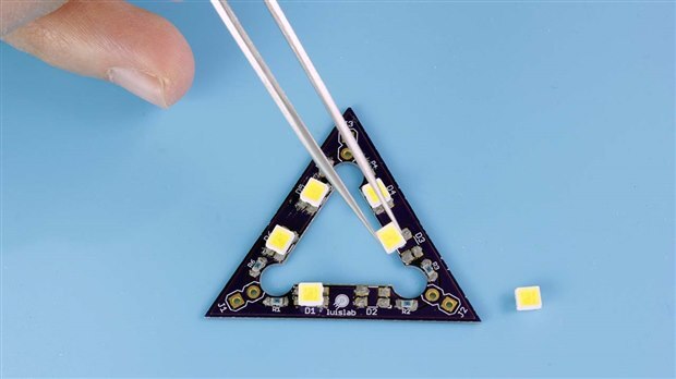

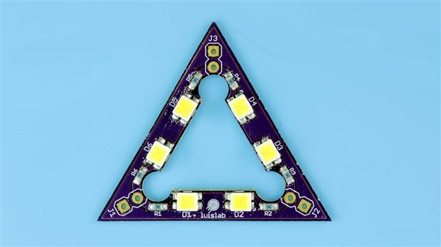

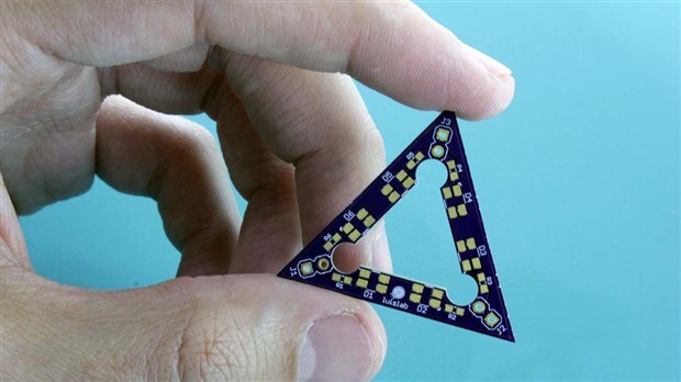

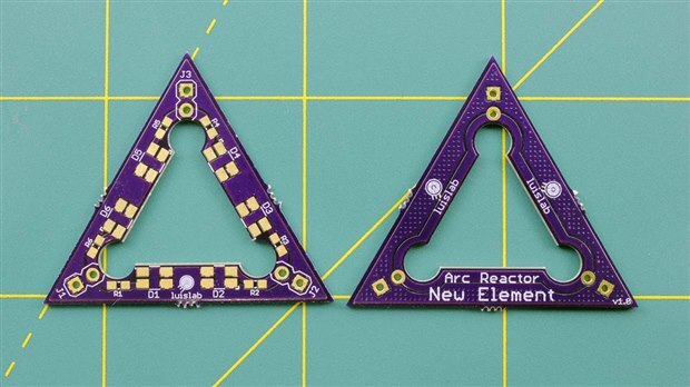

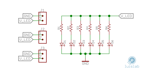

New Element (core of the Arc Reactor)
This is the core of the Arc Reactor and with room for 6 LEDs, will provide illumination to the center.
BOM
{gallery:width=960,height=540,autoplay=false} New Element
New Element: Equilateral triangle, Edge length 1.45 inch (36.89 mm), 2 layer board
New Element PCB: 2 layer board, 2 oz copper, 0.8mm thickness
Soldering: Placing SMD parts
New Element soldered: soldered and ready to use
New Element: Schematics
Other electronic components

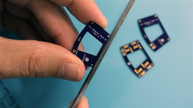

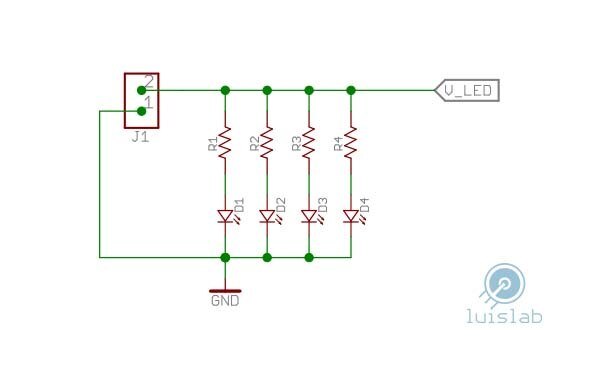

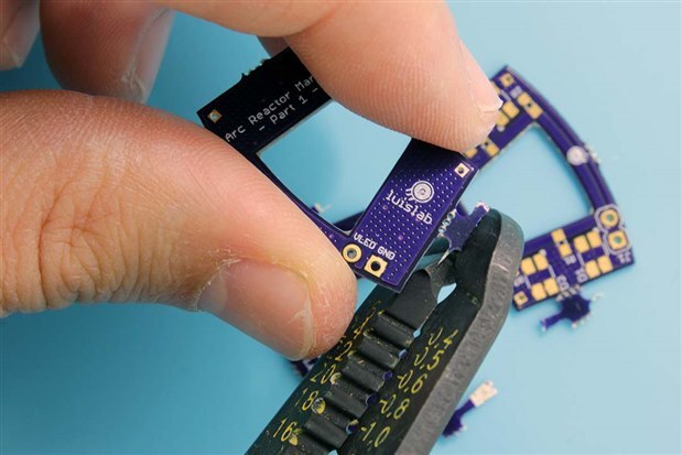

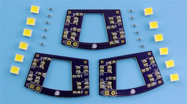

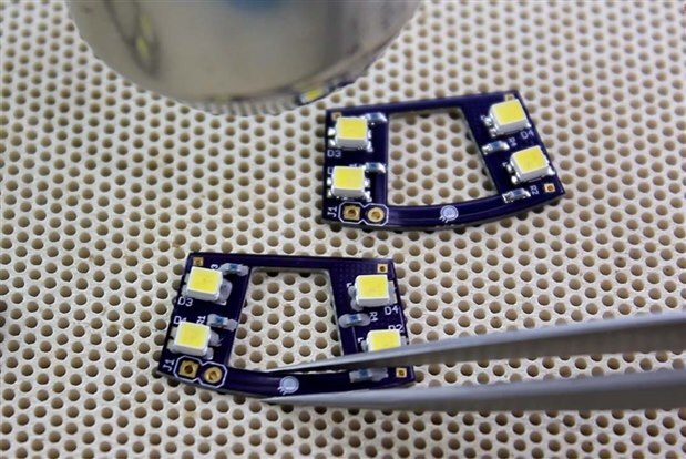

I didn't find a good name for these parts, but with 4 LEDs each, they will provide light on the edge or close to the periphery of the Arc Reactor.
BOM
{gallery:width=960,height=540,autoplay=false} Other electronic components
Detailing process: Removing the excess of material
Detailing process: PCB filing/sanding
Solder paste ready: I know, I know... some look hmm unprofessional... but nothing that a heat-gun and the capillary action can't solve
SMD soldering process: One complete, another ready for some hot-air
Schematics: Part -insert random name- schematics

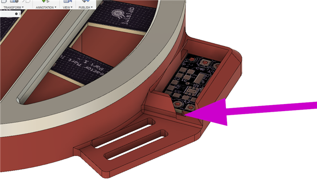

3-D design and printed parts

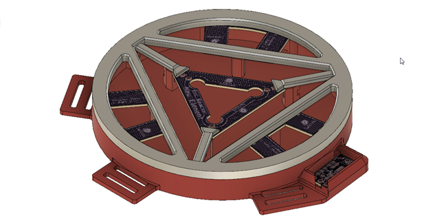

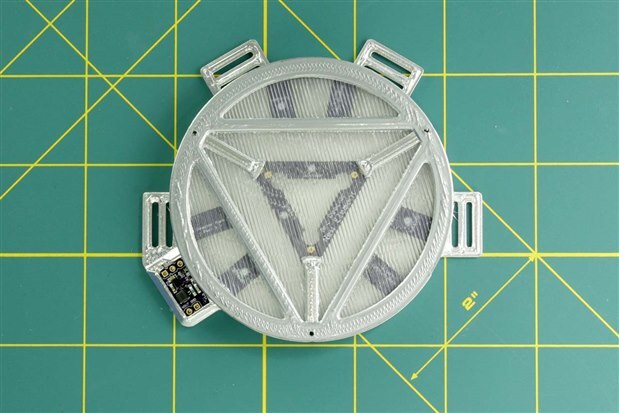

For this project I decided to learn Fusion 360: a powerful tool, very handy for this kind of projects -terrible decision, well at first, considering I decided to learn it merely 4 days before Halloween, but it turned out pretty good, in fact the best decision I made for this project in the end image-.

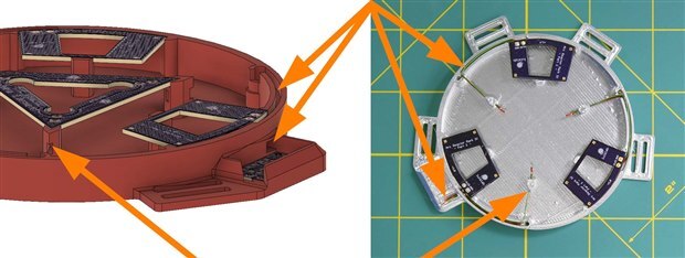

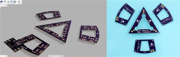

For the ones curious to know, I first started by creating the PCBs within the 3-D model, assigning textures and cutouts to them. This simplified the rest of the design where I could tune every detail around the PCBs physical dimensions and placement. I could re-arrange, move, add/reduce clearances and add some unique features to this model -explained in more details in the pictures-.
{gallery:width=810,height=540,autoplay=false} 3-D design
Arc Reactor complete: Complete design of the Arc Reactor
Virtual PCB parts: Virtual PCBs vs the real PCBs
3D model and PCB: Notch that allows easily removing the voltage regulator with point-tweezers
3D model and PCB: Spaces for wires routing

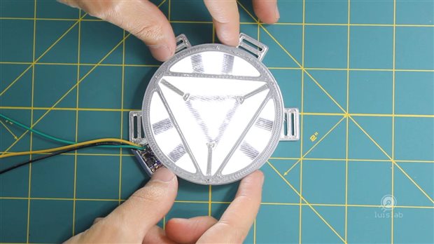

Assembly and Final touches

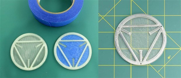

I used Translucent PLA for all the 3-D printed parts which works well at diffusing the light.
{gallery:width=960,height=640,autoplay=false} Assembly and Final touches
Painting process: Cover plate before and after adding masking type, and also the final result
Ready for Assembly: Arc Reactor painted and ready for some electronics soldering
Fitting process: Fitting process before soldering and the final assembly

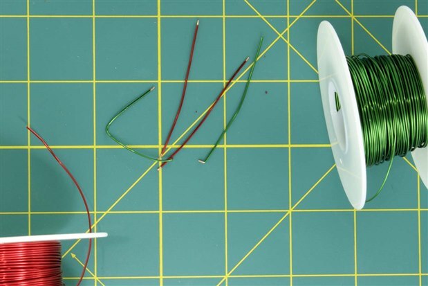

Copper Magnet Wire: 22 AWG Copper magnet. Green will be connected to GND, and RED will be connected to V_LED (Voltage Regulator output)
Electronics: Arc Reactor's electronics ready for testing

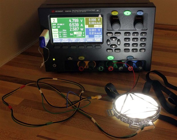

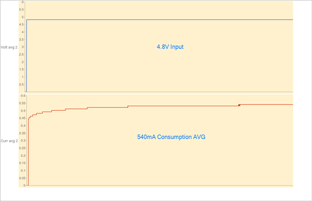

The completed project ended up being small enough, comfortable to wear and with a power consumption of approximately 540mA with a 4.8V input (enough to use it for at least 3h) everything well within my initial expectations.
{gallery:width=960,height=640,autoplay=false} Power consumption
Power consumption: Power consumption monitoring with the Keysight E36313A
Power consumption: Power consumption chart
