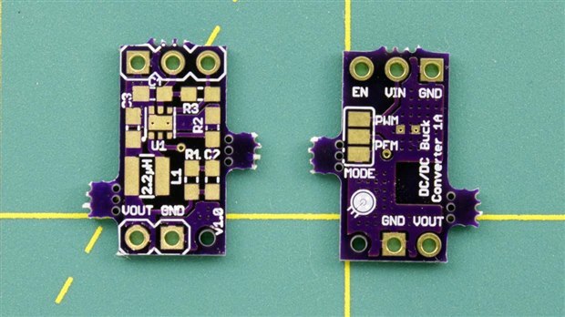

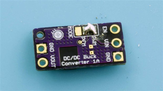

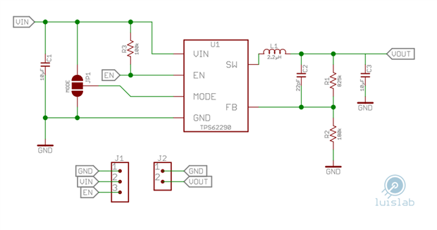

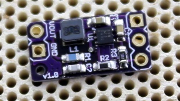

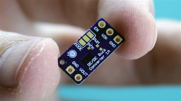

DC-DC converter custom made for wearables

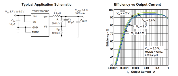

After exploring a dozen of options to power the project, I settled with the Texas Instruments TPS62290. An adjustable, 1A Output Step-down DC-DC converter, very efficient (up to 96%), 2x2mm package (0.079x0.079in) and is adjustable.
BOM
Bill of materials required to produce a 3.35V output:
- U1: TI TPS62290.2.25MHz 1A Step-Down Converter in 2x2mm SON PackageTI TPS62290.2.25MHz 1A Step-Down Converter in 2x2mm SON Package
- L1: 2.2µH Inductor
- C1, C3: 10µF ceramic capacitors 0603[1608]
- C2: 22pF ceramic capacitor 0603[1608]
- R1: 825k ohm resistor 0603[1608]
- R2: 180k ohm resistor 0603[1608]
- R3: 100k ohm resistor 0603[1608]. Pull up resistor to keep the voltage regulator ON by default.
Features
- Adjustable by changing the values of R1 and R2
- Breadboard friendly
- PCB: 0.30 x 0.60 inch (7.6 x 15.2 mm), 2 layer board, 2 oz copper, 0.8mm thickness
- Mode selection: jumper pad that allows selecting between Power save mode (PFM) or PWM.
| {gallery:width=960,height=540,autoplay=false} DC-DC converter |
TPS62290: 0.30 x 0.60 inch (7.6 x 15.2 mm), 2 layer board |
TPS62290: 2 layer board, 2 oz copper, 0.8mm thickness |
TPS62290 provides two power modes: Not particularly proud of this blob of solder, but it does the job |
TPS62290 soldered: Soldered and ready to use |
Schematic: Schematic of the TPS62290 wearable version |

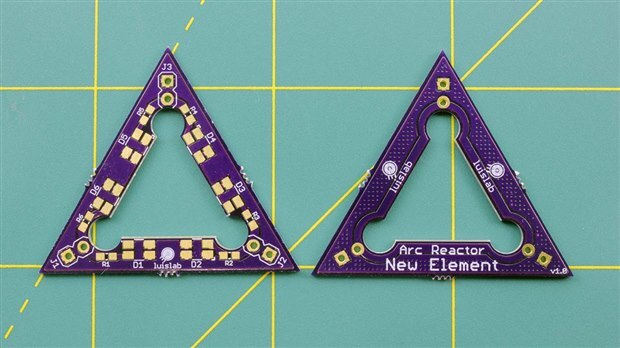

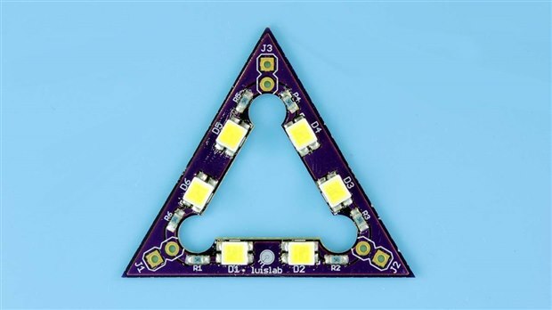

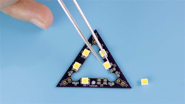

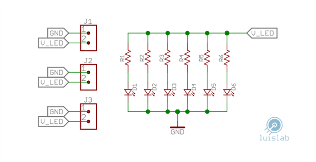

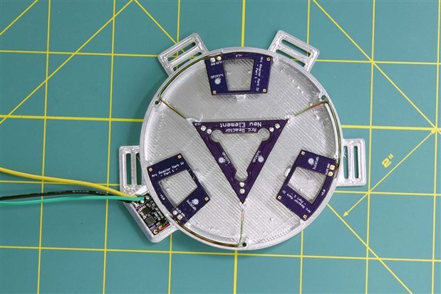

New Element (core of the Arc Reactor)

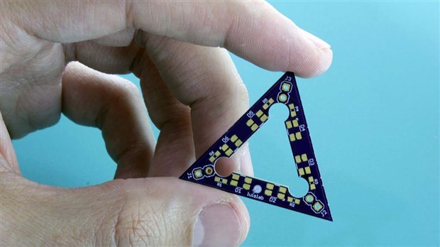

This is the core of the Arc Reactor and with room for 6 LEDs, will provide illumination to the center.
BOM
- 6 x PLCC-4 Cool white LEDPLCC-4 Cool white LED
- 6 x 5.6 ohm resistors 0603[1608]
| {gallery:width=960,height=540,autoplay=false} New Element |
New Element: Equilateral triangle, Edge length 1.45 inch (36.89 mm), 2 layer board |
New Element PCB: 2 layer board, 2 oz copper, 0.8mm thickness |
Soldering: Placing SMD parts |
New Element soldered: soldered and ready to use |
New Element: Schematics |

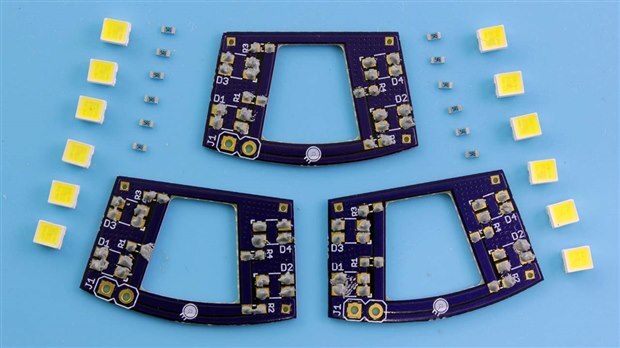

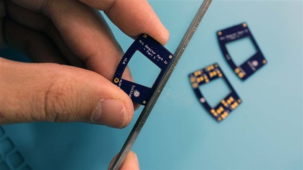

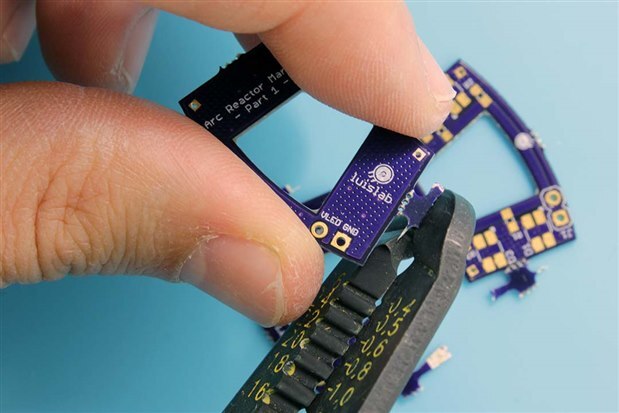

Other electronic components

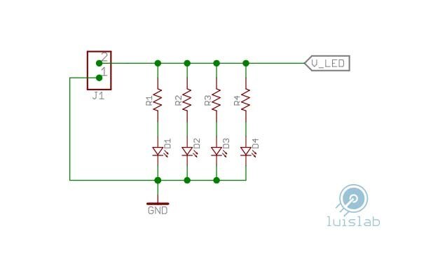

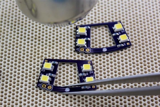

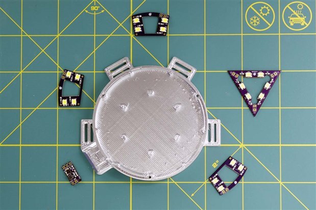

I didn't find a good name for these parts, but with 4 LEDs each, they will provide light on the edge or close to the periphery of the Arc Reactor.
BOM
- 12 x PLCC-4 Cool white LEDPLCC-4 Cool white LED
- 12 x 5.6 ohm resistors 0603[1608]
| {gallery:width=960,height=540,autoplay=false} Other electronic components |
Detailing process: Removing the excess of material |
Detailing process: PCB filing/sanding |
Solder paste ready: I know, I know... some look hmm unprofessional... but nothing that a heat-gun and the capillary action can't solve |
SMD soldering process: One complete, another ready for some hot-air |
Schematics: Part -insert random name- schematics |

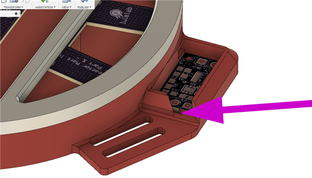

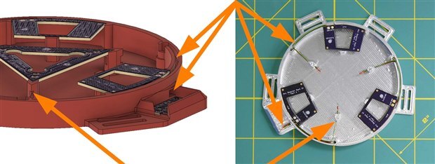

3-D design and printed parts

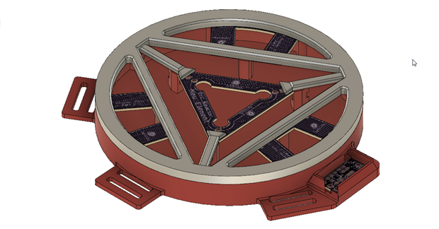

For this project I decided to learn Fusion 360: a powerful tool, very handy for this kind of projects -terrible decision, well at first, considering I decided to learn it merely 4 days before Halloween, but it turned out pretty good, in fact the best decision I made for this project in the end
For the ones curious to know, I first started by creating the PCBs within the 3-D model, assigning textures and cutouts to them. This simplified the rest of the design where I could tune every detail around the PCBs physical dimensions and placement. I could re-arrange, move, add/reduce clearances and add some unique features to this model -explained in more details in the pictures-.
| {gallery:width=810,height=540,autoplay=false} 3-D design |
Arc Reactor complete: Complete design of the Arc Reactor |
Virtual PCB parts: Virtual PCBs vs the real PCBs |
3D model and PCB: Notch that allows easily removing the voltage regulator with point-tweezers |
3D model and PCB: Spaces for wires routing |

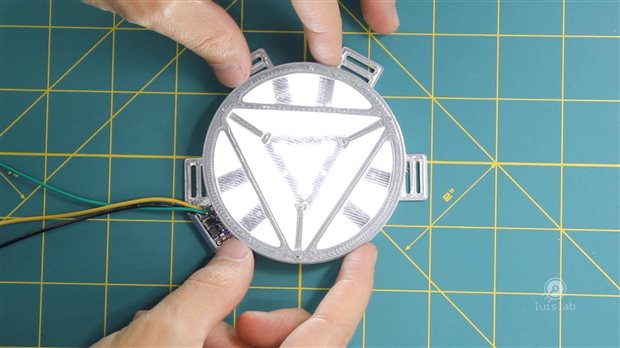

Assembly and Final touches

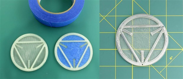

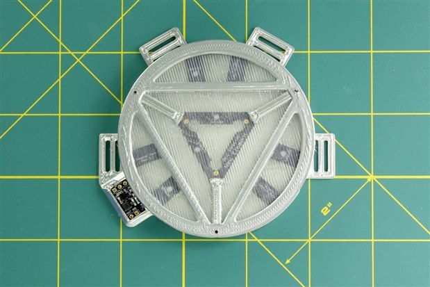

I used Translucent PLA for all the 3-D printed parts which works well at diffusing the light.
| {gallery:width=960,height=640,autoplay=false} Assembly and Final touches |
Painting process: Cover plate before and after adding masking type, and also the final result |
Ready for Assembly: Arc Reactor painted and ready for some electronics soldering |
Fitting process: Fitting process before soldering and the final assembly |

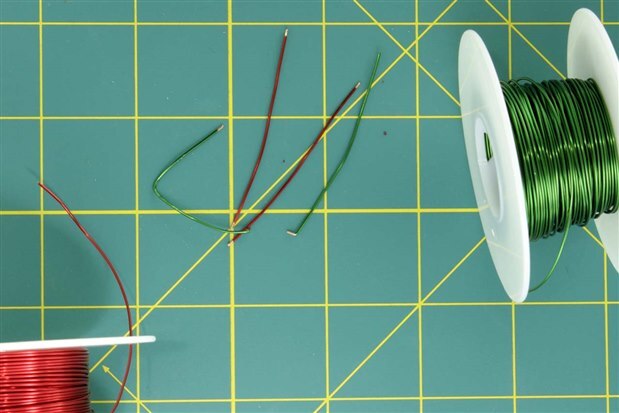

Copper Magnet Wire: 22 AWG Copper magnet. Green will be connected to GND, and RED will be connected to V_LED (Voltage Regulator output) |
Electronics: Arc Reactor's electronics ready for testing |

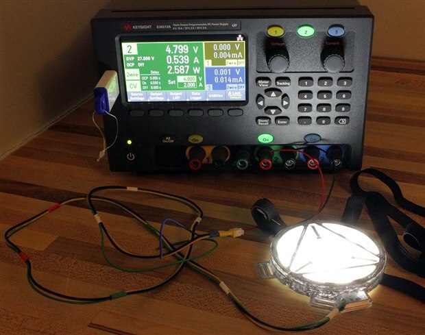

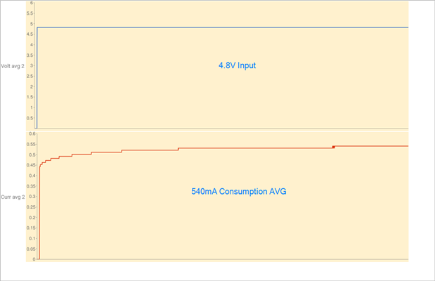

The completed project ended up being small enough, comfortable to wear and with a power consumption of approximately 540mA with a 4.8V input (enough to use it for at least 3h) everything well within my initial expectations.
| {gallery:width=960,height=640,autoplay=false} Power consumption |
Power consumption: Power consumption monitoring with the Keysight E36313A |
Power consumption: Power consumption chart |
