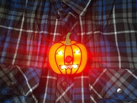

#2 Light up Wearable Jack-O-Lantern
If you having a house party and trying to keep it low key this year because of the pandemic, and only plan to invite a couple of friends. Then, make you self a glowing wearable Jack-O-Lantern, using a Arduino based micro controller and  led strips. Pretty sure your friends will forgive you for not wearing a costume
. In my case, I am using  Adafruit's Trinket, but the 3D printed part will fit Arduino Nano /micro with out the pins, and for LEDs I am using a NeoPixels.
STL attached below - Pumpkin_neopixel.stl + Pumpkin_base.stl

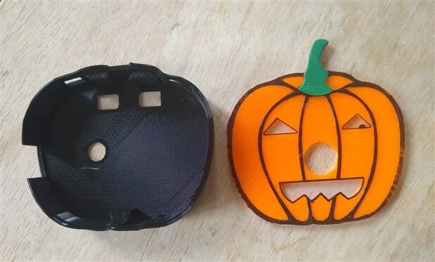

Now, to get started and make one of the versions of Wearable Jack-O-Lantern, fire up you 3D printer and load the Gcode for STL file attached...

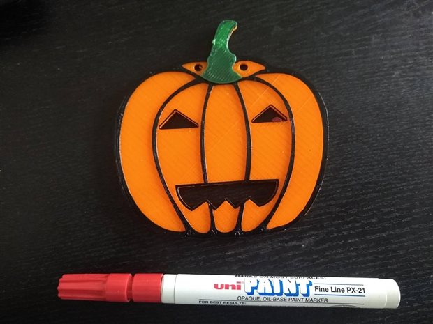

3D printed Wearable Jack-O-Lantern

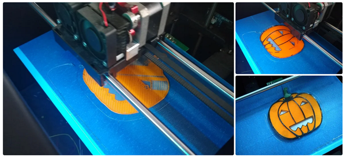

In my case, I printed the STL files using the Flashforge creator pro which has a pause and un-pause option in the menu. And for slicing I am using Slic3r with the layer height set to 0.3mm and infill density to 70%.To print the Pumpkin_simple.stl file, I started of with Orange PLA filament, and then switched to black PLA at about 80% of the print, and then green when 92% of the print was complete.Now if you don't have orange PLA you can use white PLA and the use a Uni Paint pen as you see in the picture below, to paint pumpkin, you should be able to find these pens at you local craft store..

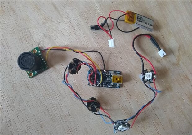

To make this version, you will need a Arduino based micro controller, RGB LED strip, slide switch and a small Lipo and lipo charger, here are list of components I am using for the build, but the 3D printed part should fit and Arduino nano or mini.
Adafruit Trinket (Attiny85)- 5V or 3.3V
- NeoPixel - 4
 - Lipo 3.7V 110mAh or 450 mAh
 - Lipo charger
 - Slide switch
 - Female Lipo connector
 - 26AWG silicone covered wire

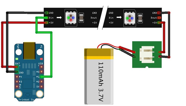

Here is the circuit diagram, to solder the 4 Neopixel to the trinket

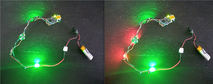

Once done, upload this simple Arduino sketch to the Trinket, which makes the 2 pixels glow green for the eyes and the middle two pixels that will be hot-glued to the mouth blink red.

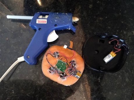

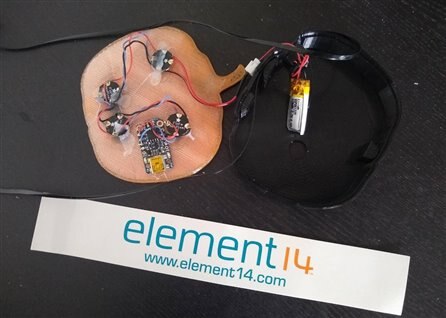

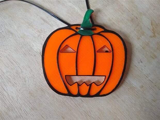

Now it is time to 3D print the Pumpkin_base.stl with black PLA, And once done print Pumpkin_neopixel.stl with transparent, followed by orange, black and then finally green PLA using the pause the un-pause menu item of the 3D print as you see in the picture below. If you don't have pause function in the middle of the print on you printer, use octoprint or you will have to figure out how to manually add lines of Gcode to pause, retract, load filament and then un-pause.
Once done, hot glue the slide switch to the base and all the other electronic components to the top, and now you are ready to pass a string/chain and wear the Jack-O-Lantern, around your neck

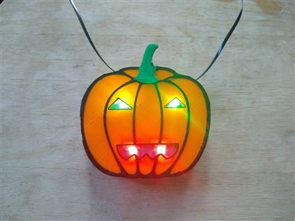

}Once done, 3D print the base Pumpkin_base.stl in black PLA and follow the simlar method above to print Pumkin_TopMaxbotix.stl
Once done hot glue the slide switch to the base, and all the other electronic components to the pumpkin including the Maxbotix sensor, as shown in the picture below. In my case I am using a 110 mAh lipo,as that was the only small lipo I had, but I would suggest using a 450mAh lipo for a longer run time. And also don't forget to carry your Lipo charger and power bank, when you out and about..
