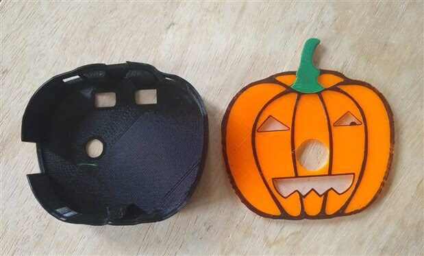

Here is an awesome project to get you in the Halloween spirit, 3D print the STL files attached below to make a Wearable Jack-O-Lantern. I have made 3 version of this project, from a simple 3D wearable Jack-O-Lantern to slightly more advance version to help you/your kids with social distancing. For each of these versions I have designed 3D printable STL files which you can find in the blog post below. And, I am posting this blog post a few days before Halloween, so if you 3D print the files attached below, don't forget to post a picture in the comment section below..
#1 3D printed Wearable Jack-O-Lantern
This is the simplest version, if you have a 3D printer then you just need orange and black filament. Ideal for folks like me, who wait for the last minute image ..
STL attached below - Pumpkin_simple.stl
#2 Light up Wearable Jack-O-Lantern
If you having a house party and trying to keep it low key this year because of the pandemic, and only plan to invite a couple of friends. Then, make you self a glowing wearable Jack-O-Lantern, using a Arduino based micro controller and  led strips. Pretty sure your friends will forgive you for not wearing a costume image. In my case, I am using  Adafruit's Trinket, but the 3D printed part will fit Arduino Nano /micro with out the pins, and for LEDs I am using a NeoPixels.
STL attached below - Pumpkin_neopixel.stl + Pumpkin_base.stl
#3 Social distancing Wearable Jack-O-Lantern
Now if you/your kids plan to go Trick-or-treating, add an ultrasonic sensor to your project so that you can maintain that 2 meter/6 feet distance. And as Mr. Jack Ula, CEO of Halloween on element14 community site says  - make you Halloween adifferenthalloween image. Here I am using a  Maxbotix Ultrasonic Rangefinder - LV-EZ4, as this is the idea form factor for the Jack-O-Lantern nose.
STL attached below - Pumkin_TopMaxbotix.stl + Pumpkin_base.stl
Now, to get started and make one of the versions of Wearable Jack-O-Lantern, fire up you 3D printer and load the Gcode for STL file attached...

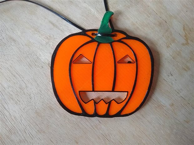

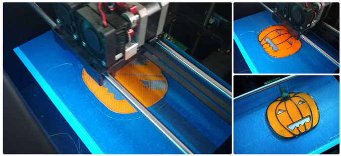

In my case, I printed the STL files using the Flashforge creator pro which has a pause and un-pause option in the menu. And for slicing I am using Slic3r with the layer height set to 0.3mm and infill density to 70%.To print the Pumpkin_simple.stl file, I started of with Orange PLA filament, and then switched to black PLA at about 80% of the print, and then green when 92% of the print was complete.Now if you don't have orange PLA you can use white PLA and the use a Uni Paint pen as you see in the picture below, to paint pumpkin, you should be able to find these pens at you local craft store..

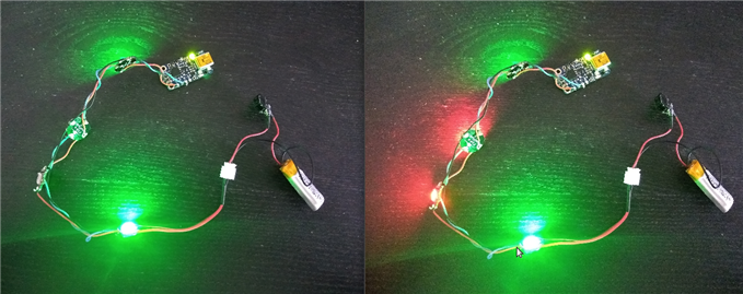

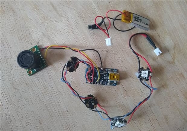

To make this version, you will need a Arduino based micro controller, RGB LED strip, slide switch and a small Lipo and lipo charger, here are list of components I am using for the build, but the 3D printed part should fit and Arduino nano or mini.

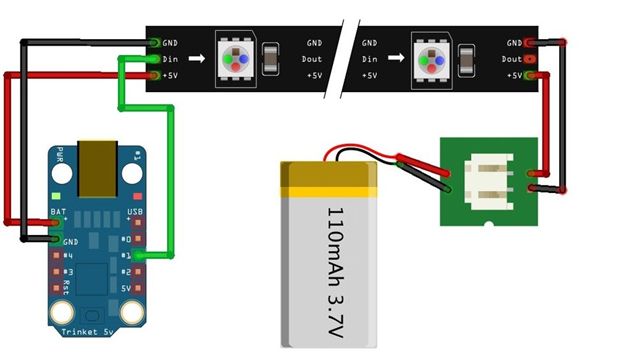

Here is the circuit diagram, to solder the 4 Neopixel to the trinket
Once done, upload this simple Arduino sketch to the Trinket, which makes the 2 pixels glow green for the eyes and the middle two pixels that will be hot-glued to the mouth blink red.

Now it is time to 3D print the Pumpkin_base.stl with black PLA, And once done print Pumpkin_neopixel.stl with transparent, followed by orange, black and then finally green PLA using the pause the un-pause menu item of the 3D print as you see in the picture below. If you don't have pause function in the middle of the print on you printer, use octoprint or you will have to figure out how to manually add lines of Gcode to pause, retract, load filament and then un-pause.

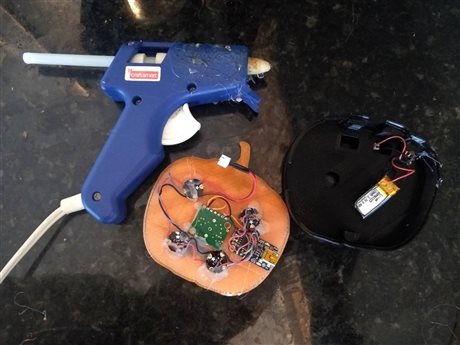

Once done, hot glue the slide switch to the base and all the other electronic components to the top, and now you are ready to pass a string/chain and wear the Jack-O-Lantern, around your neck

Now, in addition to the electronic components above, if you plan on making the social distancing version, you will need an ultrasonic sensor which will detect if there is some one/thing 2 meters in front of you, ideal if the kids are going for trick-or-treating and you have to wait your turn. As part of the circuit the Maxbotix Ultrasonic Rangefinder - LV-EZ4, instead of HC-SR04, as this has a good form factor to form the nose of the Jack-O-Lantern, and is connected to pin#2 of the Trinket as you see in the picture below

Once done hot glue the slide switch to the base, and all the other electronic components to the pumpkin including the Maxbotix sensor, as shown in the picture below. In my case I am using a 110 mAh lipo,as that was the only small lipo I had, but I would suggest using a 450mAh lipo for a longer run time. And also don't forget to carry your Lipo charger and power bank, when you out and about..
