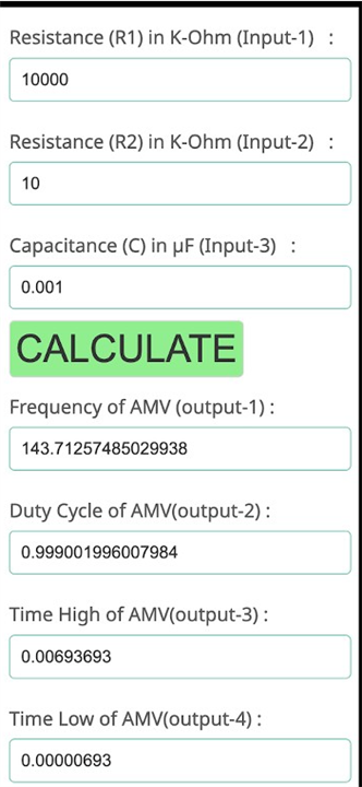

    Sir, Last but not least I was trying to calculate the T-ON and T-OFF time, Frequency, DutyCylce etc. Seems like R1 must be 10M and R2 must be 10K. With this the Duty cycle will be 99.9%.
    If R1 is 10K and R2 is 10M, we get a duty cycle of 50% (Square wave with Equal high and low timings)
    Attached is image of the calculator used from here. Please correct me if I am wrong.

    AE7HD over 2 years ago in reply to Gururaj
    Yes, that is correct.
