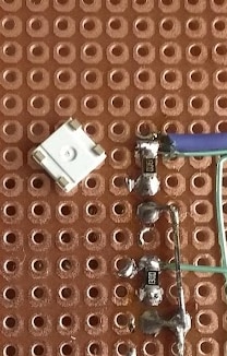

    Those are neat too. I suppose one could always cut the flexible strip into pixels, but they add a few series dampening resistors for signal integrity.
    Looking at one ws2812b on 100 thou breadboard I think I could solder them on a stripboard and impress dw lol
    Have power/ground strips and then cut the Din/Dout strip under the pixel
