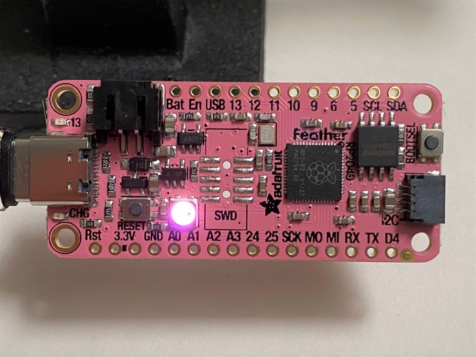

  • ralphjy
    ralphjy over 4 years ago in reply to scottiebabe
    I guess the onboard NeoPixel can sort of do pink (it looks slightly better in real life Relaxed).
  • ralphjy
    ralphjy over 4 years ago in reply to ralphjy
    Looks like it doesn't like the video.
    Here's a pic.

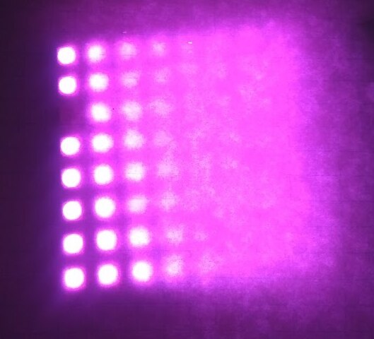

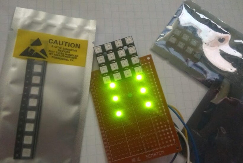

  • scottiebabe
    scottiebabe over 4 years ago in reply to ralphjy
    I Like! Heart eyes Digikey.ca only seems to stock the black soldermask version, I may have to try a direct order from adafruit. I tried the following pinks
    pinks = [ (255,192,203), (255,182,193), (255,105,180), (255,20,147), (219,112,147), (199,21,133) ]
    The last 4 turned out pretty good after some diffusion, a piece of graph paper isn't ideal lol...
    I like your idea of using neopixels, I think I will add that to the todo list, I have 4x4 neopixel arrays, if only I had a 3x3 lol
    I'm not sure which is easier, cutting off one row/column or to hand solder 7 neopixels into the die dots.

  • ralphjy
    It seems like Adafruit only sells pink ones now?  They are using the the same part number that was used for the black ones.  I got mine during the winter promotion when they used the part number 5299.  I also have a black one that I got from Mouser earlier.  Not sure what colors are in distribution because they are using the same part number now.
    I saw an interesting product on Amazon - sheets of RGB LEDs (10x10) - not wired, but on the same panel.  I haven't tried these but am thinking about it.  ALITOVE-100pcs-WS2812B  Seems to be a few vendors selling them - $15.99 seems like an okay price.
