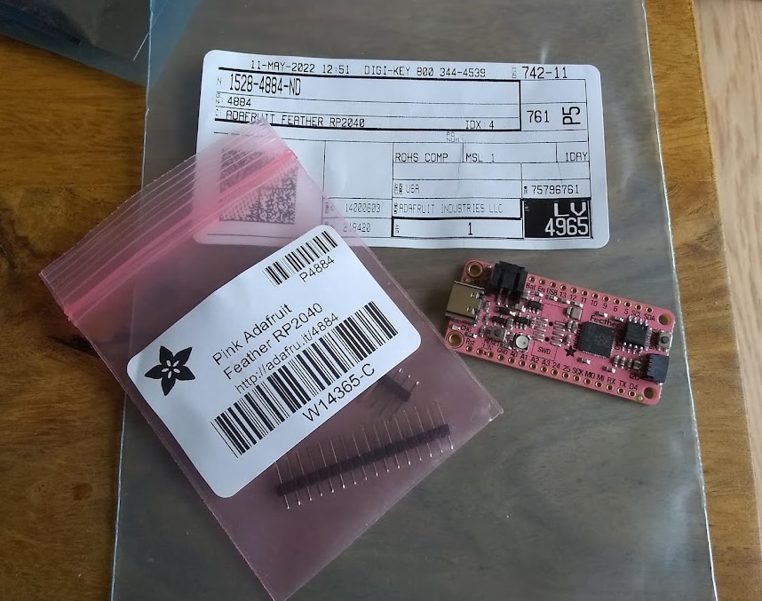

  • scottiebabe
    scottiebabe over 4 years ago in reply to ralphjy
    Good news! Digikey has the pink feather in stock Heart eyes
  • ralphjy
    ralphjy over 4 years ago in reply to scottiebabe
    I'm amazed that you got one so quickly Slight smile!
