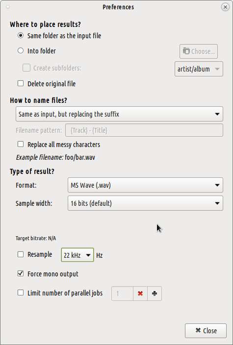

I'm using an Adafruit's Circuit Playground Express with some CircuitPython code in it and some freely available WAV files. The WAV files had to be converted to PCM 16-bit Mono and I think I need to tune down their volume a bit. I used the open-source SoundConverter app in Ubuntu for the conversion:
