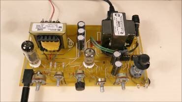

Homemade Electric Guitar Tube Amp on a PCB
