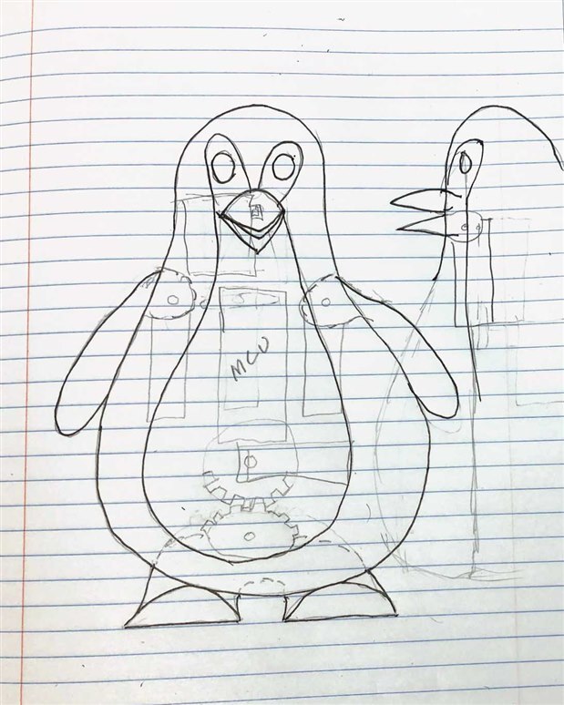

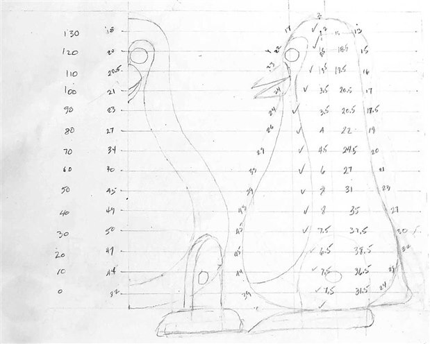

I am not exactly sure what made me decide to make a penguin.  It just occurred to me on my daily walk after deciding against a dinosaur.  Xut is a male penguin and again I am not sure why, but I know he is.  I imagined him rocking back in forth in a waddling fashion, but not actually able to waddle.  He would flap his wings and move his beak.  Here is the first sketch drawn freehand.
Another freehand sketch was drawn roughly to scale and dimensioned.

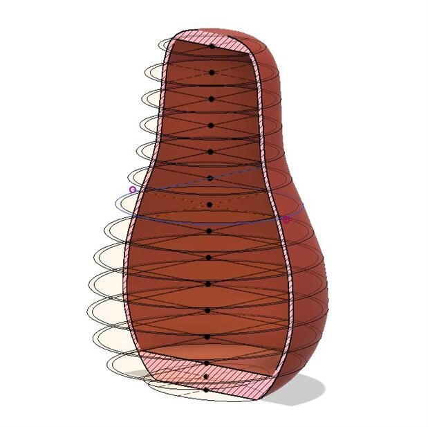

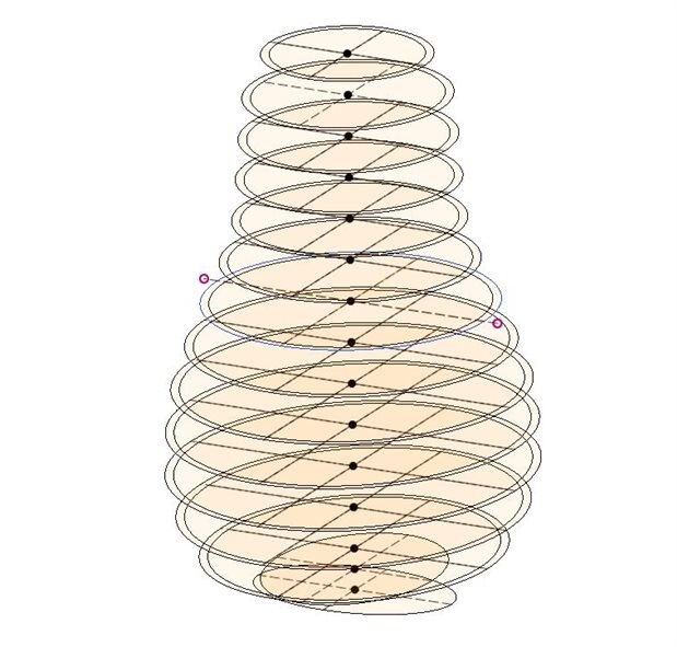

Looking good I thought and then moved into Fusion 360.  Using the dimensions in my sketch and ellipses a skeleton framework was drawn.  The dimensions were made somewhat parametric but the shape is complicated enough that this only worked so well.  After a bit of tweaking it looked like this:
Fusion 360 has a very neat feature called Loft which allows one to create a smooth solid through multiple two dimensional shapes.  The outer ring of ellipses was used to create a solid.  Then the inner rings were used to cut away part of the solid to create a hollow shell.  In the screenshot below a section of the body has been removed to show how it was constructed.

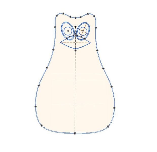

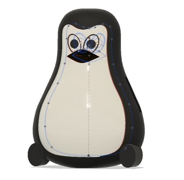

His face and tuxedo were drawn on a plane in the center of the body.  I just played with it until it looked like a penguin and the edges of the tux were close to a vertical plane when viewed from the side.  The double lines are necessary to prevent interference but still allow a snug fit when the tux and face are removed / extruded from the body in the model.

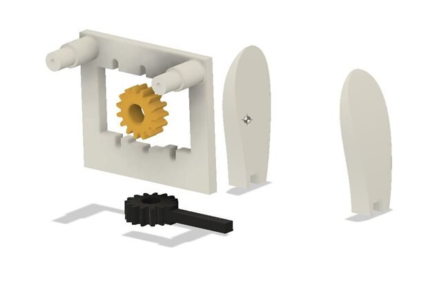

The motor mounts and wing mechanism required a bit of thinking and rework.  The motor mount was first made integral to the body.  A quick print was made to check things and it became apparent that due to limited space and the rafting it was not going to work.  Plus it wasn't possible to get the desired motion from the wings.  So the motor mount was printed separately from the body as shown below and gears used to flap the wings.
The wings are glued on after the motor mechanism and gears are installed.  The orange gear is glued to the horn of the SG90 servos and drives the black wing gear which has a square extension which glues to the wings.  This is the least attractive part of the build and I hope to find time to come back and modify the wings.

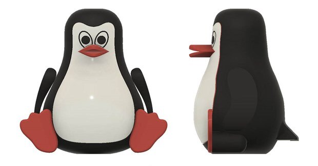

Next a beak, eyes, and feet were added.  Here is the model in both frontal and side views.
You may notice that he has evolved into something that looks a bit like another famous penguin.  See the tail?  There is a hole underneath that goes all the way through for accessing the insides.  Just like a real penguin.

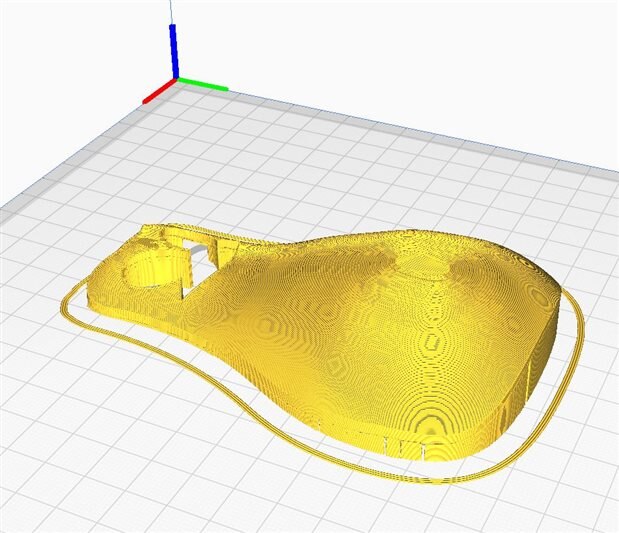

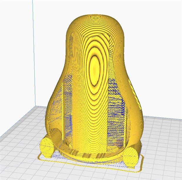

Slicing was done with Cura 4.3.0.  The time to print the main shell is around 12 hours using intermediate quality (0.2 mm layer thickness) on the Anycubic I3 Mega.  The body is printed upright with black PLA and default temperature settings of 200 C for the nozzle and 60 C for the bed.  As seen in the view from the slicer below there is quite a bit of support and travel threads internally that needs to be removed.  The exterior looks nice when printed though and requires minimal clean up.
The other large part with a complicated shape is the tux and face.  It is laid flat and printed with white PLA using standard print quality and  temperature settings.  What rafting there is was left for the most part as it doesn't hurt anything and maybe even adds some rigidity.

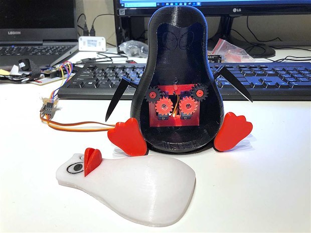

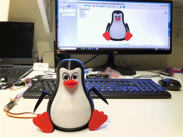

Some cleanup is required of many of the parts before assembly but isn't too difficult.  The eyes and motor mount are hot glued in place.  The beak is a friction fit as is the white tux.  Wings are glued on with super glue.  Here he is completed with the model in the background.
I am amazed at how 3D CAD modelling has changed and improved the design process.  Not to mention 3D printing for prototyping.  Here is Xut with his insides exposed as they currently exist.
