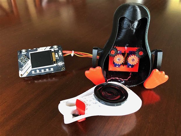

This is the second post in a series about Xut the animatronic penguin.  In the first post we learned about Xut's origin and how he was designed in Fusion 360 and printed on a 3D printer in PLA.  The wings are driven by two SG90 9 gram micro servos.
In this post the mechanical and electronic components are completed.  Xut tells jokes!

Making an Animatronic Penguin
Hardware
     Adafruit EdgeBadge
     2 SG90 9 gram Microservos
     Salvaged speaker
Firmware / Software
     Adafruit CircuitPython
Tools
     iPhone  - record sound
     Anycubic I3 Mega
     Soldering iron
Design Software
     iTunes - convert to WAV
     Audacity - change pitch
     Fusion360 - design penguin and mechanism
     Cura - Slicer
Consumables
     PLA - black, white, orange
     Solder
     Wire
The design and fabrication of the penguin body and the mechanics of the motorized wings were described in detail in the first post.  Briefly, the body was freehand sketched and roughly dimensioned.  It was then modeled and tweaked in Fusion 360 and printed in PLA on an Anycubic I3 Mega 3D printer.  The mechanical modifications since that time are limited to minor aesthetic modifications to the wings and the addition of a speaker inside the body.  Hot glue and cyanoacrylate adhesive (superglue) was used to secure everything.   An Adafruit EdgeBadge was also wired securely to the motors and speakers.
Why use the EdgeBadge?  The quick answer is that they were handed out at the Superconference on hacking that I attended a week back and it was readily available.  The original intent was to place a microcontroller and LiPo battery inside the body but it turned out to not fit well.  So the EdgeBadge, described as a microcontroller that can run a miniature version of TensorFlow Lite was pressed into service.  To get adequate volume, the trace to the onboard speaker was cut and a speaker salvaged from an old printer was placed inside Xut. It turned out that the LEDs and display on the EdgeBadge are attention getters and do not detract too much from the build.
The jokes were recorded with my voice on an iPhone and then converted in iTunes to WAV files which are required by CircuitPython.  The pitch was then altered with Audacity.  CircuitPython is picky about how conversion is done and format so follow the instructions closely.

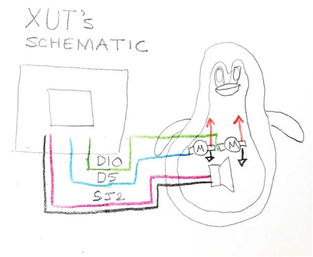

Schematic
The schematic is very simple.  Digital pins D5 and D10 on the EdgeBadge are used to drive the two servos.  The motors are also connected to 5V provided by the board and ground.  The speaker is connected to the speaker connection provided on the board.  All connections for display, buttons, and LEDs are on the EdgeBadge board.

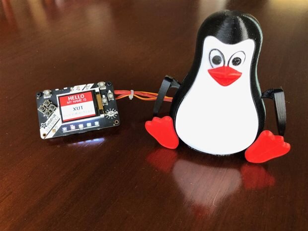

The jokes are loaded onto the EdgeBadge along with the script.  It turns out the file size of the jokes is large enough that it is limited to eight WAV files.
Demonstration
In the demonstration video below you can hear all Xut's jokes.
The laugh track was added to the recording afterwards in Adobe Premier Elements.
Business Case
According to this unimpeachable source, there are 30 to 100 million Linux users in the world.  Let's assume 30 million.  Of those 30 million only about 0.1% might be hard core enough to want a Xut penguin on their desk telling jokes (fully hackable, insert your own jokes).  But that is still 30,000 people.  If I can market this thing as a kit and make a $10 per unit profit that is $300,000!  The best timing would be to have it ready for market this time next year for the holiday season. It takes approximately 20 hours to print one Xut  and it is aggressive but assume two machines can print one Xut per day. There are roughly 200 work days between now and when they need to be ready for sale for the holidays.  Assuming I can sell 10,000 Xut kits the first year ($100,000 profit!) I need to set up and start running 100 printers in my house.  Better order printers and PLA and get started now!
Conclusion
I am real happy with the way the body looks and learned a lot about printing complex 3D shapes.  The basic concept of an animatronic penguin telling jokes also works well in my opinion.  On this prototype it turned out there was insufficient room for everything to be placed in the body.  Ideally the animatronic mechanism and electronics would have been refined prior to dimensioning and printing the body.  The project will be added to my growing list of things I would like to redo and improve.  Improvements might include:
