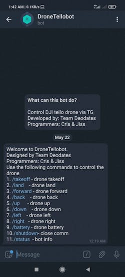

We used BotFather and the Telegram API to develop our custom Telegram bot named @DroneTellobot.
Custom developed bot: @DroneTellobot
Custom-developed bot: @DroneTellobot
Our custom bot is developed in such a way that it can be accessed directly using its unique name @DroneTellobot or by adding the bot into a group.
If added to a group, all the members of the group can simultaneously use the bot to control the drone. This is very useful in a case for eg. testing the drone as a team.

At the time of this writing, the following commands are programmed into the custom telegram bot.
  • /takeoff - drone takeoff
  • /land - drone land
  • /forward - drone forward
  • /back - drone back
  • /up - drone up
  • /down - drone down
  • /left - drone left
  • /right - drone right
  • /battery - drone battery
  • /shutdown- close comm
  • /status - bot info
There is the possibility to add more commands which are available with the help of DJI Tello SDK, which will be incorporated soon.
