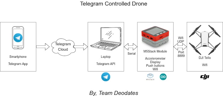

A middleware is required to interact between the telegram API and the drone.
If the M5Stack module is connected to the drone via WiFi, it won't be able to access the Telegram API calls due to the absence of internet connectivity.
To overcome this we use a laptop as middleware for accessing the telegram API calls and sending the commands to the M5Stack module via a serial connection.
Telegram Controlled Drone

    Hi shabaz , a very interesting question. Let me explain For testing, we are using the DJI Tello drone which is the only drone available to us. It can only be controlled by connecting to the soft AP provided…
    shabaz over 5 years ago +2
    Hi, Impressed this works given the risk/chance of delay via the app and protocol, but was curious, what is the M5module doing? Couldn't it be removed, and send UDP directly from the laptop? Or some other…

    Also if we use a different drone such as the DIY/hobby ones which gives us more flexibility in the communication methods, this middleware(s) could be removed pretty easily.
    This is a sure try for a future case though, once we get our hands-on with such a drone.

    Adding to this, in the 5th blog Telegram Controlled Drone #5 : Conclusion and Future Scope, we have already discussed our future plans to make the middleware redundant and thereby removing it completely. image
