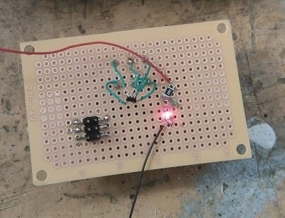

Here's my idea I'm afraid I did not quite have time to get it completed as I've had lots of other things on.
My first thought was what is the cheapest MCU I can find? I spotted the ATTiny10 chips for just 25p each so bought a handful of these along with some surface mount LEDs and resistors.
These would be powered from some button batteries I just happened to have lots of.
The nodes would be spaced out on a clear plastic sheet so you could see that there was no physical connection between them.
They would provide a synchronised pattern or message.
So how does the synchronisation work you ask? Well that would be done by using a camera flash and the LEDs acting as a sensor (a trick I learnt from the Microbit).
https://electronics.stackexchange.com/questions/902/detecting-light-with-an-led
Unfortunately I only got as far as wiring up the ATTiny to some wires and the LED to some wires. I do have a programmer for the ATTiny but I've not tried programming it yet.

    Andy, Maybe you haven't got as far as you'd have liked but thank you for sharing as you've given me some ideas for in the future. Your use of a small MCU was exactly along the lines of what I was thinking…

    Maybe you haven't got as far as you'd have liked but thank you for sharing as you've given me some ideas for in the future. Your use of a small MCU was exactly along the lines of what I was thinking when I proposed the Project14 'Clustered MCU'. At the time I also had a whole strip of 6pin simple PIC MCU and was thinking what circuit could I replicate 20 times, each powered by a coin cell and each would do something fun. Perhaps scattering them on a table and watching them move or flash, organise or communicate. I then found that my PIC were so limited in program memory and RAM most of what I wanted to do wasn't feasible (even if went back to using assembly language).
    However you have overcome one issue I had....the lack of pins. Pin multiplexing with the ICSP pins would require some jumpers but even then there was little left over to do anything interesting. However I hadn't though of ever using the output LED as an input sensor and your idea of a flash setting them off works well too - a great way of synchronising units to do something at the same time (or delay from that point accordingly).
    So well done, you've got much further than me image
