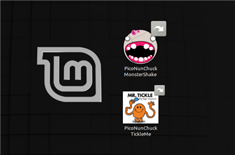

I even created some customised desktop icons (as shown above)... I decided to use an image of Mr. Tickle (sourced from Wikipedia) as one of my personalised icons - this is a tribute to the humorous Mr. Men series by Roger Hargreaves (first published 50 years ago). According to Wikipedia, Mr. Tickle was the first Mr. Men book, which was published on 10 August 1971. I believe UK viewers will be treated to a Mr Men documentary on channel 4 TV - https://www.channel4.com/press/news/channel-4-commissions-50-years-mr-men-celebrate-half-century-iconic-childrens-books-and.

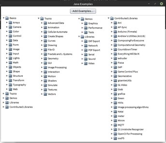

There is a wealth of available libraries thanks to the contribution of others. All these libraries also provide you with a good selection of examples to learn from. A reference of all the libraries can be found here: https://processing.org/reference/libraries/

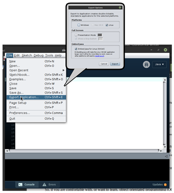

As an added bonus you can also create stand-alone Windows/Linux applications, using the export function.

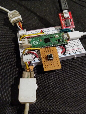

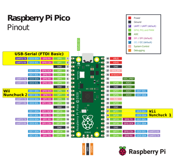

With all the fanfare following Raspberry Pi’s release of their very first microcontroller chip, the RP2040, I just couldn’t resist and purchased a $4 Raspberry Pi Pico board. I then did what most would probably do and tried out a few examples, then put it on the shelf while I thought about applications that would benefit from the dual core ARM Cortex M0+ microprocessor.
It was about a month later that I read a fellow element14 member's blog titled “Program RPi Pico using Mbed library with Arduino IDE”. Now this was music to my ears as I always felt that the RP2040 and Mbed were well suited to each other.

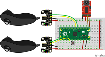

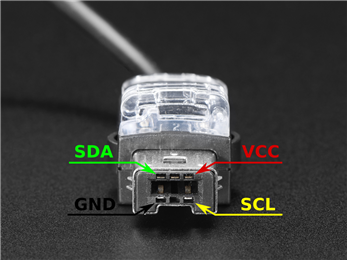

It just so happened that I had two Wii NunChucks, which used the I2C communication protocol with an I2C slave address of 0x52. As the Raspberry Pi Pico board offered 2 x I2C bus controllers I decided to see if I could create an application that would use both I2C ports using the Arduino IDE.  I knew this was possible as the Arduino Due and the Espressif ESP32 also offered two I2C ports, and I had used these board before. This would be achieved in your Arduino firmware by initialising the two I2C ports as “Wire” and “Wire1”.
So I set about building my circuit.
As everyone quickly discovers, it is really useful to have a reset button when prototyping and developing an application. As this is not included on the Pico board, I started by adding in one.
Then with the Raspberry Pi Pico board you have the flexibility to choose which pins to use for I2C0 and I2C1 (as shown on the Pinout diagram). I arbitrarily chose to use GP20 and GP21 for I2C0 and GP9 and GP10 for I2C1. I also wanted to separate out my serial output from the USB port. So I used a Sparkfun FTDI Basic breakout board as my UART-to-USB serial bridge and connected this to UART0 (GP0 and GP1).

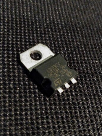

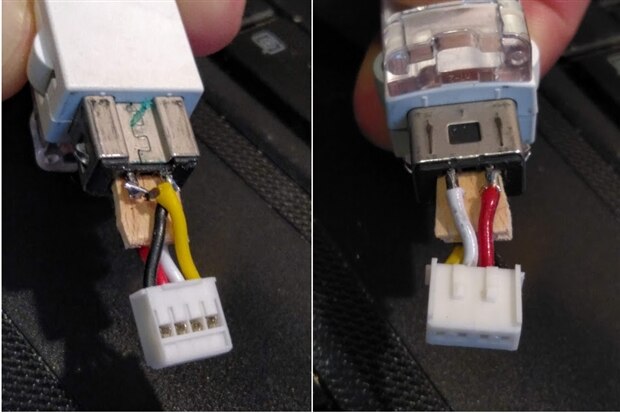

I did not have any off-the-shelf breakout boards, like those available from Adafruit, for my Wii NunChucks so I set about creating my own connections.
I discovered that a standard 3-terminal (TO-220) voltage regulator has pins that are the right shape and size to fit inside the unique NunChuck connector slots above and below the main connector slot. As I had a few re-salvaged regulators lying around I simply snipped off the legs and trimmed the length to suit. I then shaped a fragment of an ice cream stick for the main NunChuck central slot to give added robustness, as this helped prevent my makeshift connectors from disconnecting. I then soldered these onto some Grove connectors which when then slotted onto my breadboard to allow connection to the Pico board. It all works a charm.
{gallery:autoplay=false} NunChuck Connection

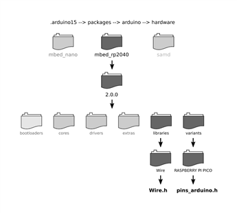

This was my cue to get started with I2C. However, I quickly discovered that you could not use both I2C ports with the Arduino Mbed Core. Undeterred, I dived in to see if I could fashion a quick fix knowing full well that any official board update from Arduino (through Arduino IDE Board Manager) would overwrite my mods.
And... success!
I found in Wire.h that there is this check:
#if WIRE_HOWMANY > 0
extern arduino::MbedI2C Wire;
#endif
#if WIRE_HOWMANY > 1
extern arduino::MbedI2C Wire1;
#endif
typedef arduino::MbedI2C TwoWire;
Then I found that WIRE_HOWMANY was defined inside pins_arduino.h.
Also within pins_arduino.h I found that we need to make a few other modifications to define the SDA and SCL pins for the 2nd I2C port. Then for my own convenience, I also changed my default I2C port pin numbers to something I wanted to use as my default as Arduino used Pico I2C1 pins as the default rather than one of the I2C0 pins. It’s worth noting that you can also then later choose your own pins for SDA/SCL in your sketches through the Wire library.
// Wire
#define PIN_WIRE_SDA (20u) // default was 6
#define PIN_WIRE_SCL (21u) // default was 7
#define PIN_WIRE_SDA1 (6u)
#define PIN_WIRE_SCL1 (7u)
#define WIRE_HOWMANY (2) //default 1
#define I2C_SDA (digitalPinToPinName(PIN_WIRE_SDA))
#define I2C_SCL (digitalPinToPinName(PIN_WIRE_SCL))
#define I2C_SDA1 (digitalPinToPinName(PIN_WIRE_SDA1))
#define I2C_SCL1 (digitalPinToPinName(PIN_WIRE_SCL1))

  • Tickle.pde – this can be found in the Topics -> Interaction folder.
  • AccelerationWithVectors.pde – this can be found in the Topics -> Vectors folder.
  • G4P_Stick – this example is from an external library (G4P) which can be downloaded via the Processing Import Library -> Add Library... menu option. This example is found in the Contributed Libraries -> G4P folder.
Here I changed the way the “Tickle” message moved on the screen in the Tickle.pde sketch by applying the Acceleration movement characteristics found in the AccelerationWithVectors.pde sketch. Then instead of using the mouse coordinates to govern direction and magnitude of acceleration as per the  AccelerationWithVectors.pde sketch I used one NunChuck’s joystick movement for direction and the Z & C buttons to acceleration boost or dampen.
Then I added in the pointer or arrow as found in the G4P_Stick.pde sketch. Here I used the 2nd NunChuck joystick to govern movement and used the Z and C buttons to speed up or slow down speed.
