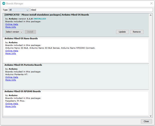

When I wrote my initial blog about the Arduino-Pico library, fmilburn mentioned that Arduino had just released an Mbed library that had support for the RPi Pico https://github.com/arduino/ArduinoCore-mbed/releases/tag/2.0.0 .   The github installation instructions require cloning the ArduinoCore-mbed repo and the ArduinoCore-API repo and then adding a symlink to that API.  I had been wanting to use the Mbed RTOS functions with the Nano 33 BLE Sense board, but I guess I'll try it with the RPi Pico first.
Before I tried using the installation instructions, I decided to check the Boards Manager for Mbed supported boards.

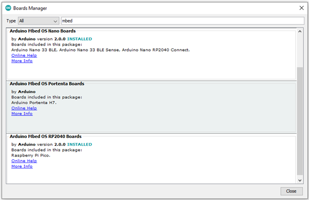

And there is support the RPi Pico.  I also noticed that the previous entry that was used for the Nano 33 BLESense (Arduino Mbed OS Boards) has been deprecated.  So, I decided to do the install from the Boards Manager for the RPi Pico and the Nano 33 BLE Sense.
And it looks like it is the current version (2.0.0).  I don't have a Portenta yet so I didn't install that.

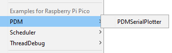

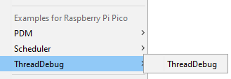

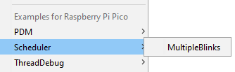

Then I took a look at available examples and there were only a few.
I found it interesting because the first two examples use an onboard PDM microphone and onboard RGB led - neither of which exist on an RPi Pico image.
It runs out that none of the examples will compile.  The first two for obvious reasons and the third I think because there is a missing architecture definition (this was a red herring).
Then I noticed that all the Mbed supported boards have the same examples.
All 3 examples will compile for the Nano 33 BLE Sense.  The first two examples were written for the Nano 33 BLE Sense and the third one was written for the Portenta.  They need to provide new examples for the RPi Pico...
