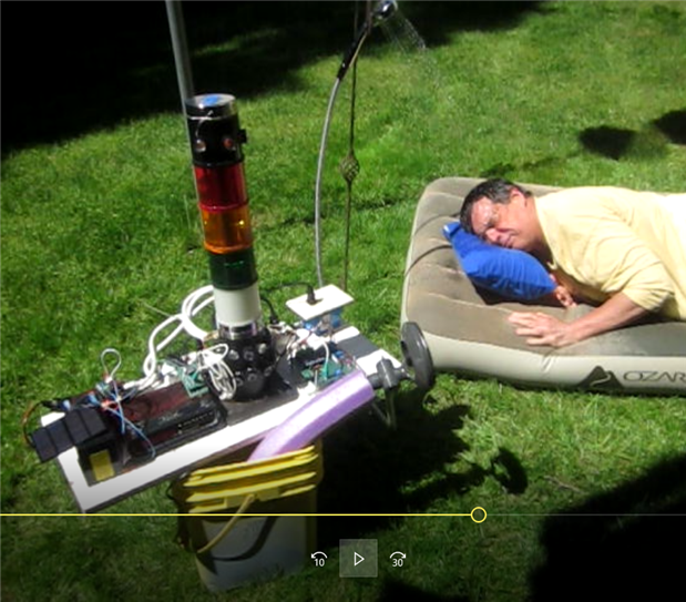

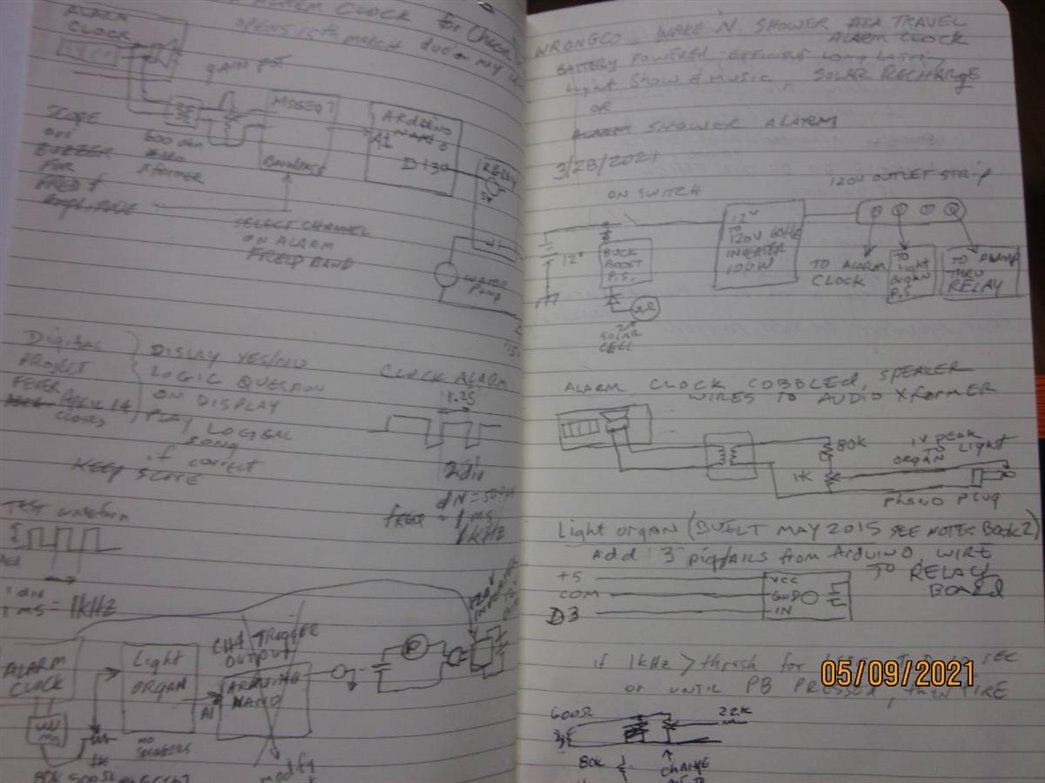

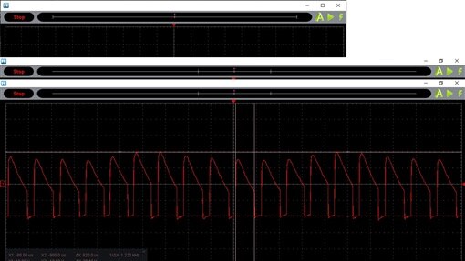

Rube Goldberg style alarm clock system,The entire system is powered from a 12V battery and a 100W inverter. There is a solar panel for recharge.
while the alarm clock radio is ON or Wake to Music, radio stations play as normal, with a light organ providing visual entertainment
HOWEVER
the alarm setting gives a 10 second (or more) cold shower to the sleeper when the alarm goes off.
The light organ is Arduino based and MSGEQ7 control .
The light organ software is updated (from its orginal 2015 program) to detect the alarm audio signature and then turns on a relay to drive the sizable 11 gallons/minute aquarium pump.
You Gotta watch the hilarious video:
https://youtu.be/A5MiU3C9NaM
schematics & Arduino Nano software attached
  EqiilizerLEDsWakeNshower
  is started from EquilizerLEDsRev1_Working is  EquilizerLEDsRev0_Working with bands 1 and 7 with lower thresholds
  EquilizerLEDsRev0_Working is a relabled version of Test 3 Working, based on Test2Working
  showing the MSWGEQ7 is reading an analog input from a ipod earphone jack, and providing volts from the multiplexor.

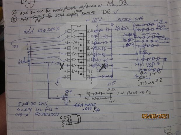

  -> added pot to analog input 1 for threshold adjust on LED trigger
  -> add a PB to D6 to run a test routine that strobes the lights
  -> add ULN2803 driver for LEDS, requires to un-invert the HIGH LOW states

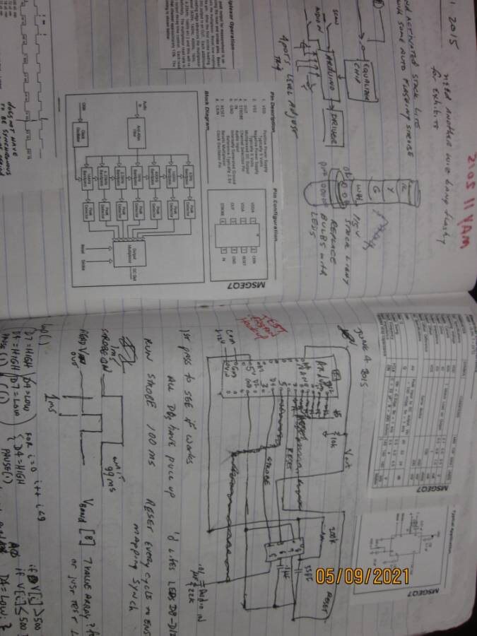

  control interface to MSGEQ7 IC
  strobe control for equalizer bands, read in multiplexed voltage per band, drive outputs LEDs
  Arduino D4 wires to MSGEQ7 pin 4 strobe
  Arduino D5 wires to MSGEQ7 pin 7 reset
  all ins have pull ups
  Arduino D7 = 63Hz LED , LOW = ON
  Arduino D8 = 160Hz LED
  Arduino D9 = 400Hz LED
  Arduino D10 = 1kHz LED
  Arduino D11 = 2.5 kHz LED
  Arduino D12 = 6kHz LED
  Arduino D13 = 16kHz LED
  Arduino A0 wires to MSGEQ7 pin 3 Vout

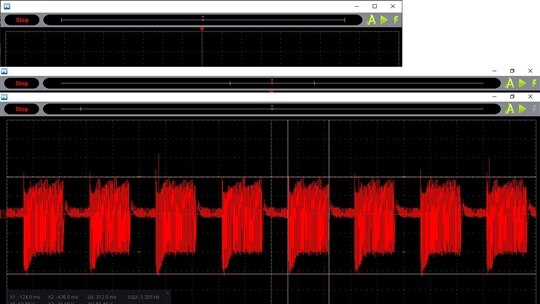

The WakeNShower audio input comes from an alarm clock, tapped from its speaker thru an audio transformer.
The code adds a relay output to D3.
The alarm sound is a loud 1kHz square wave that triggers D10 thru D13.
Use those signals to determine if the alarm sounded, and to pick up the relay.
The relay activates a water pump for the shower.
