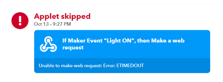

     IoT Magical Wand - The Arduino MKR1000 monitors the position of the magical wand. This is achieved through the accelerometer connected. The wand is activated by inverting it upside down and placing it in that position for a count of 5. To turn it OFF do the same again or continue for 5 more counts. Only if it passes this condition, the system will start to monitor the change in the position of the wand, other than the upside down position. I have configured three positions and this will make a respective IFTTT web request. For instance, if I tilt the wand towards left that will turn ON a particular relay. You can now tilt the wand to another side and turn ON another relay. If you again comeback and tilt towards left, the system will remember that it has sent a turn ON request and will now turn it OFF. So based on the position of the wand, Arduino MKR1000 will make a corresponding IFTTT web request which will, in turn, make a web request to thinger.io connected Node MCU. The Node MCU will then serially communicate this with Arduino UNO to turn ON/ OFF the respective relay. When there is a request made, the LEDs mounted inside the top head of the wand will blink in a rotating pattern to show that the magic has happened!
     You can find instructions for connecting Node MCUs to thinger.io IoT Platform here - Steps for connecting Arduino MKR1000 with thinger.io for reading temperature data. These instructions are intended for Arduino MKR1000 but it is the similar process for Node MCUs as well. If you have any difficulties let me know in the comments section below.
     Alexa - You can also replace the magical wand and use Alexa to make a web request to IFTTT. This will then trigger the Node MCU and turn ON/ OFF the respective relay.

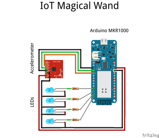

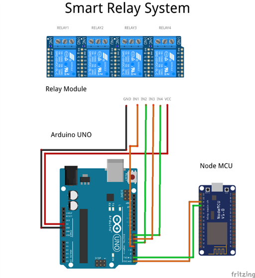

Circuit Connection
     Below is the circuit connection diagram between the Arduino MKR1000, accelerometer and LEDs placed inside the IoT Magical Wand.
     Below is the circuit connection diagram between the Node MCU, Arduino UNO, and relay which will together be the Smart Relay System.

Arduino MRK1000's Code:
/*Including Required Libraries*/
#include <SPI.h>
#include <WiFi101.h>
#include "arduino_secrets.h"  /*Add secret credentials in this file*/
/*Please enter your sensitive data and credential in the Secret tab/arduino_secrets.h*/
char ssid[] = SECRET_SSID;  /*Your network SSID (name)*/
char pass[] = SECRET_PASS;  /*Your network password (use for WPA, or use as key for WEP)*/
int keyIndex = 0;           /*Your network key Index number (needed only for WEP)*/
int status = WL_IDLE_STATUS;
char server[] = "maker.ifttt.com";
/* Initialize the Ethernet client library with the IP address and port of the server that you want to connect to (port 80 is default for HTTP):*/
WiFiClient client;
/*Declaring and initializing Variables*/
int X = A1, Y=A2, Z=A3;
int LED1 = 2, LED2 = 3, LED3 = 4, LED4 = 5;
int loopControlVar1 = 0;
int loopControlVar2 = 0;
int decider1 = 0, decider2 = 0, decider3 = 0;
int onOff1 = 0, onOff2 = 0, onOff3 = 0;
/*Setup function*/
void setup() {
  /*Declaring the pins connected to relay module pins as OUTPUT*/
  pinMode(LED1, OUTPUT);
  pinMode(LED2, OUTPUT);
  pinMode(LED3, OUTPUT);
  pinMode(LED4, OUTPUT);
  pinMode(LED_BUILTIN, OUTPUT);
  pinMode(X, INPUT);
  pinMode(Y, INPUT);
  pinMode(Z, INPUT);
  /*Initializing serial communication to 38400 baud raute*/
  Serial.begin(38400);
  /*After connecting to battery it is hard to determine whether the setup is working or not.
   *Hence using the builtin LED, we can have an indication of the setup's working condition.
  digitalWrite(LED_BUILTIN, HIGH);
  /*Check for the presence of the WiFi shield:*/
  if (WiFi.status() == WL_NO_SHIELD) {
    Serial.println("WiFi shield not present");
    /*Don't continue, to inidcate code is stuck here*/
    while (true);
  /*Attempt to connect to WiFi network:*/
  while (status != WL_CONNECTED) {
    Serial.print("Attempting to connect to SSID: ");
    Serial.println(ssid);
    /*Connect to WPA/WPA2 network. Change this line if using open or WEP network:*/
    status = WiFi.begin(ssid, pass);
    /*wait 10 seconds for connection:*/
    delay(10000);
  /*Confirmation of Wifi connected along with details about that connection*/
  Serial.println("Connected to wifi");
  printWiFiStatus();
  delay(5);
#include <ESP8266WiFi.h>
#include <ThingerESP8266.h>
/*Declaring and initializing Variables and objects*/
int relayState = 0;
ThingerESP8266 thing(SECRET_USERNAME, SECRET_DEVICEID, SECRET_DEVICECREDENTIAL);
/*Setup function*/
void setup() {
  /*Code required to connect to thinger.io*/
  thing.add_wifi(SECRET_SSID, SECRET_PASS);
  /*Input variable to receive data from thinger.io*/
  thing["relay"] << [](pson& in){
      relayState = in["state"];
      /*Function to change the relay state*/
      changeRelayState();
/*Loop function*/
void loop() {
  /*This will repeatedly connect with thinger.io and send/ receive information*/
  thing.handle();
/*This will send the relay state that needs to sent serially to Arduino UNO*/
void changeRelayState(){
  /*Odd numbers are for ON state and even numbers are for OFF state*/
  /*Relay #1 --begin*/
  if(relayState == 1)
    Serial.print(1);
  else if (relayState == 2){
    Serial.print(2);
  /*Relay #1 --end*/
  else if(relayState == 3)
    Serial.print(3);
  else if (relayState == 4){
    Serial.print(4);
  else  if(relayState == 5)
    Serial.print(5);
  else if (relayState == 6){
    Serial.print(6);
Arduino UNO's Code:
int Relay1 = 4;
int Relay2 = 5;
int Relay3 = 6;
int Relay4 = 7;
int serialData = 0;
/*Setup function*/
void setup() {
  pinMode(Relay1, OUTPUT);
  pinMode(Relay2, OUTPUT);
  pinMode(Relay3, OUTPUT);
  pinMode(Relay4, OUTPUT);
  /*HIGH is the low/ OFF state in the relay module, hence setting all the relay pins to HIGH*/
  digitalWrite(Relay1, HIGH);
  digitalWrite(Relay2, HIGH);
  digitalWrite(Relay3, HIGH);
  digitalWrite(Relay4, HIGH);
/*Loop function*/
void loop() {
  /*Check for any serial data received from the Node MCU connected*/
  if(Serial.available()>0){
     serialData = Serial.read();
     /*Serial.println(serialData); //debugging*/
     relayData(serialData);
/*Function to turn ON/ OFF the relay according to the serial data instruction received*/
void relayData (int serialIn){
  /*49 equals 1, 50 equals 2 and so on ... in ANSI standard*/
  if (serialIn == 49){
    /*LOW is the high state, so this actually turns the relay ON*/
    digitalWrite(Relay1, LOW);
  else if (serialIn == 50){
    /*HIGH is the low state, so this actually turns the relay OFF*/
  else if (serialIn == 51){
    digitalWrite(Relay2, LOW);
  else if (serialIn == 52){
  else if (serialIn == 53){
    digitalWrite(Relay3, LOW);
  else if (serialIn == 54){
  else if (serialIn == 55){
    digitalWrite(Relay4, LOW);
  else if (serialIn == 56){

  • The IFTTT web requests not happening while using Node MCU. Arduino MKR1000 successfully triggers IFTTT but the request to Node MCU is not successful and you are returned with an 'Error: ETIMEDOUT' message. I never faced this issue when I used an Arduino MKR1000. Since I had only one Arduino MKR1000 at my disposal I had to use Node MCUs.
  • Also, the Node MCUs did not stay connected in thinger.io as well. The connection was unstable. This is also not there in the case of Arduino MKR1000.
  • Another challenge to say would be the LiPo battery connected to Arduino MKR1000. The charge LED in Arduino MKR1000 at times will not turn ON even if your battery is charging. This, as I read in some Arduino forums, seem to be the as-is charging mechanism of Arduino MKR1000.
  • Also, you never know whether or not your Arduino MKR1000 is running the program while on battery since the power LED will not turn ON. So I used the built-in LED to indicate that the program is running by blinking it.
