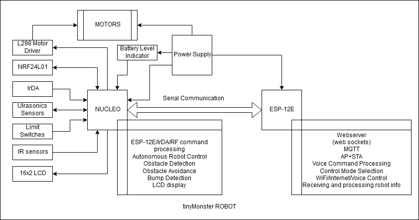

System Block Diagram

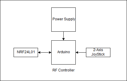

It is showing the programming function implemented inside nucleo and esp module. Also it is also indicating how different hardware modules will work together in FIG:1. Similarly main hardware modules of RF remote are shown in FIG:2.
FIG 1: tinyMonster Robot Block Diagram
FIG:2 RF Remote Block Diagram

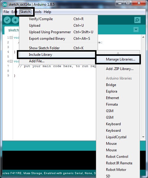

Required Libraries
  • ESP-12E
    • ESP8266WiFi
    • ESPUI
    • Adafruit_MQTT
    • Adafruit_MQTT_Client
    • Ticker
    • ESP8266mDNS
    • ArduinoOTA
    • FS
    • Hash
    • ESPAsyncTCP
    • ESPAsyncWebServer
    • SPIFFSEditor
    • ArduinoJson
    • stdlib_noniso
  • NUCLEO
    • LiquidCrystal
    • IRremote
    • Ultrasonic
    • SPI
    • nRF24L01
    • RF24
    • printf
* IMPORTANT: use only stable version of ArduinoJson 5.13.3. Do not use beta version it will not work with ESP code.
  • ESP8266 libraries

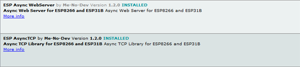

IMAGE TITLE: ESPAsyncTCP and ESPAsyncWebserver (important for ESPUI)

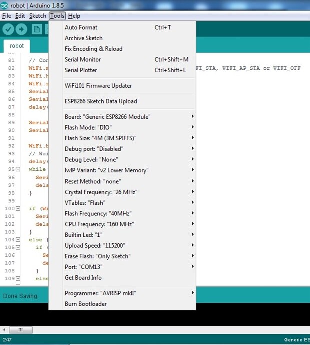

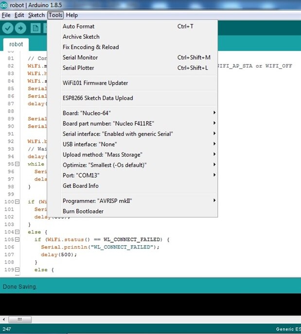

Board Setting
I am using generic ESP-12E module. To program it using Arduino IDE first of install its core using Arduino board manager. After that you can select ESP board. Other setting to program generic ESP module are shown in FIG.3. Here COM-13 is port at which my USB to Serial is connected to program ESP-12E. You need to select COM port at which your ESP module is connected. Similarly after installing STM32 core using board manager you will be able to select NUCLEO board and other required settings are shown in FIG.4.
FIG.3: ESP-12E module setting
FIG.4: NUCLEO STM32F411RE setting

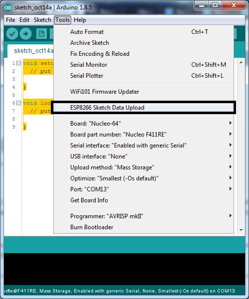

There is a Arduino tool to directly store data in SPIFFS memory of ESP without any programming. Complete guide how to install it in Arduino IDE is given in link below OR you can directly download it from Download page and after extraction the jar file should be placed at following path <sketchbook directory>/tools/ESP8266FS/tool/esp8266fs.jar>.
GUIDE
  • https://github.com/esp8266/arduino-esp8266fs-plugin
DOWNLOAD
  • https://github.com/esp8266/arduino-esp8266fs-plugin/releases
After successfully installing ESP data uploader you will be able to see this option in Arduino menubar >> Tools >> ESP8266 Sketch Data Upload as shown in FIG.5.
