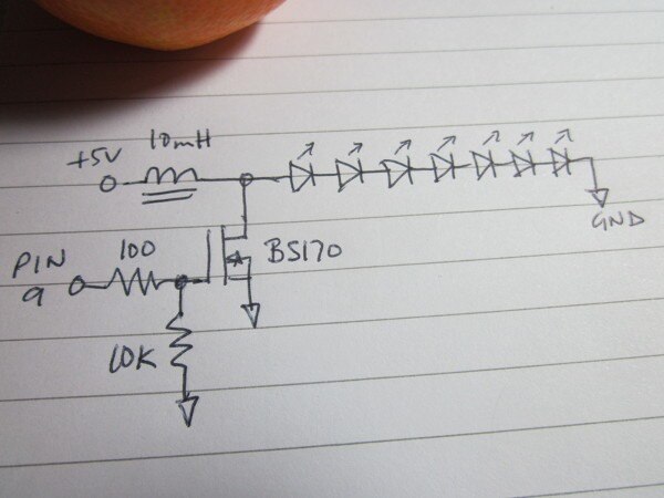

and here it is drawn as a circuit diagram

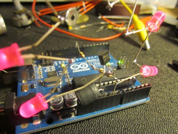

you can see how I just lashed the components together, without a breadbord or pcb, in this next photograph

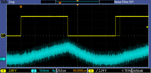

How does it work? The MOSFET is switched by the Arduino. Let's consider a time where the output has been low for a while
and is just about to switch high - the gate voltage (relative to the source) is very low and the MOSFET is off. When the
Arduino pin goes high, the gate rises to something close to 5V and the MOSFET turns on. That happens fairly quickly. When
the MOSFET is on it behaves much as a small value resistor would (in this case, a few ohms), so at that point we have 5V
across the coil. The current through the coil can't change instantaneously, instead it starts to ramp up with the rate of
change dependent on the inductance - I chose the 10mH value so that it would ramp to about 20mA in a few tens of
microseconds, a time period which we could control quite accurately with the processor on the board. If you look at the
waveforms below, you can see the ramp up of the current [yellow trace is the output pin, blue trace is the coil current].
As it ramps, energy is being stored in the form of a magnetic field around the coil. After 60uS, the Arduino turns off

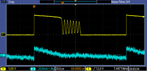

period. Repeating the process gives the illusion that the LEDs are on continuously. The next set of waveforms show the
voltage at the coil/MOSFET/LED node and the current that flows through the LEDs. As the current declines, the voltage
falls because the forward voltage of the LEDs depends on the current. When the energy stored by the coil is almost used
up, it no longer runs the LEDs but instead what's left of the energy moves back and forth from the coil to the
capacitance at that node [which of course includes the capacitance of the scope probe tip]. The ringing looks a bit
alarming but there's little energy there and it's not doing any real harm.
Sorry the current waveforms are a bit of a mess. The probe is a bit noisy and isn't that good with small currents.

    I couldn't resist doing a bit more with this, so I added two more strings of LEDs (with the LEDs all interleaved) and used MOSFETs to switch one string at a time into circuit giving a travelling pixel effect. The LEDs aren't very even and I needed a small piece of cardboard halfway round to stop them shorting, but it sort of works, if a bit slapdash.
