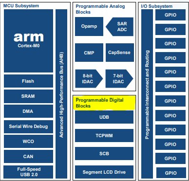

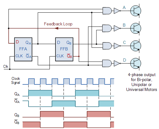

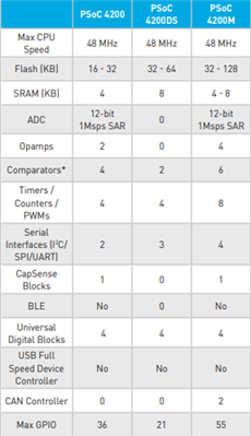

Starting off, I had heard about PSoC quite a bit and knew that it's highly configurable and can be designed application-specific. I started thinking about what could be done using digital logics and incidentally came across this article on the Johnson Ring counter and its application in stepper control. Ok, I had learnt a bit about that while on the Trinamic Stepper Driver RT and waveforms of the johnson counter looked familiar to coil firing sequence in a stepper. So, it's fully digital and relating with PSoC, woot! it had a UDB(universal digital block) consisting of all basic digital gates and units. So I put up an idea to design it without really knowing how to implement it!
  • Block Diagram and Features of PSoC 4200

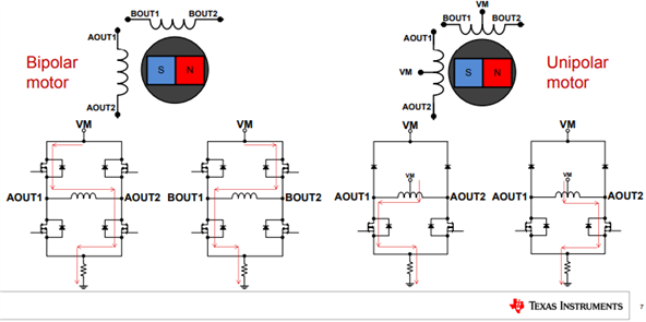

Now, why to design another fully digital stepper driver? There are tonnes of trending chips by TI, ST, ROHM, Infineon and not to forget, the Trinamic etc like L298N, TMC2209, A4988, DRV8825 etc. But, these are mostly H-Bridge based, power-hungry and heat-bleeding. Yet are suitable and needed for high torque and control applications.
  • Typical stepper driver configuration with MOSFETs

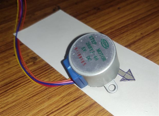

Here, I am looking specifically for 28BYJ-48 unipolar stepper motor and usage of the digital logic counter method to generate coil pulse sequence. Doing this would make the driver handy and easy to implement with a couple of flip-flops and logic gates. Putting it inside PSoC would be like a highly configurable driver and multiple ones can be designed inside one PSoC chip. No high heat dissipation, no exclusive driver chips like L298N is required and several driver logic can be implemented in a single PSoC chip(limited by GPIOs and UDB count though).
This was a sort of a cool thing and I decided to go hardcore with PSoC and try to get it running. Also, I loved doing stepper driver the other way and thought it would be a good learning thing for my motor stuff addiction.
  • Overall Plan - Block Diagram

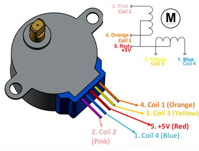

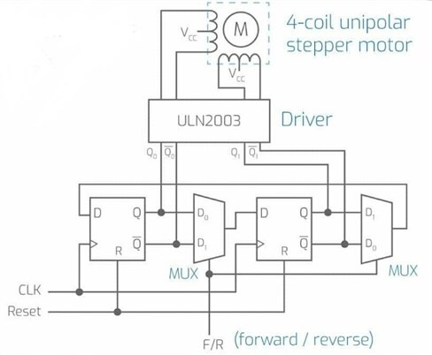

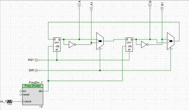

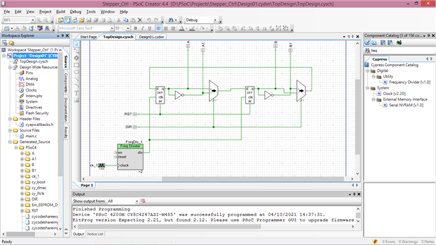

I found two ways to implement a unipolar stepper motor coil sequence generator. The first one is "Design02" which is a plain 2-bit quadrature generator and the second one, "Design01" is with two multiplexers(MUX) which facilitate in reversing the pulse sequence and thereby allow to change forward/reverse the direction of the motor. I now have to see how to implement both the designs in PSoC4200. The 28BYJ-48 unipolar motor has 5 wires one being Vcc from centre-tap of both the coils and others are A/A1 and B/B1 ends of each coil respectively. Some features:
  • Rated Voltage: 5V DC
  • Number of Phases: 4
  • Stride Angle: 5.625°/64
  • Pull in torque: 300 gf.cm

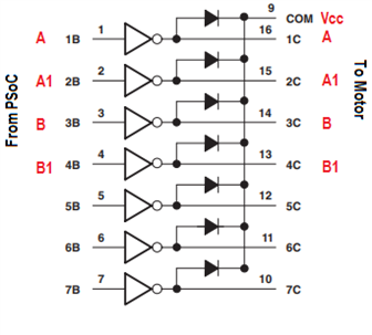

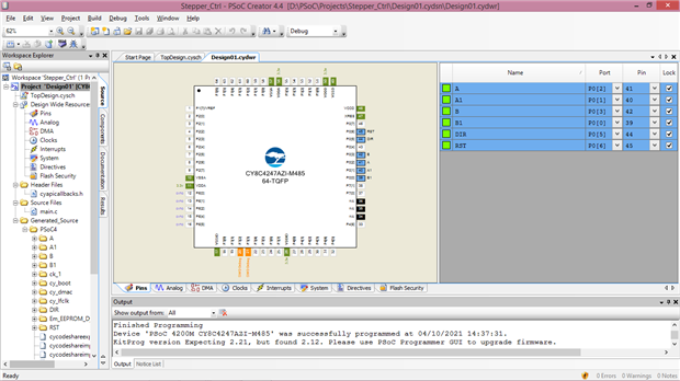

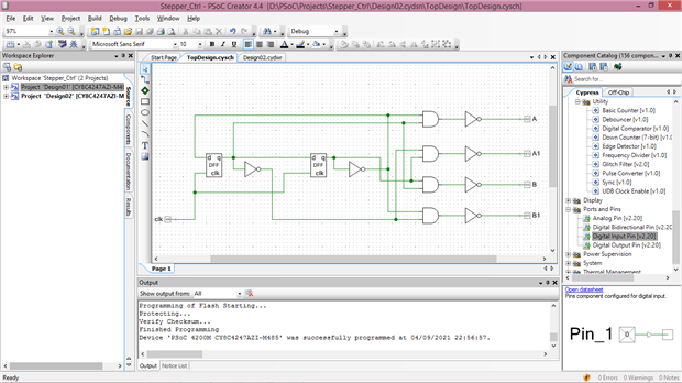

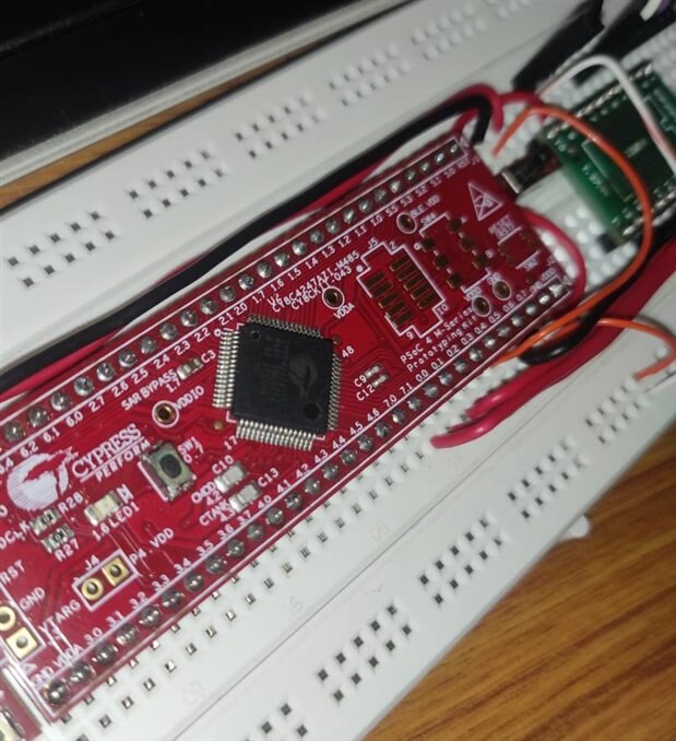

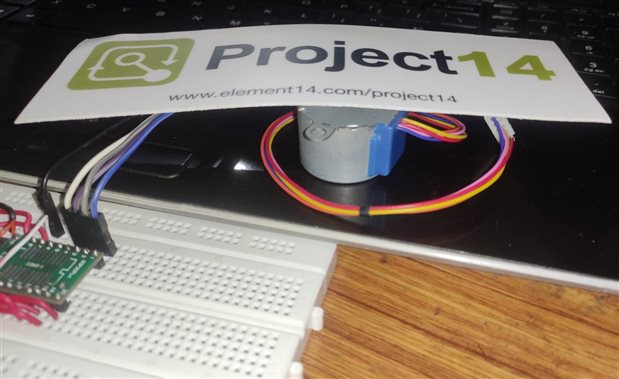

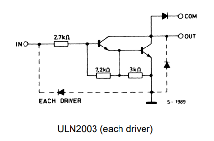

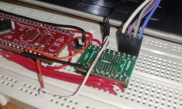

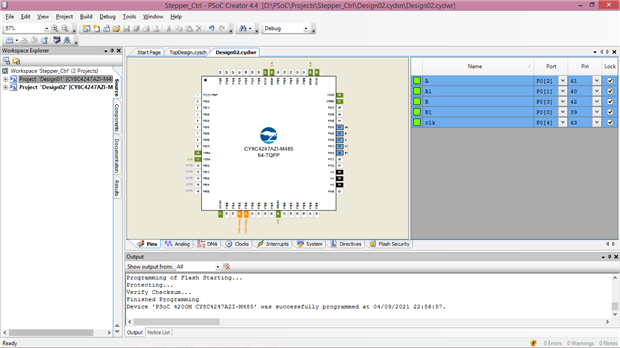

I made the first one first, Design02 on a PSoC. For the clock signal, I put a configurable clock block(48MHz default) and set it to a minimum of 1kHz. The GPIO of PSOC4200 won't be able to handle more than a couple of tens of mA and had to use some kind of high side driver for supplying the 420mA rated current of the motor. So, I used a ULN2003A darlington array IC for whose input A/A1, B/B1 are given and output is given to the motor pins.

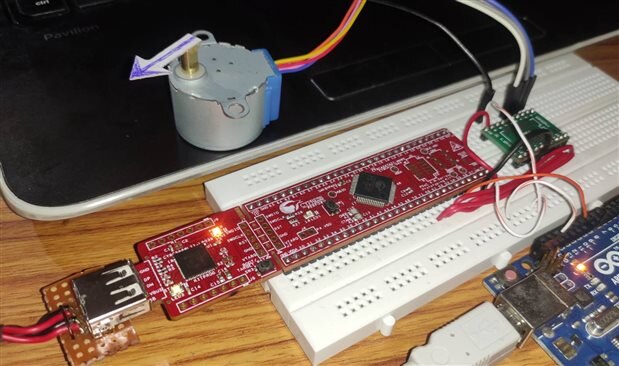

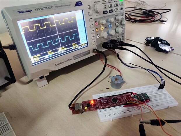

After assigning the pins and downloading the design to the PSoC, nothing seemed to work. The motor was buzzing slightly and heating up a lot. I waited, went to my university lab to get an oscilloscope and checked for the waveforms from pins A/A1/B/B1 pins of the PSoC. They looked fine and were complementary to each other as required by the motor. I checked the frequency and was close to 1kHz as assigned in the design. Later after tinkering a lot, I found it was overclocked or infact, the frequency of 1kHz was too high for the coils and didn't slip out and rotate. So,....with PSoC I dodn't know how to go below 1kHz as lower ranges aren't possible directly as the maximum possible divider is 65536 for a 48MH onboard one(clock dividing is a choice? let me know, I wanna try)
Time being, I pulled out the clock pin through one of the GPIOs of PSoC P0[4]  and used Arduino UNO as a clock source giving 500Hz.
{gallery} Design02 - Stepper Driver
This code generates a 500Hz clock signal through pin13 of Arduino. I tried lower and higher frequencies too(10Hz, 100Hz, 1kHz etc) but 500Hz seems to be a good tradeoff and there isn't overheating of coils. The speed of the motor can be controlled by the frequency of the clock signal. Too slow at 100Hz and running well at 500Hz.

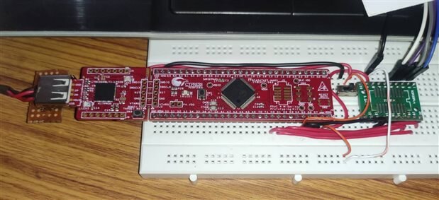

Now, I thought of having the direction control too for the motor! So, I added two MUX with one being fed in a reverse coil firing sequence so that when I toggle it, the complementary waveform goes to the motor which inturn changes the motor direction.
I actually wanted to have the clock within the PSoC itself. After reading this Prototyping with FPGAs - Part 3 - Sequential Logic with Quartus Prime on Cyclone-IV FPGA insightful blog by yesha98 I thought of using clock divider method for the internal 48MHz one to get 500Hz. Eventually, I found that PSoC has a Frequency Divider block FreqDiv_1 and plugged it in with a division factor of 2 for a 1kHz signal (that's the minimum I could get).
{gallery} Design01 - Stepper Driver
Grrrrrrrrrrr........goes the motor and rrrrrrrrrrrrG....... when the direction is reversed! The gear ratio is high in this 28BYJ-48 unipolar stepper and hence it always runs slowly but with higher torque.

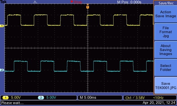

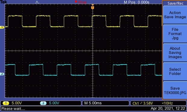

Quick update! Finally, I got a chance to look through the scope at my univ!
Looking through pin 0[1] which is A1 and 0[3] which is B in final design.
For clockwise rotation:
For anti-clockwise rotation:
A 90-degrees of phase shift is seen in the anti-clockwise control signal compared to the clockwise control signal. This shift in pin B of the stepper and signal A1 is intact.
