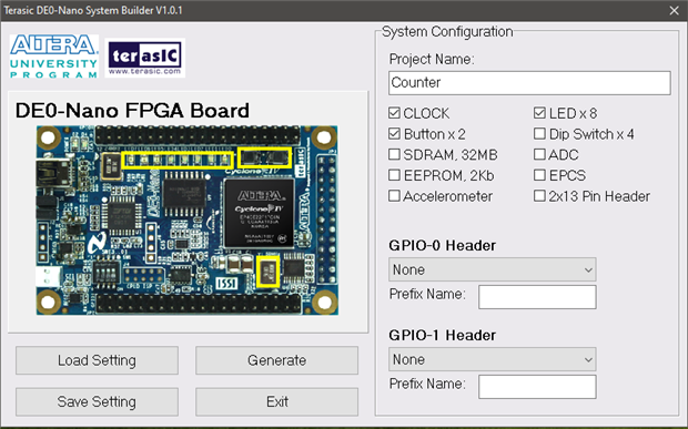

Open Terasic System Builder and do the following steps:
{gallery} SB

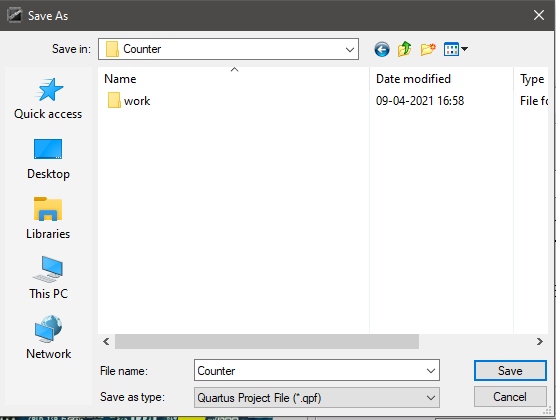

Open Terasic DE0-Nano System Builder and select required system components

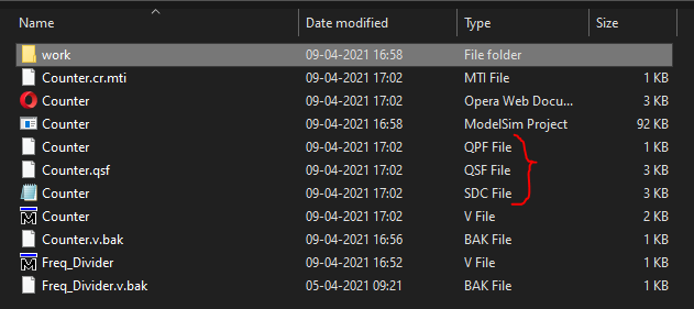

Save the generated files in project Directory
Generated Files
Now the required files such as the Quartus Prime Project File (QPF File), Quartus Prime Settings File (QSF File), and Synopsys Design Constraints File (SDC File) are generated in the project location.

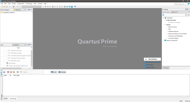

Getting started with Quartus Prime:
{gallery} QP
Open the project from Quartus Prime

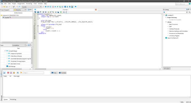

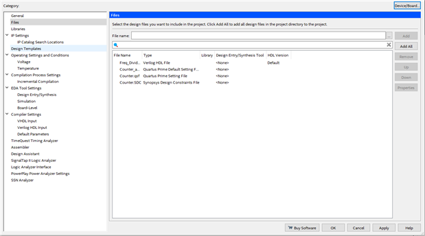

Write the program for frequency divider and Counter
Add other files which are required for the design

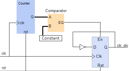

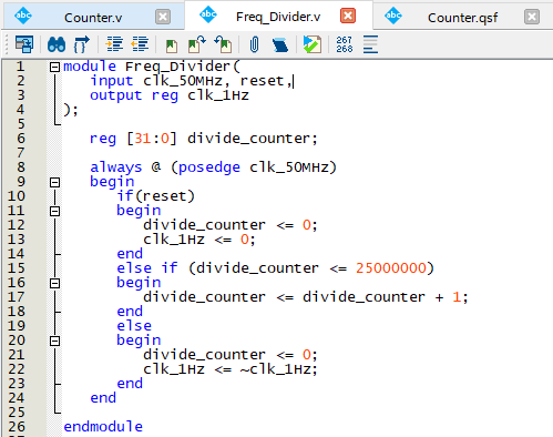

Design of a frequency divider:
Verilog code:
The constant value here is 25 Million (where onboard clock = 50MHz), which signifies 0.5 seconds ON and 0.5 seconds OFF time of the 1Hz clock.

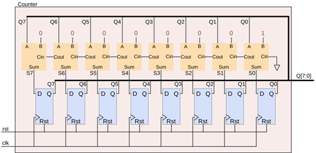

Design of 8-bit counter:

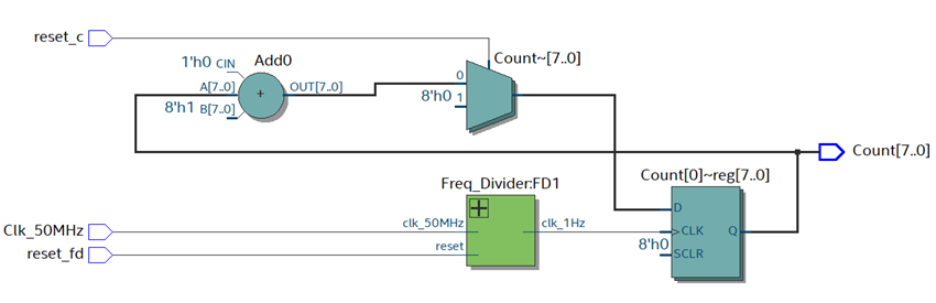

As you can see, the design is pretty simple, a series of flip-flops that store one bit of data and a full adder as discussed in Part 2 of the blog series.

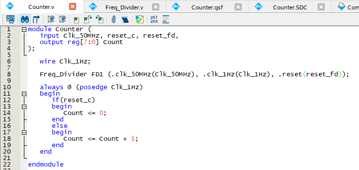

Verilog Code:
Here the module Counter has the 50MHz onboard clock as the input thus we divide and reduce it to a 1Hz clock by feeding it to the Frequency divider module by instantiating it (see line 8).

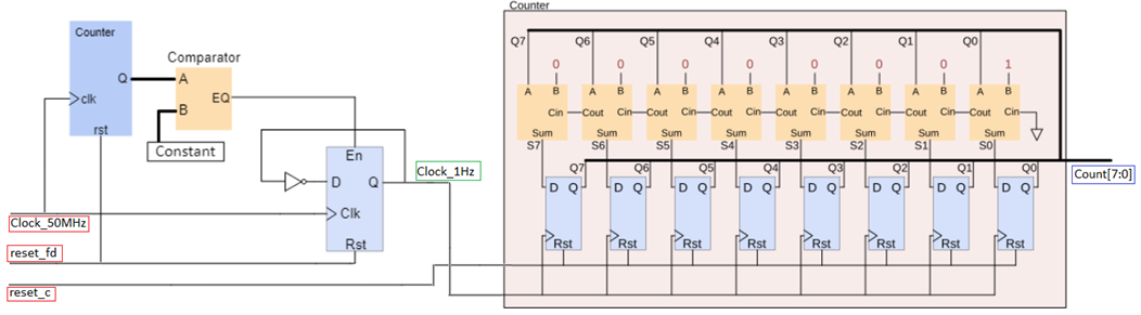

Complete Design (Expected):
Synthesized:

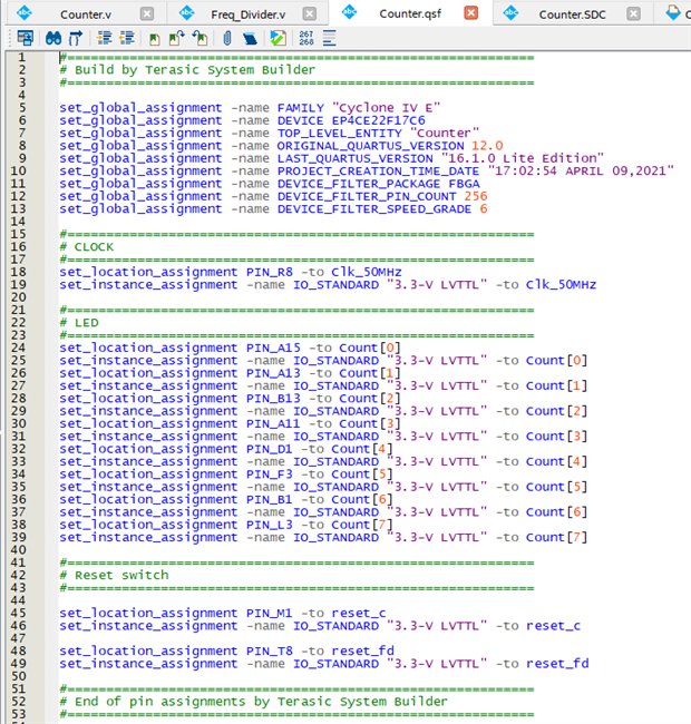

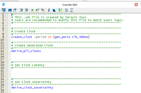

Now it's time to write the constraints file for design implementation.
Constraints file:
SDC File:

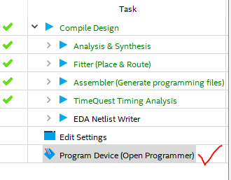

As we have Synthesis, Implementation and bitstream generation in ISE, it's called as Analysis & Synthesis, Fitter and then Assembler in Quartus Prime. Apparently, all do the same job.

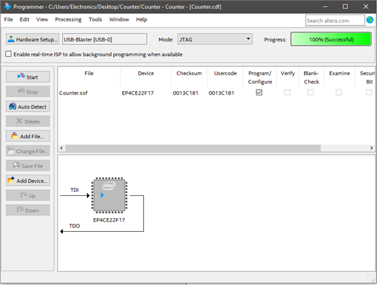

Hit compile!

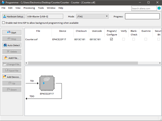

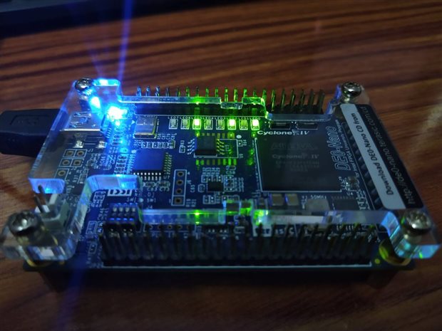

Then Open the Programmer and then click on Start.
Then it'll show the successful message once the device is programmed.
As the 8-bits of count is tied to the onboard LEDs (check constraints file). Thus, the output can be viewed onboard!
Output:
