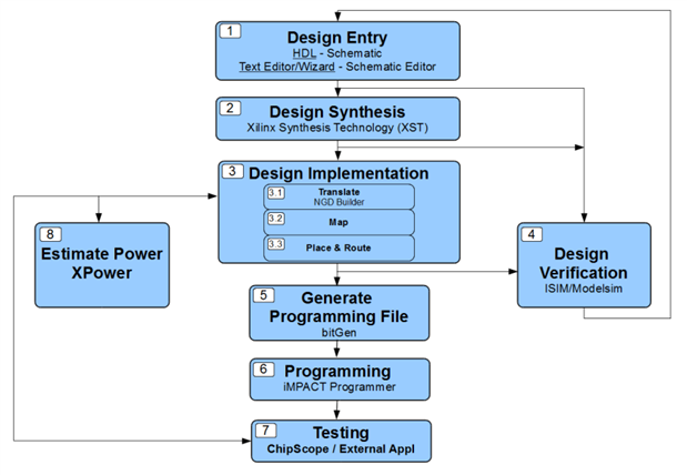

FPGA Design Flow:
Let's look at the first step
1. Design Entry:
FPGA Design entry can be done in two ways, either through an HDL which stands for Hardware Description Language - which is the most common method or through schematic entry wherein one can drag & drop and connect various blocks together or integrating both.
We shall discuss the design entry by exploring the Xilinx ISE!

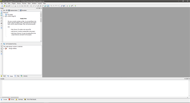

Getting Started with Xilinx ISE:
{gallery} ISE

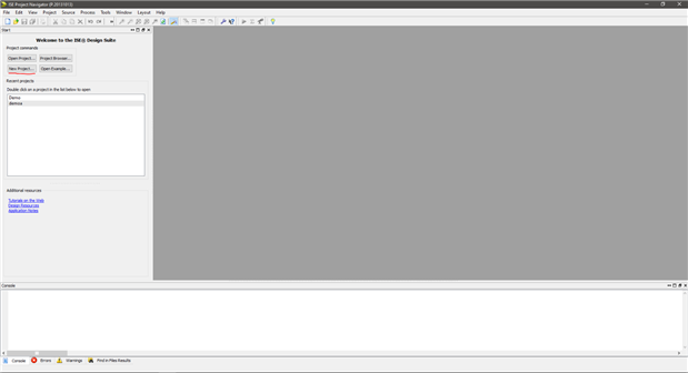

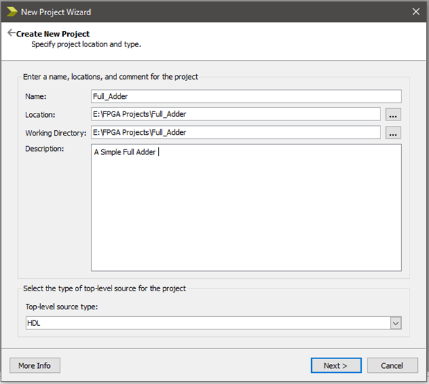

Launch ISE and create new project
Name the project (spaces not preferred) and specify location

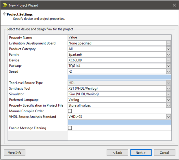

Select Target device, speed grade and HDL language

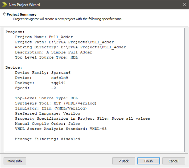

Finish
Project created successfully.

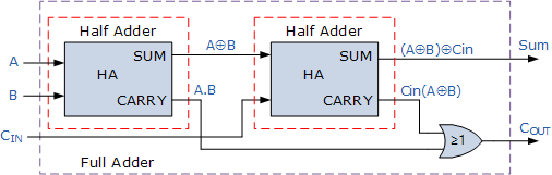

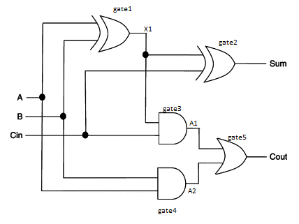

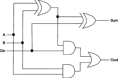

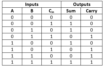

Full Adder Circuit (Logic):
The functionality of the circuit is pretty simple, it adds 3 bits and gives the sum and carry output.
The truth table of full adder:

a) Structural: Where you describe the structure of the logic circuit in terms of gates, sometimes also called Gate-level modeling.

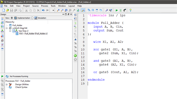

a) Full Adder Implementation using Structural modeling in Verilog:
module Full_Adder (
     input A, B, Cin,
     output Sum, Cout
     wire X1, A1, A2;
     xor gate1 (X1, A, B),
         gate2 (Sum, X1, Cin);
     and gate3 (A1, A, B),
         gate4 (A2, X1, Cin);
     or gate5 (Cout, A1, A2);
endmodule

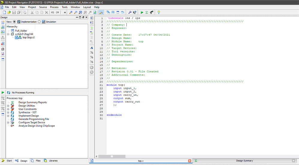

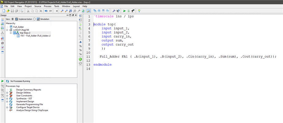

A top.v file (when Verilog is used as design language) is used to instantiate all the modules in a single top-level design in a Hierarchy.
{gallery} Creating a design

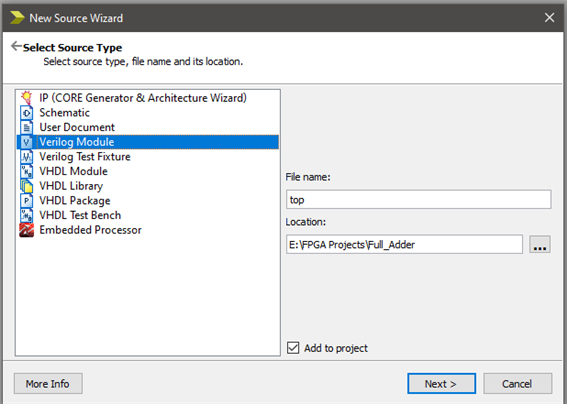

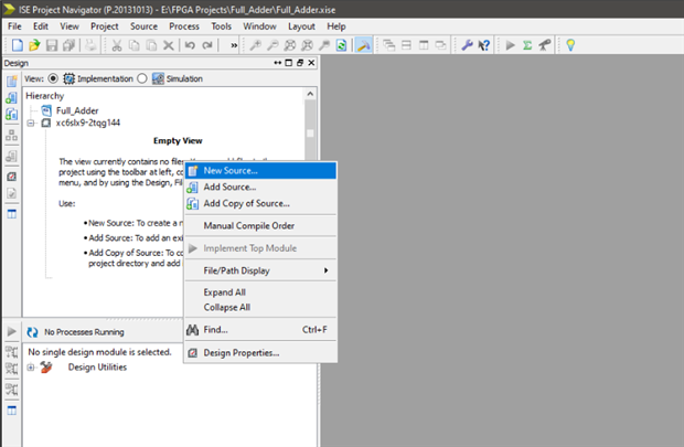

Add a new Source
Select Verilog module and name it top

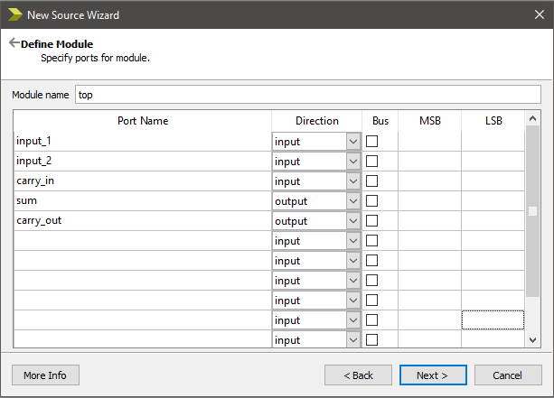

Select the inputs and outputs and name them
The top module will now be created
Add a new source that has the code of the full adder
Instantiate the full adder in the top module.

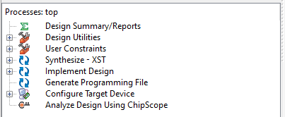

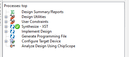

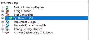

2. Design Synthesis:
During the FPGA synthesis process, a high description design or an HDL design is converted into a gate-level representation or a logic component.
Now Synthesize the design

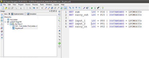

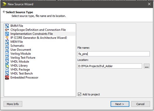

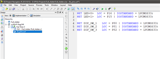

Once Synthesis is complete we need to add the constraints file to map the pins of the FPGA with the logic elements.
Create a new source and select constrains file in the options and give it a name.
Almost all the FPGA development board Vendors provide a master constrains file which contains all the pins and their mappings to the FPGA.
Copy and paste the pins that you want for your project, for instance, the 2 LEDs for Sum and Carry, then 3 switches for 3 inputs.

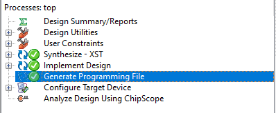

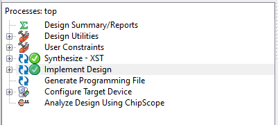

3. Design Implementation:
Now it's time to implement the design.
The Implementation tool will take the netlist as input and does optimization, placement, and routing.

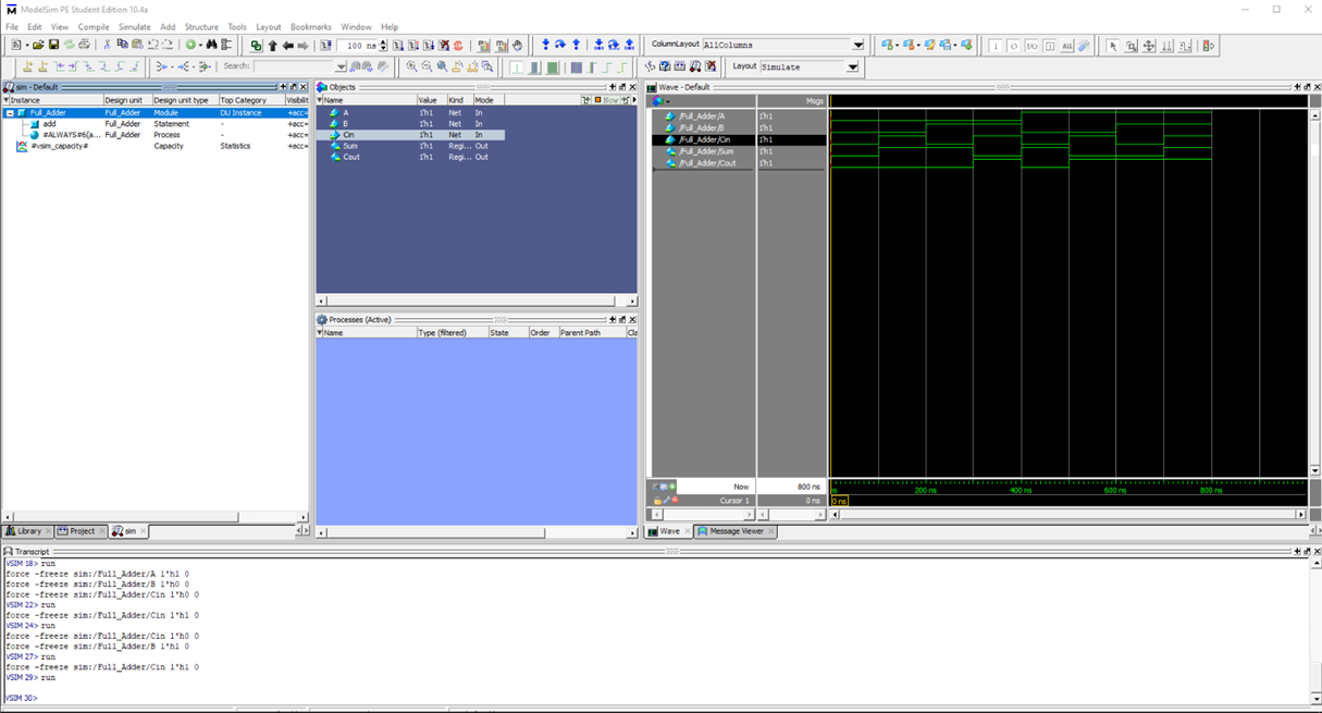

4. Design Verification:
This is a simple full adder design, thus it does not require verification, yet it is a good practice to do so. The design is verified using Modelsim

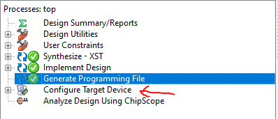

5. Generate Programming File:
The programming file is used to program the FPGA. This file contains all the information of the design implementation which is specific to an FPGA.
image  image

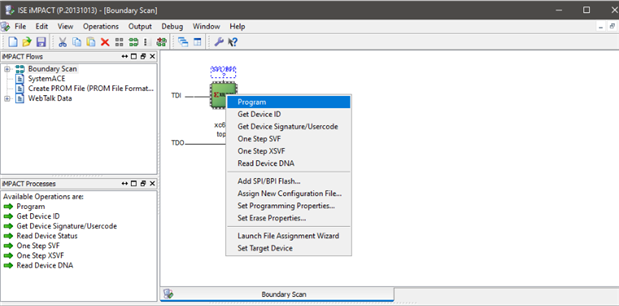

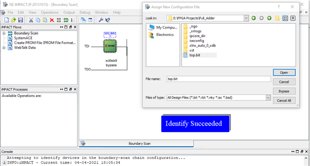

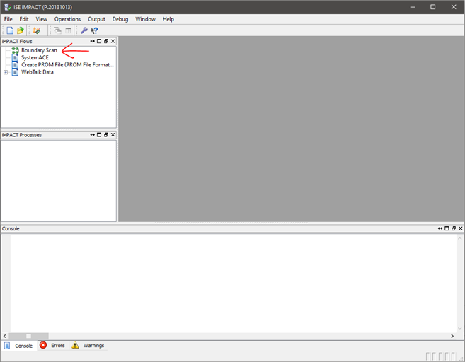

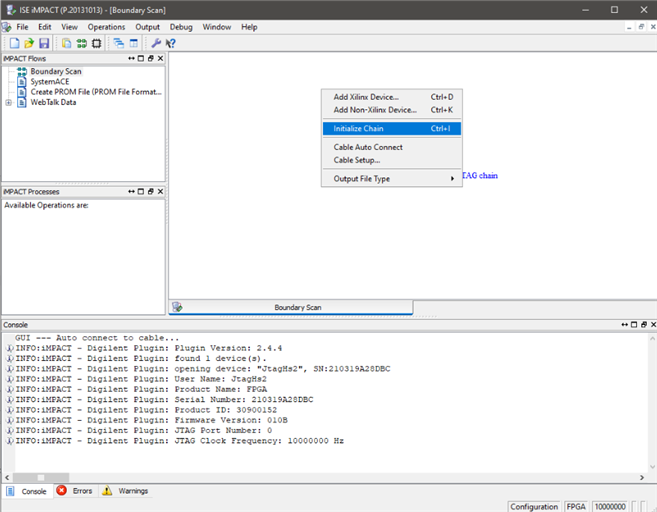

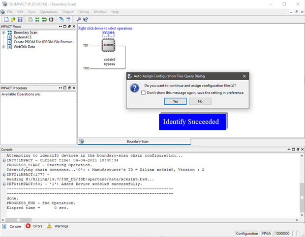

6. Programming:
Xilinx ISE has a specific tool called iMPACT which is used to program the FPGAs.
You'll get a warning asking to create an iMPACT file, click OK. Then the iMPACT tool will open, then click on Boundry Scan and then Initialize Chain.
{gallery} My Gallery Title
Click on Boundry Scan
Initialize Chain

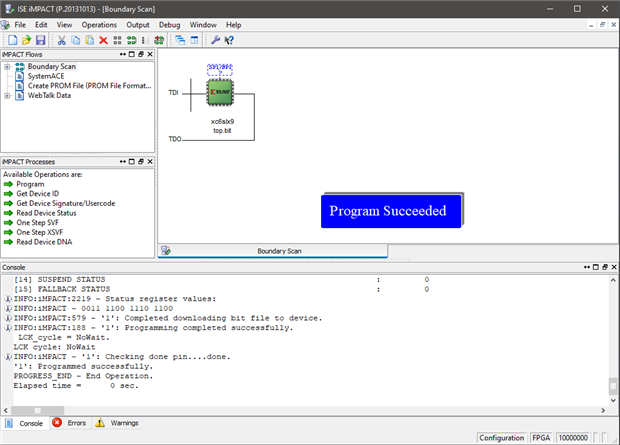

Select the bit file
Program the device!
Output:
