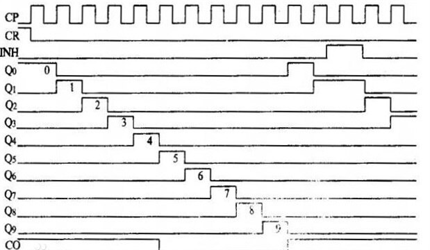

Basic digital circuit can start with 555 time
While CD4017 Decade counter can drive 10 output  and it can count from 0 to 10 with internal logic
The output waveform shall be,

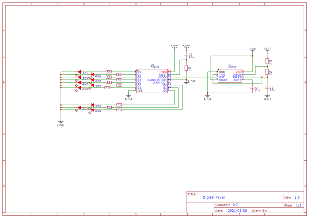

2 Schematic Drawing
When NE555 time give timer pluse, the CD4017 can drive the LED on the ring one by one. Here is the schematic drawing.

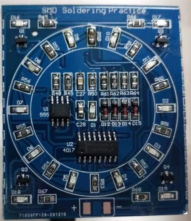

3 PCB and Design
Here is the final result for the PCB and design. NE555 in SOP8 and CD4017 in SOP16
4 Summary
Q1~Q4 are thyristor to allow wider range of input voltage, this part is not show in shematics. D1 is inverted signal for D1~D10 around the ring.
This make the leds blink around the ring  one by one.

  • ntewinkel
    ntewinkel over 5 years ago +4
    Great explanation of how it works, thanks. Those practice soldering kits are really nice to try soldering the tiny smd parts, aren't they? Did you get yours to work? What is the voltage it should run on…
