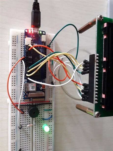

I'm proud to share my music jukebox project using the Arduino MRK Vidor 4000. It is my first project entirely using Verilog HDL!
Hardware Build
These are my connections on a breadboard.

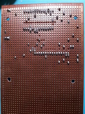

After that I soldered it onto a veroboard to make it permanent.

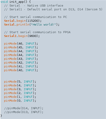

Firstly, I made this Arduino sketch to set all the pins to inputs. As I will be using the FPGA only, I do not need the microcontroller pins and by making it an input, it will prevent shorting the FPGA output to the microcontroller output. I also added Serial pins as later I will be using it for testing.

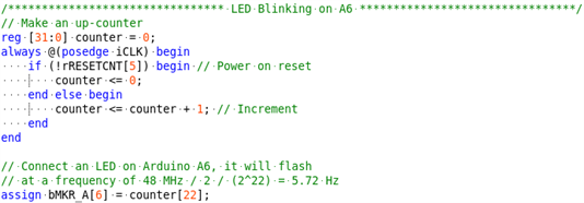

First I tried a flashing LED on pin A6. The clock is 48MHz from the SAMD microcontroller. In this case I made a counter and it used the 22nd bit.

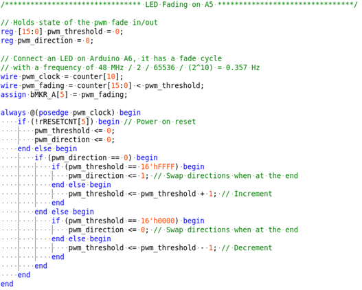

Next I made a PWM fading LED on pin A5.
As you can see, both codes run simultaneously and my main struggle when I first started was understanding that the FPGA code is similar to building actual hardware.
ie. Important to think in terms of sequential circuits, state diagrams and combinational logic

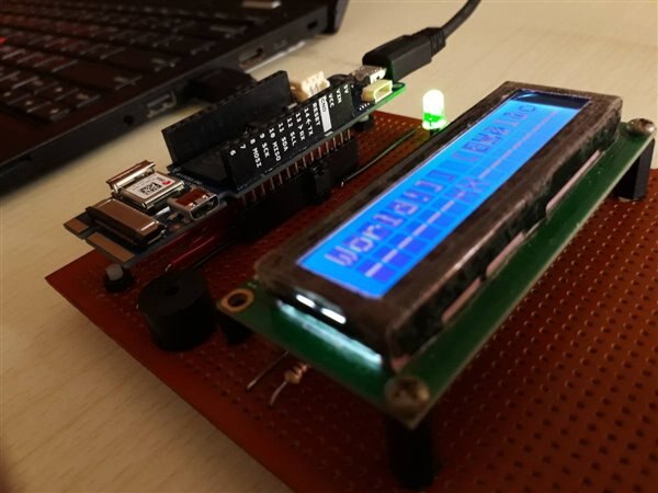

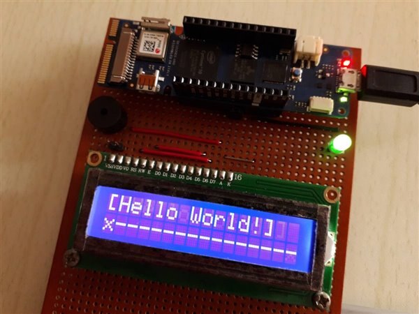

Code is getting pretty long so I wrote it into a separate Verilog file for the 16x2 Character LCD display.
It was challenging too to make the sequential logic and scrolling text across the screen.
Lastly I added a UART module so that I can send commands from my PC
After playing around with the devices separately. Finally, I merged the code together to make the musical jukebox.
