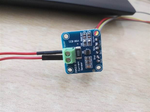

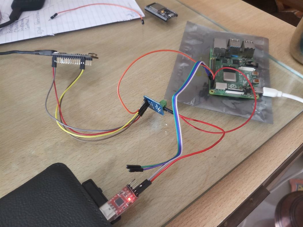

This is my first blog for the DIY test and instrumentation challenges. I am going to build a tiny meter for measuring DC current, Voltage, Power, etc in the range used by small devices.
The measurement of current is always a bit challenging, as we have to measure them in a series circuit. The measurement is not possible usually without breaking a circuit, inserting some
wires for the measurement.
There are some direct methods used with creating a common ground between measured device and measuring device with the help of a register between them. Bur such meathods are
never so much reliable due to the use of common ground, which might make systems unstable.

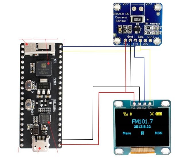

The sensors could help to solve this challange. Sensors such as INA219 from Texas Instruments operate on an I2C bus configuration which makes it possible to measure live current.
In this project, the first part was to interface this sensor with MCU. I am using ESP32 as of now with Arduino IDE due to their ease of use and capability for remote monitoring over the
internet.

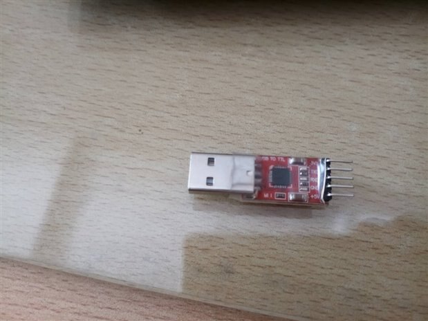

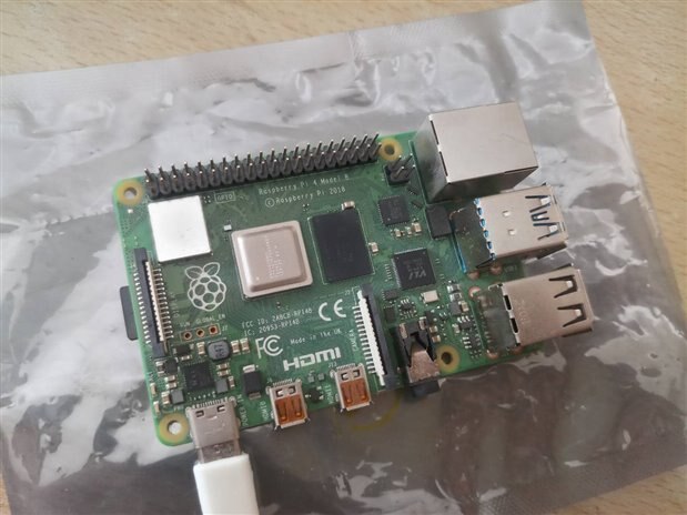

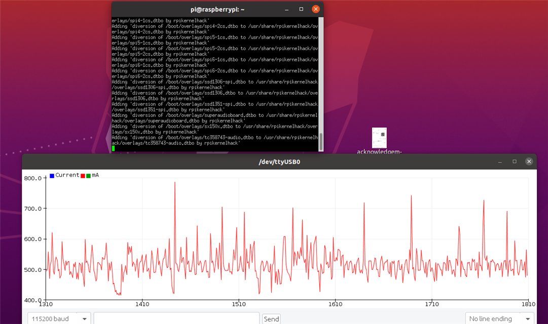

The challenge I faced here was to power up the raspberry pi via GPIO using a USB to TTL converter. The RaspberryPi is not starting and also the measurements are not showing up. I will find a solution as I go.
Now, I have got the solution to power up the RaspberryPi via GPIO. The thing is that it is required to use both GPIO 2 & 4 to supply 5V power & GPIO 6 to supply ground.

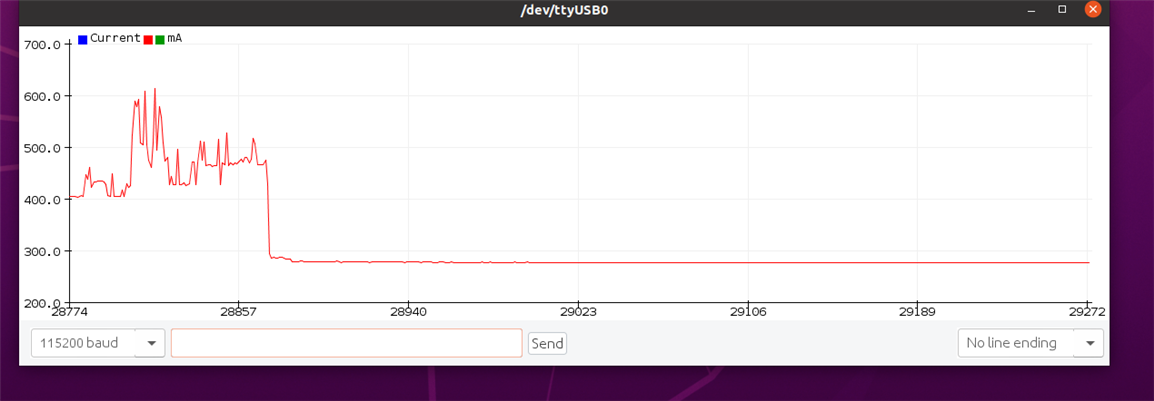

The following image shows the Pi running sshed via Putty and updates, the graph is the plot of current cunsuption in mAmps by Pi, It reaches at max. around 900 mAmps only sometimes.
It remains around 500mAmps normally.

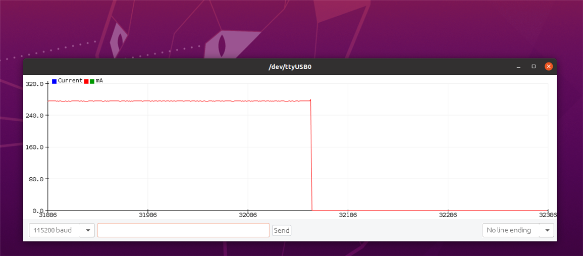

When the RaspberryPi is powered of with
sudo shutdown or poweroff
commands still there is some power required by the status LED and other internal functions. If we unplug the cable then the power comsumption will be near to zero, as from the following screenshoots.

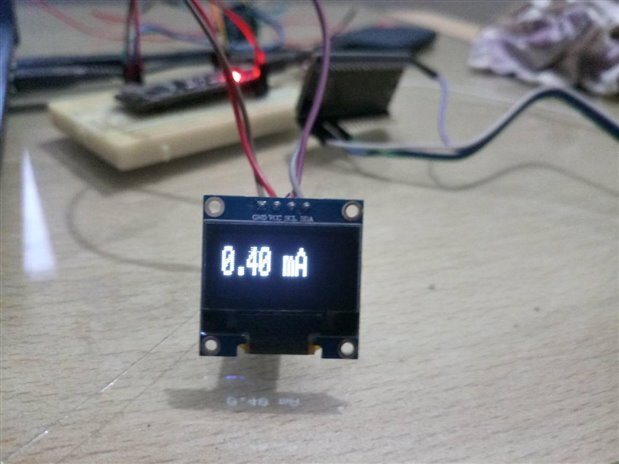

There is still some time before this contest closes. I would love to add a small display that could show live the data for power monitoring. For now, I only have an SSD1306 LCD display to make it work.
