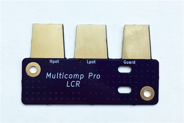

In this post, I present a DIY 3D printed adapter for 4-wire Kelvin measurement of SMD components with an LCR meter.  The adapter has been tested with the Multicomp Pro handheld LCR meter (rebranded Hantek 1833C) and should work with the DER DE-5000 LCR meter.
In previous posts, I’ve presented Kelvin clamps and SMD tweezers for use with the Multicomp Pro LCR meter.  This new design was inspired by a comment Jan Cumps made in the post on Kelvin clamps. My friend Adrian also made suggestions and modified the PCB so that it can be used with both the Multicomp Pro or DER meters.

Revising the PCB
Thanks to Adrian for revising and testing the PCB so that it can be used with both the Multicomp Pro and the DER LCR meters.  Note that the DE-5000 contacts are reversed from the Multicomp Pro but the PCB can be flipped over and used.  The ends of the “fingers” were tapered and the PCBs made 0.8 mm thick which allows easier insertion into the DE-5000.  The modifications work equally well for the Multicomp Pro.
The PCBs were manufactured at OshPark and can also be used with the earlier 4-wire Kelvin clamps.
I subsequently made a second version with the PCB trimmed a bit in width and the mounting holes symmetrically placed to allow a smaller enclosure with the SMD adapter.
