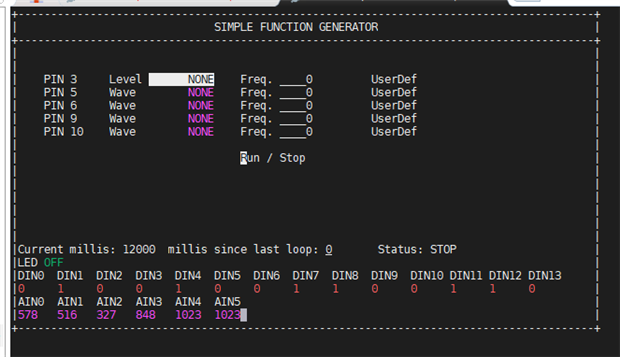

The user interface
With the above-mentioned components, I created the following forms

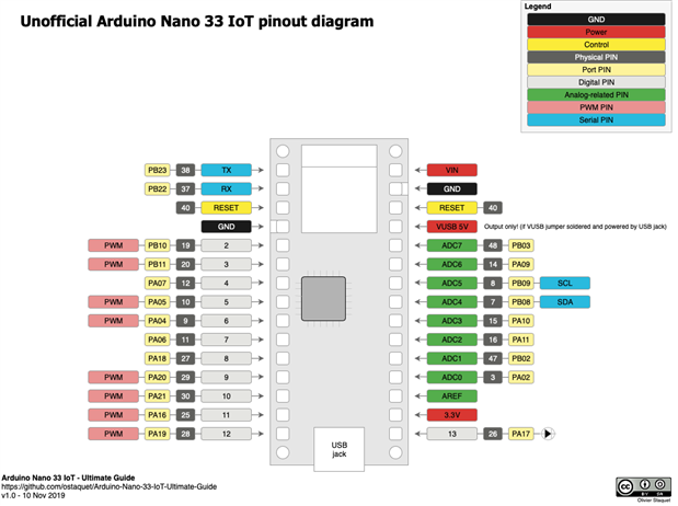

At the top, there are 5 lines to configure the function to generate on each PIN. In this case, I am using a Arduino Nano 33 IoT and I selected 5 of the pins that support PWM.
https://github.com/ostaquet/Arduino-Nano-33-IoT-Ultimate-Guide
From the combo box, you can select the waveform to generate, namely
  • None (pin not used)
  • Square
  • Triangle
  • Sawtooth
  • User defined
For square, triangle and sawtooth, one can enter the desired frequency. Note that the square waveform is not generated using a PWM, but by driving the pin
Triangle and sawtooth waveforms are generated using PWM and the TurboPWM library. More details are below

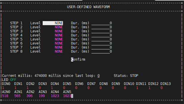

"User defined" waveform is created as a sequence of "high" and "low" logical states. Such steps are configured by means of the following form

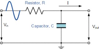

I am going to use a passive filter, because I expect to have loads that takes less than 10mA. So the circuit for the low-pass filter is very simple:
The cut-off frequency is given by the formula
When designing the low-pass filter, there is a fundamental trade-off to consider:
     A lower cutoff frequency means less ripple and longer settling time; a higher cutoff frequency means more ripple and shorter settling time. So we have to think about your application and decide if you want a DAC that is more responsive or less subject to output ripple.
I will configure the PWM to have a frequency of 2 kHz
  pwm.setClockDivider(1, false);
  pwm.timer(0, 1, 750, false);
  pwm.enable(0, true);
and I will design a low pass filter that about 10 Hz. With R = 6,8 kOhm and C = 2.2 uF, the cut-off frequency is 10,64 Hz, which is good

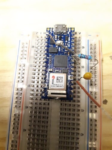

The final setup is shown in picture below: I have just the Arduino Nano and the low-pass filter
This is the output for a 10 Hz triangle waveform
Looks good, but the ripple is quite high (about 100 mV)
Here is video with the SSFG in action
Conclusions
The final outcome of this project is not very satisfactory and a lot of work needs to be done to implement a better low-pass filter and to shift level of the waveforms (the desired RMS value for a sine wave is 0V...)
