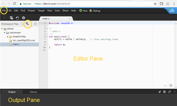

Go to File->New CCS Project and give the project any name (e.g. tachometer) and for the Device field select MSP430Gxxx Family and MSP430G2553.
You’ll see that the CCS Cloud environment has created a file for you called main.c and it has a basic main function already inside in the editor pane. It will look like this:
As a test, click File->Save and then click on the Hammer icon which is used to build the code into an executable file. The text in the Output pane will indicate Finished building: tachometer.This proves that the compiler is functioning. In order to download the code into the microcontroller plugged on the development board, all you need to do is click on the Run icon. The first time you do this it may download and install a little helper program to perform the transfer, and subsequently you don’t need to install anything to the PC.

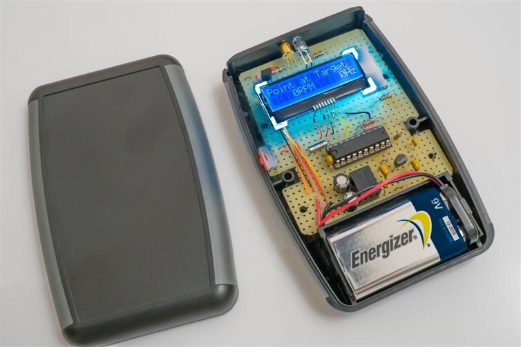

There are different ways to build the circuit; for example using isolated pad proto board, or using a printed circuit board (PCB). To build it on a PCB, the computer aided design (CAD) files are sent to a PCB manufacturer; the typical cost is $20 for 10 boards. One PCB manufacturer is iTead, but others offer similar prices and results too. To use iTead, search for their PCB prototyping service, and purchase their 2-layer 10x10cm board option. Then go into your iTead account order and click on 'View Order' and there will be a button to upload the CAD files. The PCB CAD zip file for this project can be downloaded from github and uploaded to iTead as a zip file. That’s it! The PCBs should arrive within a week or two.
I initially built mine on isolated pad proto board. To start off, the power supply circuit is built. It can be verified by plugging in a battery and using a multimeter to confirm 5V and 3.3V outputs are functioning.
Next, the optical portion of the circuit is constructed. It consists of an infrared LED, and a photodiode circuit that amplifies the received signal and then provides a high/low logic output. The output is inverted and converted to a 3.3V logic signal using the Q1 transistor.
To test this circuit with a multimeter, placing white card to cause a reflection should result in the signal output from Q1 to change from high (3.3V) to low (0V). Careful adjustment of the angle of the LED should allow for a reliable distance of about 10cm from the target using a white card target.

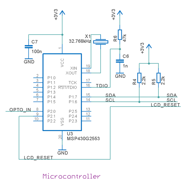

The output from Q1 is connected to the microcontroller. The microcontroller circuit consists of a 20-pin DIP socket for the MSP430 series microcontroller, a reset circuit (R6 and C6), a 32.768kHz crystal, a supply decoupling capacitor (C7) and two pull-up resistors (R4 and R5) which together establish an I2C serial bus.
The microcontroller that was programmed earlier can be plugged into the 20-pin socket once the entire circuit has been soldered.
The final part of the circuit is to attach the LCD display.
And that’s it! The circuit is very simple. Plug the microcontroller in, connect a 9V battery and everything should work. The LCD display will prompt you to point it at a rotating object and the display will automatically indicate the RPM value and the number of rotations per second too (in Hz).
