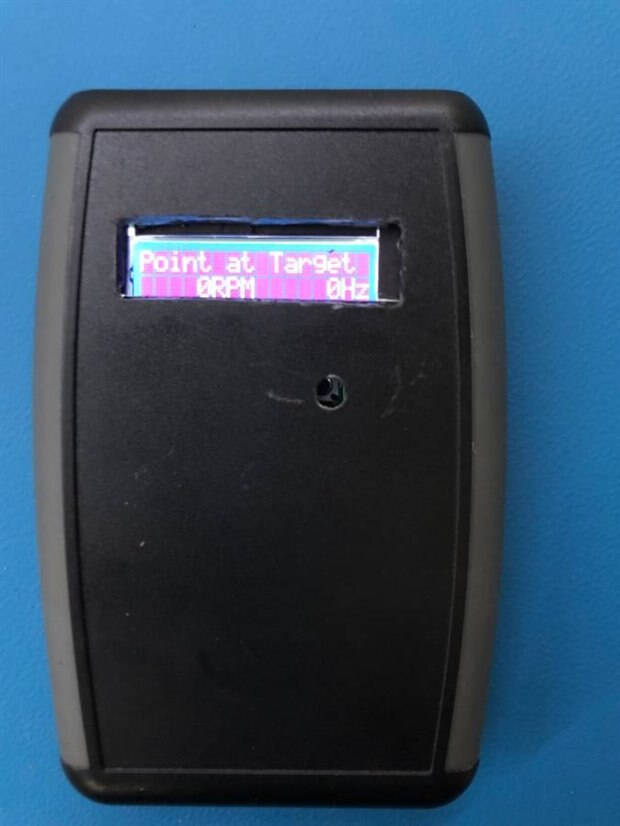

Final Test and Assembly
The project functions to speeds beyond practical limits for rotating objects. To prove this, I pulsed an LED at known frequencies and pointed it at the sensor. It worked to beyond 15,000 pulses per second which is close to 1 million RPM. The entire project fits in a handheld casehandheld case; a window will need to be cut for the display, the optical parts and the power switch. Alternatively a 3D printer could be used to create something suitable.
The window was cut to be larger than the text display area, so that the text would be visible from an angle too.
The window was fitted with a neutral density filter. This was glued on the inside of the case. For the push-button, I deliberately drilled a bigger hole so that a plastic cap that I had lying around (it wasn't designed for the specific push-button that I used) could fit. Other cylinder shaped plastic pieces could be used.
It turned out that I didn't need to glue the cap to the push-button; it just sits on top loosely, and is fitted with a lip (I used a grommet) around it so that it won't drop out of the case. Since there is a lot of light bleed from the sides of the LCD, I cut a black piece of card to act as a surround and lightly glued it down (I used 'glue dots' so that it can be easily removed if necessary).
Here are some final photos of the assembled device:
