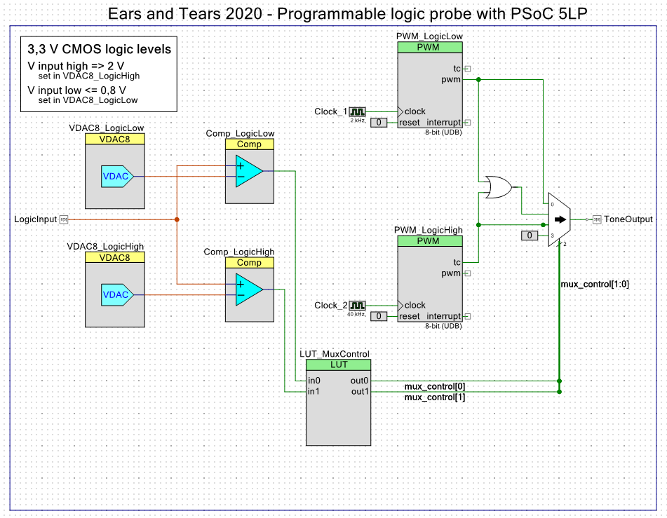

Below is the schematics of the whole circuit. I decided to power the circuit by a 3,3 V, meaning it can serve as a programmable logic probe for voltage levels of 3,3 V or lower.
I downloaded a 74LVT125 datasheet to get the LVT families logic levels:
High-level input voltage Vih is supposed to be minimally 2 V.
Low-level input voltage Vil is supposed to be maximally 0,8 V.
Jon has described his circuit very well, so I am just going to list the differences / PSoC 5LP specifics:
  • LogicInput pin is connected to the voltage tested and TonOuput to a buzzer or a speaker.

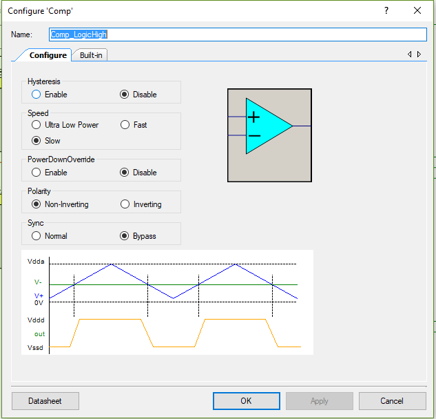

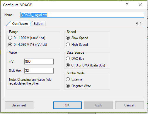

  • There are two VDAC components and their purpose is to generate a reference voltage for the comparator. These components are programmable in a PSoC 5LP and I have chosen a range of 0 - 4,080 V (16 mV / bit), however, as I am powering the circuit by Vdd = 3,3 V, the maximum reference voltage generated would be Vdd. (The good thing is that PSoC Creator makes you aware of this fact, so it's not a surprise for starting engineers / makers.) One VDAC is set for logic low level 0,8 V and the other for logic high level 2,0 V.
  • VDAC outputs are fed into the inverting inputs of the comparators. Input of the logic probe is fed into both of the comparators, but to the non-inverting inputs. The comparators have to decide then, whether the logic input is lower than Vil (and obviously Vih), between Vil and Vih, or above Vih (and Vil, of course). There is one hypothetical fault condition, that the high voltage level comparator will output a logic high, while the low voltage level comparator will ouput a logic low. I hope this won't happen, but the situation will be taken care of by the sound signaling part of the circuit. By the way, the comparators' synchronization is bypassed, so they don't expect to be clocked.
The rest of the circuit is used to produce a sound output so the user has an idea of the voltage level measured.

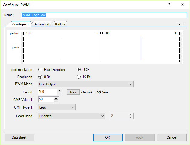

  • Two PWM modules are used to create two sounds with a different frequency, one for logic high and one for logic low.
  • As you probably noticed, there is an OR gate mixing both of the PWM outputs together. This was just found by an experiment to create a sound that would differentiate from logic low and logic high sound. This could definitely be done many other ways, using more internal PSoC resources.
  • All the outputs are fed into the multiplexer and the meaning is to provide separate channels with all the possible sound outputs, so only one sound buzzer is needed. (This probably isn't the smartest description of a multiplexer usage, right?) The multiplexer has four inputs, the last is not needed, so I connected it to a logic 0, but this input is never used.

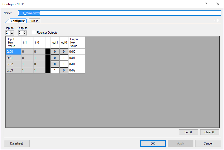

  • The fun part is the control function of the multiplexer. We have two comparator outputs and their output combination tells us in which boundaries is the input voltage. This is where a lookup table (LUT) comes in. It is basically a definition of a discrete function. We have two inputs (4 possible states) and need two outputs for controlling which frequency output will be connected to a buzzer. Here is the definition:
As I mention before, state 0x02 should never happen, but it's output is the same as if the voltage is between the voltage levels of logic low an logic high. This means that the weird sound produced is "not defined voltage level" or "logic probe is broken" image

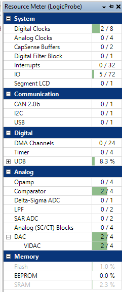

Here is a screenshot of PSoC 5LP resources used. Please note that the majority of RAM is usually allocated for a stack and heap and can be reduced if not needed.

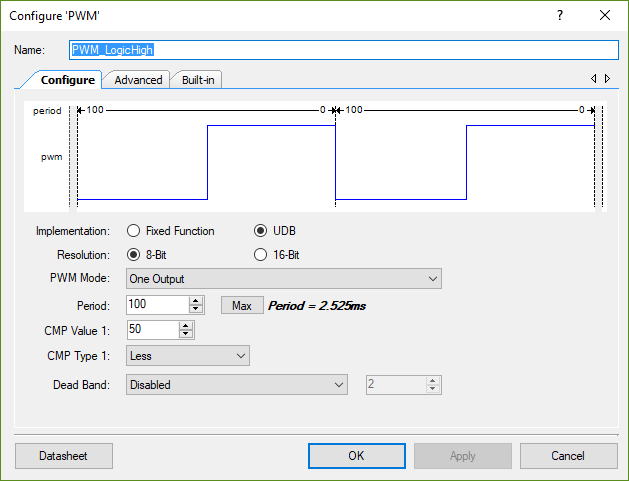

    I've just noticed that your low tone is extremely low (at least in the screenshots). A period of 50.5mS is a frequency of 19.8Hz. It's right at the limit of what you can hear as a continuous tone rather than a series of clicking noises.
    Your high tone is 396Hz which is more reasonable (it's approx G4, so just above middle C).
    Your sounder, depending what it actually is, would probably be much more efficient (ie make more noise) if you increased both. A 2:1 ratio in frequency is a whole musical octave - so you can afford to have the tones much closer together.
    If you like it the way you've got it, then fine. Thought I'd point it out just in case anyone wanted to use what you've done - they might want to experiment with the tones a bit.
  • koudelad
    koudelad over 9 years ago in reply to jc2048
    You are right, Jon.
    I ended with these frequencies after some experiments. I wanted to use just two PWMs and easily create 3 possible sounds. Logic low sound using some low frequency sound, logic high signaled with a higher frequency sound and something more like an alarm sound for the forbidden zone voltage.
    The third sound could be also added by an additional PWM (there are still plenty resources left), and/or there could be one more very low frequency (for example 2 Hz or similar) PWM just for turning one of the sounds on and off. This would sound more like an alarm.
