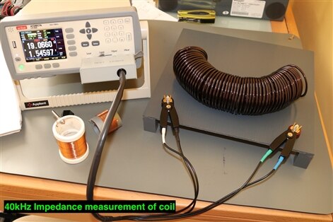

I have collected some impedance data for each of the coils I have wound using an LCR meter.
The data shows the increasing impedance of the coil as the frequency is increased. This may give issues with being able to reach the full output current using the existing amplifier design.
