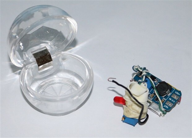

Before building this device I have tried lots of different design but in every circuit there were some issues, either it was also a metal detector or detect human as AC voltage source. I even built a device using instrumentation amplifier, 2nd order band pass filter and ARM mcu to do all the math (FFT) So i can only detect AC voltage and no metal detection or human contact detection. After lot of trouble I was able to achieve this by using this very simple circuit.

Final Assembly:
After testing and concept verification its time to build a final easy to use device with battery and case.
{gallery} Easy Peasy Electricity Detector
IMAGE TITLE: Easy Peasy Non-Contact Electricity Detector (Not a Metal Detector) - Top View Before Final Assembly
IMAGE TITLE: Easy Peasy Non-Contact Electricity Detector (Not a Metal Detector) - Bottom View Before Final Assembly
IMAGE TITLE: Easy Peasy Non-Contact Electricity Detector (Not a Metal Detector) - After Final Assembly

    Hi Mahmood, I like your detector. I have a question though. Do you think you are detecting the magnetic field of the mains outlets or the electric field. I would vote for the electric field since there…

    mahmood.hassan over 7 years ago in reply to jw0752 +2
    It detect electric field only if its fairly close (high gain setting/bigger antenna) to a wire. (like in switch position detection video) In case of electric switch board it doesn't detect any thing unless…
    In case of electric switch board it doesn't detect any thing unless switch is on or its placed very close or antenna is big or gain is fairly high --> so this mean its detecting magnetic field (current is flowing).
    If I place my hand in between electric board and this module it stop detecting anything.
