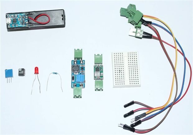

Components required:
Main components required to built this non contact AC voltage detector are;
  • AD620
  • LED with resistor, as an indicator
  • Multi-turn trim-pot for gain adjustment

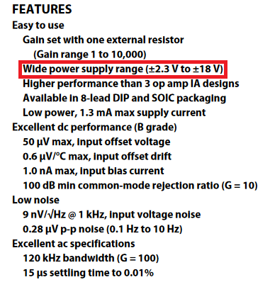

  • ±3V supply or 6V&3V supplies
In this project ±3V is also a good option to provide power supply this module (only two 3V coin cells).

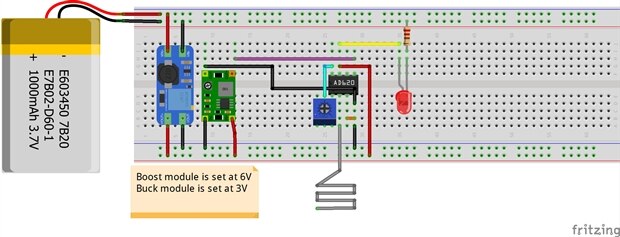

Schematics:
In this project AD620 is configured to work with single supply (figure 34. on page 14 of datasheet) instead of dual power supply.

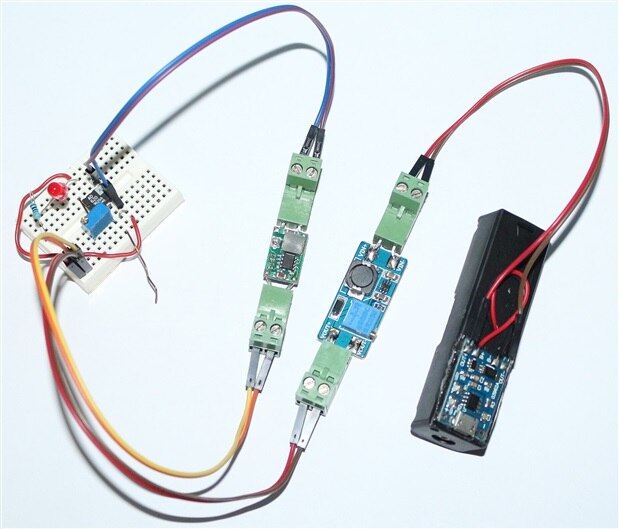

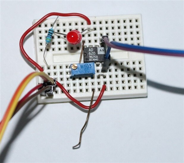

Prototype:
Simply make the breadboard circuit as shown in above figure and our first prototype is ready. Here I have used 50k trim-pot and there is ~26kohm gain resistance value.

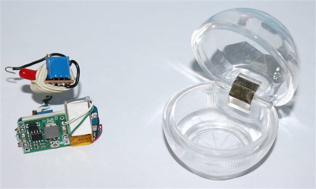

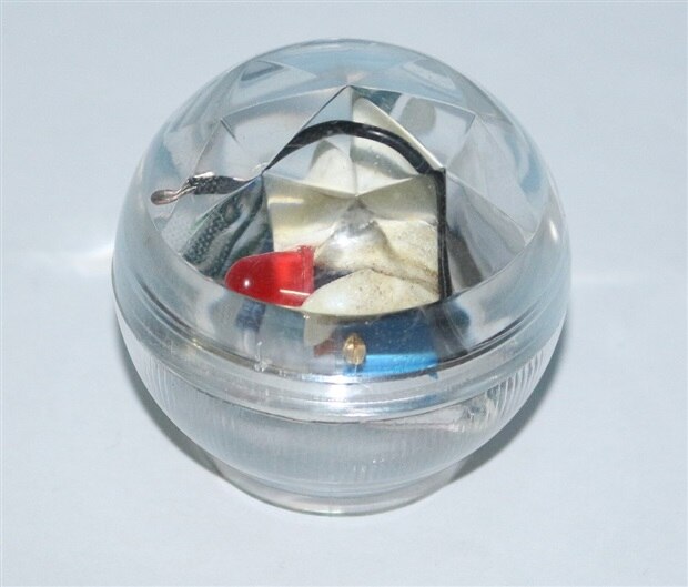

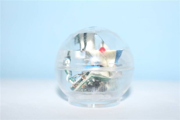

Final Assembly:
After testing and concept verification its time to build a final easy to use device with battery and case.
{gallery} Easy Peasy Electricity Detector

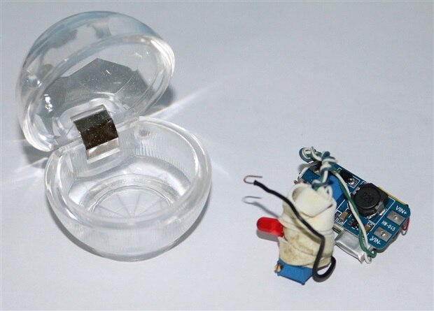

IMAGE TITLE: Easy Peasy Non-Contact Electricity Detector (Not a Metal Detector) - Top View Before Final Assembly
IMAGE TITLE: Easy Peasy Non-Contact Electricity Detector (Not a Metal Detector) - Bottom View Before Final Assembly

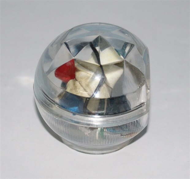

IMAGE TITLE: Easy Peasy Non-Contact Electricity Detector (Not a Metal Detector) - After Final Assembly

  • beacon_dave
    beacon_dave over 2 years ago in reply to jhonzambrano
    I think there is an error in the top breadboard diagram.
    The LED should be wired to output pin 6 not the power rail pin 7
  • jhonzambrano
    jhonzambrano over 2 years ago
    Hi, I have assembly this circuit on breadboard but it does not work , the led is always On? could you please help me to debug to find the issue ?
