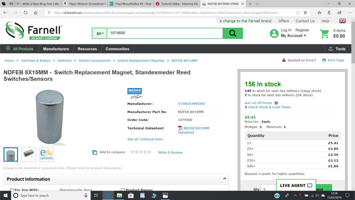

I already had some magnets that I thought might be suitable as they are cylindrical. Also amazingly, Farnell still sell them, which surprised me as I purchased them many years ago. I'm not sure what sort of magnetic strength you need for electric guitar pickups (or - to be honest - whether they actually use magnets or electromagnets) so hopefully these will be OK.
