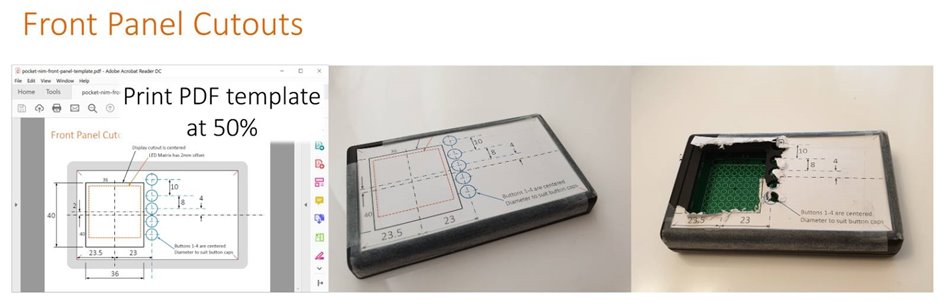

To help with cutting the front of the case, a PDF file is attached to this blog post that can be used as a template. The file is to double scale, so it needs to be printed at 50%.  A 3D printed case might be another option.

The PDF file attached to this blog post was used to cut the holes.
The power switch location needs some filing to make a notch. The display cut-out had a 1.5mm thick piece of translucent plastic fitted flush (anything thicker will not leave enough space for the LED matrix, because it is quite tall).
Matching caps for the push-switches were hard to find. Depending on what you use, the caps may need gluing. Also, check the height using the enclosure. If the buttons need raising, one way is shown in the photo below.
