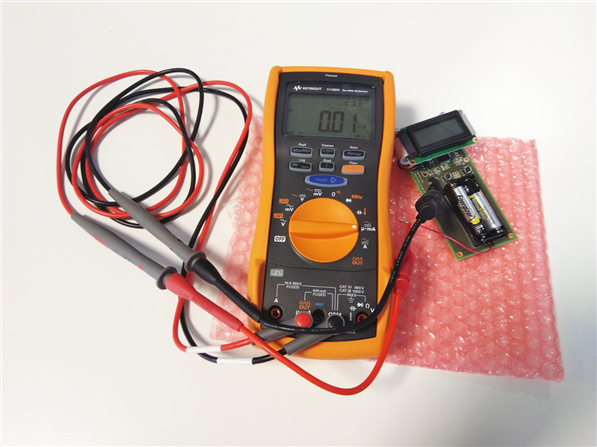

Keysight U1828A multi-meter
https://www.newark.com/keysight-technologies/u1282a/digital-multimeter-handheld-4/dp/58Y5948
Multi-meter is set to auto-range (the thermometer won’t turn on if set to the lowest range manually), the lowest range is 600 uA. The picture below shows 0.01 uA = 10 nA . We are on the edge of precision that can be displayed. In addition to that, the accuracy of this meter is 0.05 % + 5 cnts , which is 0.0005 * 600 uA + 50 nA = 350 nA.
Here is a live video showing the measurement. The auto-ranging takes a while, so I take multiple measurements in order to get the result in both run and stop modes.

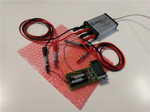

Joulescope
Joulescope is a $800 device (low cost, compared to what comes next) for energy profiling. It was originally funded on Kickstarter, but is currently commonly sold. If you want to know more about it, here is a link to the website: https://www.joulescope.com/
I hope you don't mind if I just copy a few numbers from the specification https://www.joulescope.com/specs/
  • -1V to 15V voltage range
  • -1A to 3A current range, continuous
  • Up to 10A pulses (<10 ms, < 3A average per second)
  • Down to 1.5 nA resolution, equivalent to 32-bits of dynamic range
  • Synchronously measures voltage and current at 2 million samples per second, 14-bit
  • 250 kHz bandwidth
  • Rapid 1 μs switching between shunt resistors for seamless dynamic current measurement

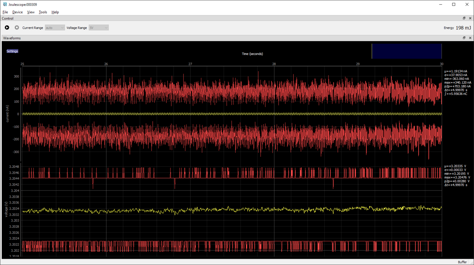

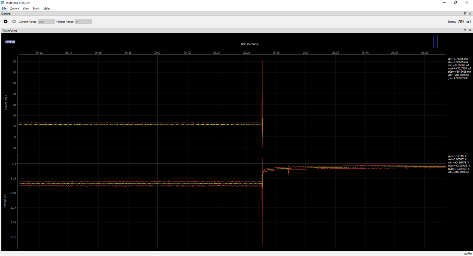

First, the Joulescope multi-meter mode. It provides live view and has the ability to average values over time. I captured almost 20 seconds in the MCU stop mode.
At the lowest 18 uA range, it has a resolution of 1.5 nA (but for some reason adds one more fake digit) and accuracy of 0.25% + 30 nA = 0.0025 * 18 uA + 30 nA = 75 nA
It looks like the current was more flowing from the thermometer to the battery than the supposed way. Again, we are at the edge with accuracy.
Next, a scope view (yellow line shows the average value):

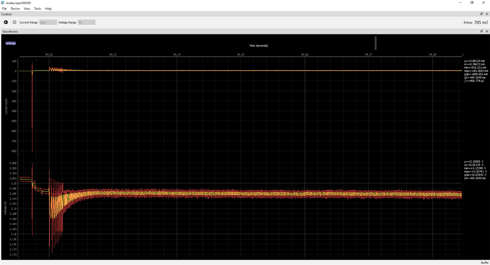

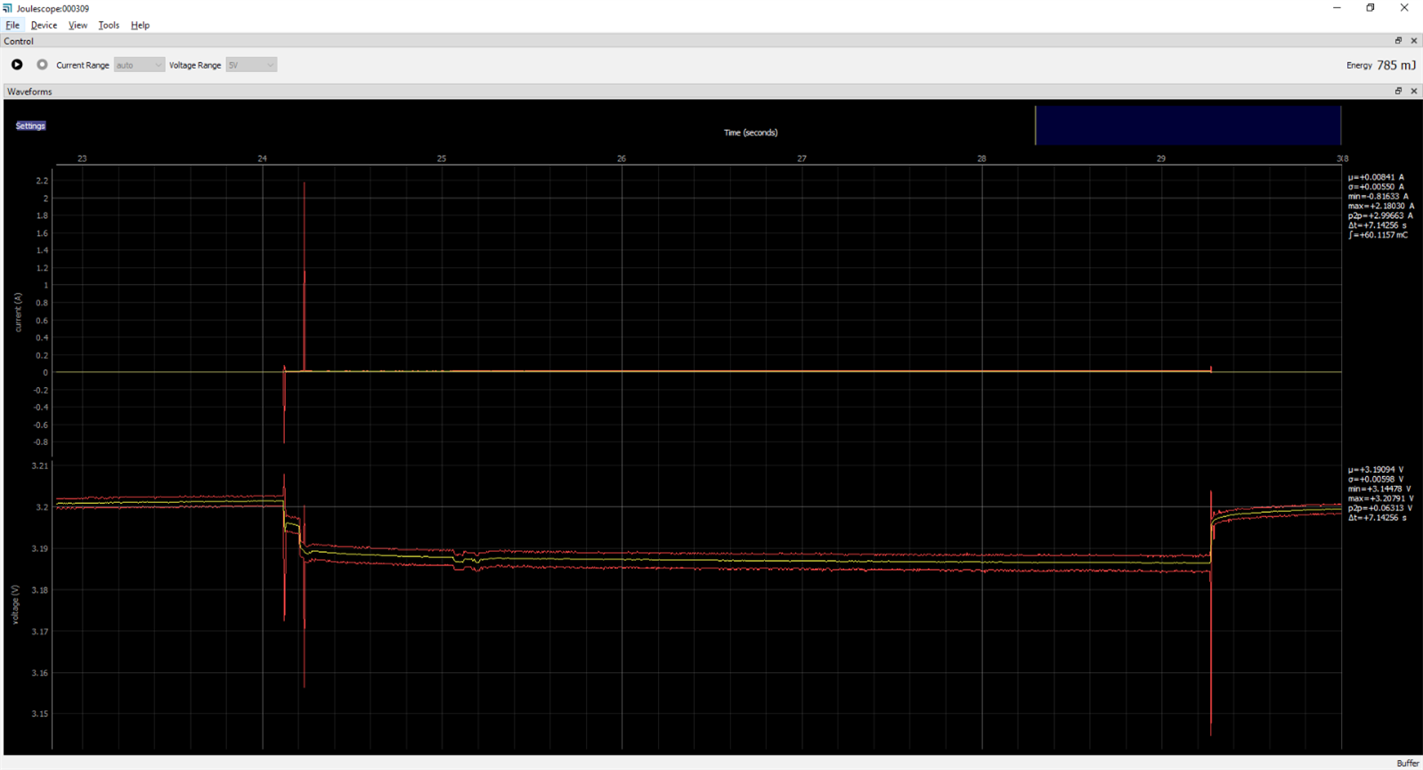

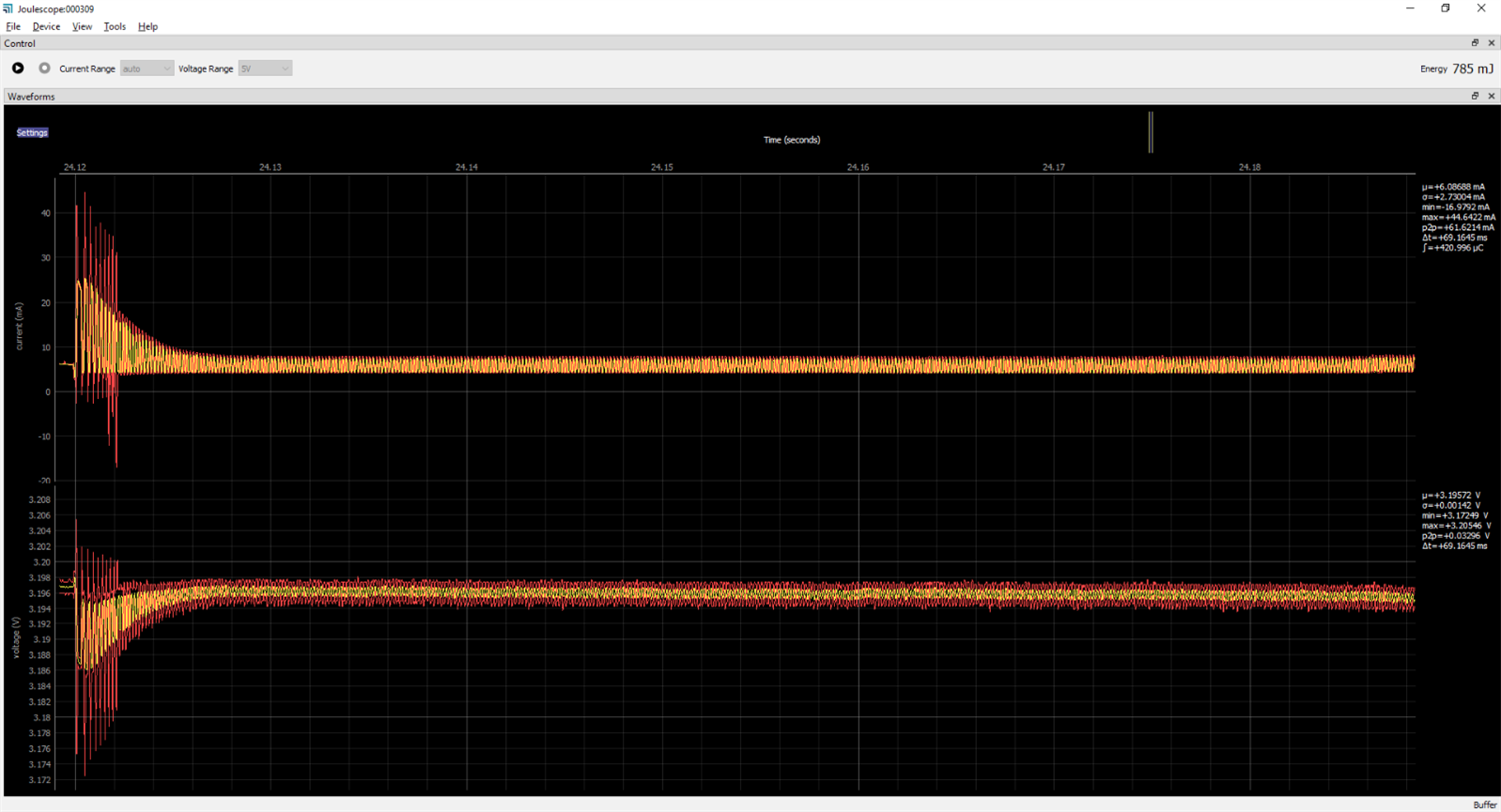

Then I tried the scope view and captured one temperature measurement. Waking up from the stop mode, measuring and displaying the temperature and going back to the stop mode. The scaling in GUI is automatic, which means I had to zoom to specific time in order to get a better picture of the signal. The dynamics of the current makes it sometimes hard to see the details.
Full measurement view
There is no way to differentiate between an active and stop mode, however, there are noticeable spikes when the MCU comes to live (ca. 2 Amps) and later when everything is shut down (ca. 200 mA).

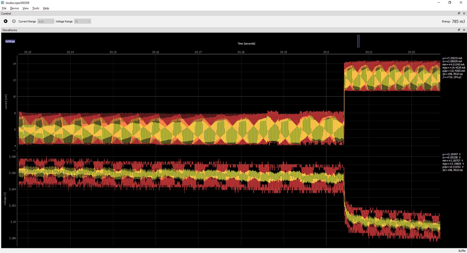

MCU start
Run mode
Ca. 10 mA current consumption.

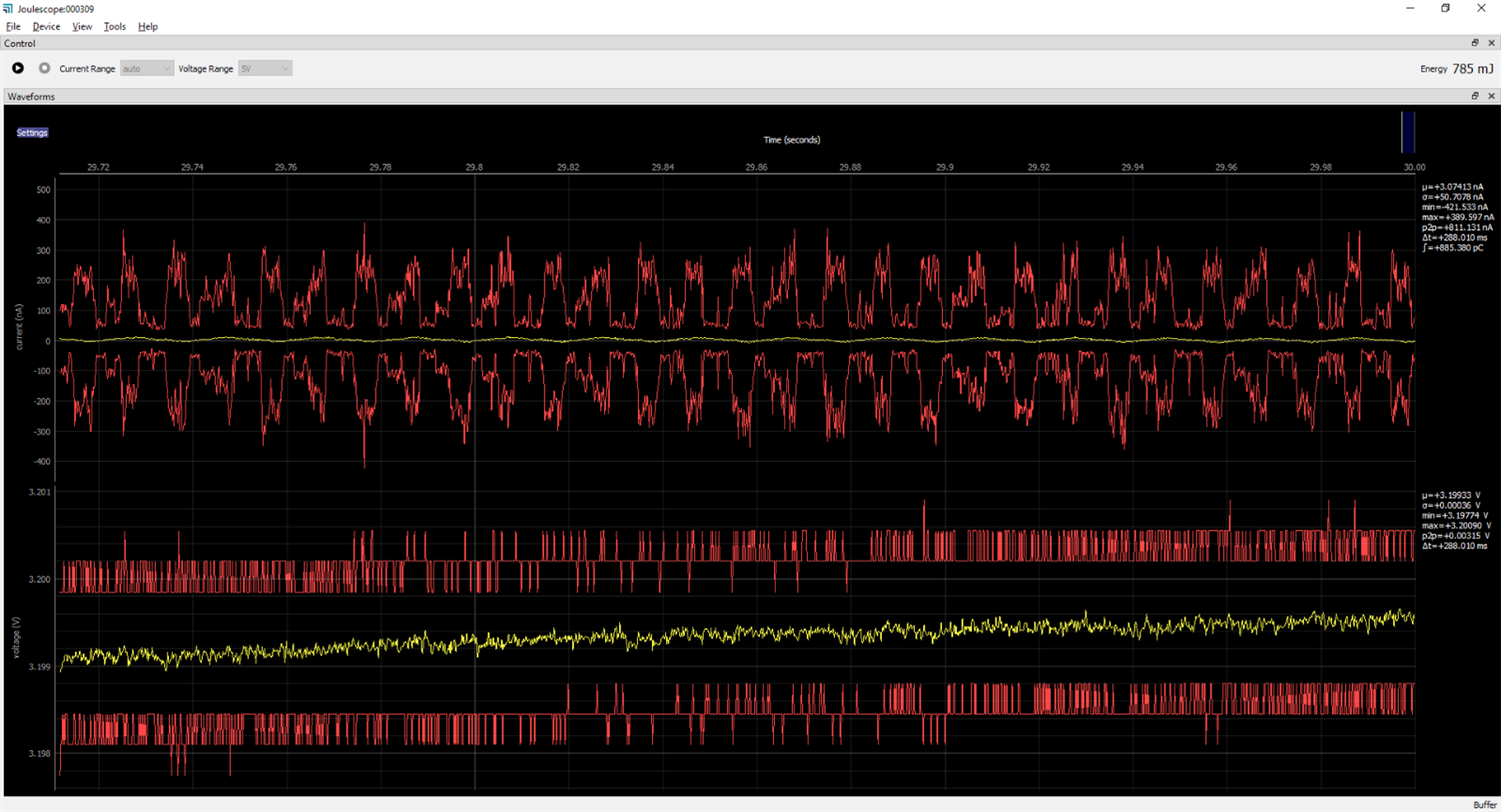

MCU and components shut down
Detail of the stop mode
Looks a bit different than the stop mode graph above.

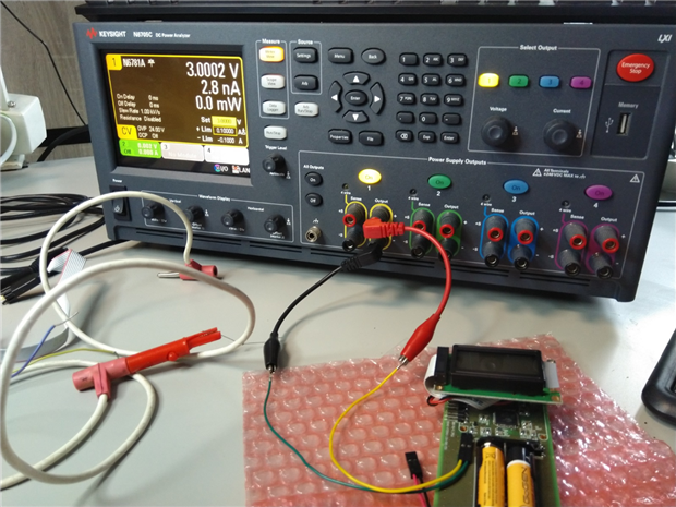

Keysight N6705CN6705C power supply with N6781AN6781A unit
This device is a beast. Bench power supply with many power modules options. $8000 chassis with a $6400 module inside. https://www.newark.com/keysight-technologies/n6705c/dc-power-analyzer-current-pow/dp/02AC5191 , https://www.newark.com/keysight-technologies/n6781a/source-measure-unit-for-battery/dp/79R9083
(No, I don’t have this at home image )
Lowest power range of the optional N6781AN6781A unit is 10 uA. Accuracy is 0.025% + 8 nA = 0.00025 * 10 uA + 8 nA = 10.5 nA
However, the device display doesn’t seem to show what I was expecting.

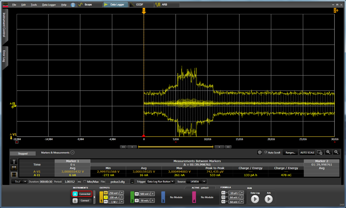

Let’s see what the data logger mode shows. This requires a PC with software connected to the power supply. The graph resolution is 100 nA per division, the average line is obviously the one in the center. You can see a 30 s recording. The disturbance in the first 12 seconds was simply to illustrate what happens when touching the wires. The capacity of hands is enough to provide some current. If you look at the Avg column (not the Marker 1), you can see an average of 16 nA.
