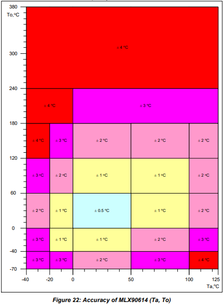

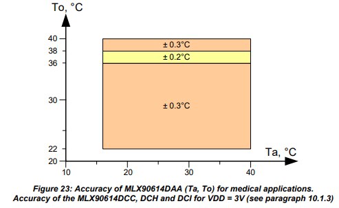

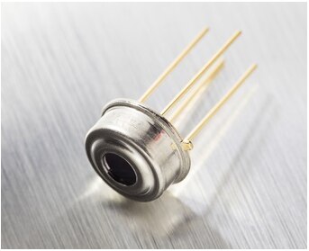

The key component for the thermometer is obviously the IR sensor. I stumbled upon MLX90614 from Melexis and ordered one. It is a factory calibrated sensor that can measure both sensor (ambient) temperature: -40 to +125 Centigrade and object temperature using an IR sensitive thermopile detector chip: -70 to +380 Centigrade, with resolution of 0,02 Centigrade. Specifically, I chose MLX90614ESF-DCC-000, which is a recommended part for medical applications. This simply means an improved accuracy in the range of 16 to 40 Centigrade. The following pictures are extracted from the datasheet:

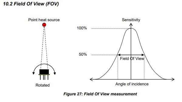

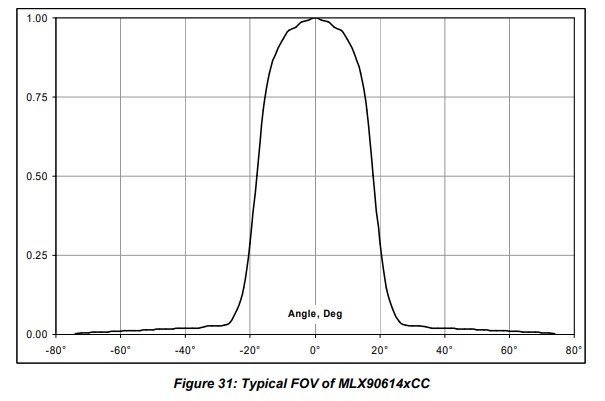

It is also important to mention a field of view (FOV), which is 35° for my part number (the cheapest variants have 90°) and therefore distance to spot ratio of 1:1 (the maximum you can get is ca. 2:1 to 2.5:1 with DCI variant, featuring a FOV of only 5°).
The sensor can tell the object temperature over SMBus or measuring the PWM duty cycle. I chose the SMBus, because PWM requires accurate measurement using timers etc.

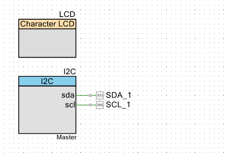

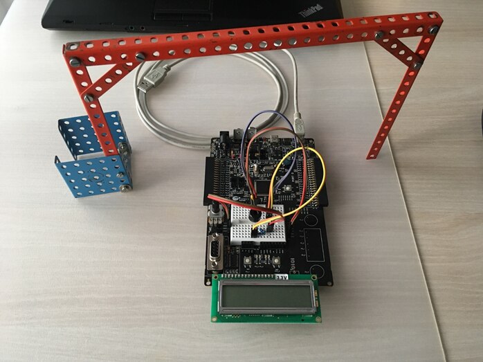

I knew I need to measure and display ambient and object temperature, so I grabbed a PSoC5LP kit without much thinking. It features a prototyping area, LCD and possibility to run on 3.3 V (including the LCD).
HW schematics in PSoC Creator was simple:

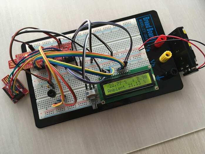

And a prototype:
(Note: the metal built gate is not relevant to this project.)

The first thing to learn was how to handle an SMBus sensor. It is not complicated, but what helped a lot was an application note from Maxim, mentioning the key differences between I2C and SMBus. The good thing is that I2C microcontroller peripheral can be used. However, there is a timeout between commands, which means you can’t debug the bus between request and response commands, just after a complete transmission. My favourite way of starting with sensors is connecting them to a logic analyzer and sending one command at a time. This is perfectly OK with I2C sensors, but not with SMBus.
Also, there is an SMBus speciality called Packet Error Check (PEC), which is an CRC-8 attached to every command and read data. I found tones of code from various developers online, but most of the people working with SMBus sensors only read the data, thus ignoring the PEC. Only people who need to write some data (configuration etc.) need to learn how to implement the CRC-8 generator. I even found some examples using fixed CRCs calculated for some specific commands. One of my future goals is to change the sensor emissivity on the fly, which requires actual calculation in program code. I found great help in TI’s application note for a completely different processor, but with code usable after a few adjustments for my purposes. In addition to that, I have to recommend reading a Painless guide to CRC error detection algorithms by Ross N. Williams. Written 25 years ago, but still valid and super useful.
After getting the correct data from the sensor, I realized PSoC 5 is an overkill. So instead of a $20 microcontroller, I chose a $4 PSoC 4, that is available on the cheapest PSoC 4 kit (also $4): http://www.cypress.com/documentation/development-kitsboards/psoc-4-cy8ckit-049-4xxx-prototyping-kits This kit doesn’t have an onboard debugger, only an USB to UART/I2C/custom converter, but this issue can be resolved using a $10 kit with KitProg2. One modification (removing a diode) is needed on the programmer, so the USB doesn’t fry the 3,3 V sensor.

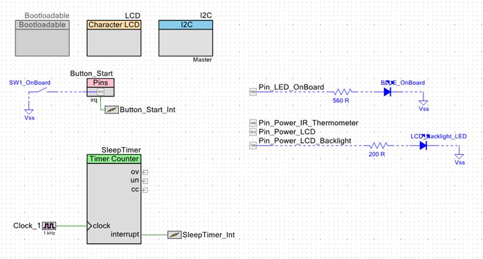

More features were added to the second prototype: backlit LCD, state machine code with a timer used to let the microcontroller sleep after a measurement and emissivity was displayed on the LCD. The design was made with low power in mind and the requirement was to completely switch off parts of the circuit that are not in use. This resulted in powering everything through GPIO pins: LCD, LCD backlight and the IR thermometer sensor.
HW schematics in PSoC Creator:
